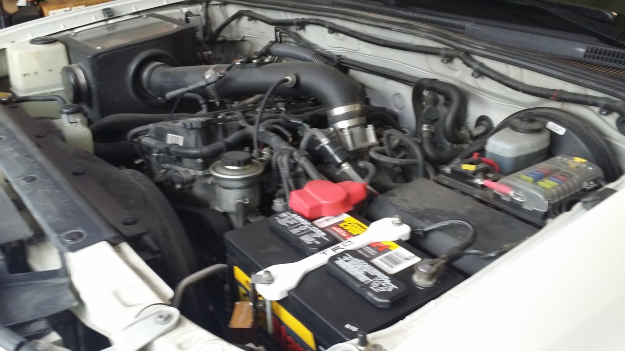

    I have never had any issue related to intake or filtering using a K&N on anything.......that being said, I prefer and have aFe dry flo S on the truck because it gets washed, dried & put back in the enclosed Volant filter box it lives in. No need for oiling. I run the K&N tube from TB because it has all the mounting points for doodads that came off oem intake as well as a support towards the end to hold up filter, connected to Volant filter box with clear lid that breathes thru oem fenderwell opening and oem baffle inside fender with the aFe filter.......I dubbed it KVA intake - best parts of 3 different intakes.

    What does all that nonsense do for the truck?

    Not much.

    It is cleaner looking with less clutter underhood, never have to buy another air filter, can see when it needs cleaning while enclosed away from underhood temps, breathes thru same opening as oem, no accordion shaped rubber hose to fail from age like oem, allows access to coils/plugs without removing intake, isn't noisy and most importantly, fulfills what I wanted to have there....................it does enough for me to have taken the time to do it that way.

    Stock air box gets the same cold air too and is encased. Like I said, doesn't do anything more than stock really but if it works for you then that's all you need. :thumbsup:

    I know what stock is...........here, maybe you missed an earlier post I made................see bolded below.
    " Also delusional to think any performance gain is to be had. All they are is reuseable. Either keep chasing and buying one every time it's dirty or buy one filter, wash it and recharge it properly (if oiled version) and not buy any more."
    The only claims I make vs oem is not having to run to store to get a new filter when dirty, liking the way it looks vs. oem, being able to see if filter is dirty without taking anything apart and not having to remove intake to deal with plugs or coils. That is what works for me. :thumbsup:
