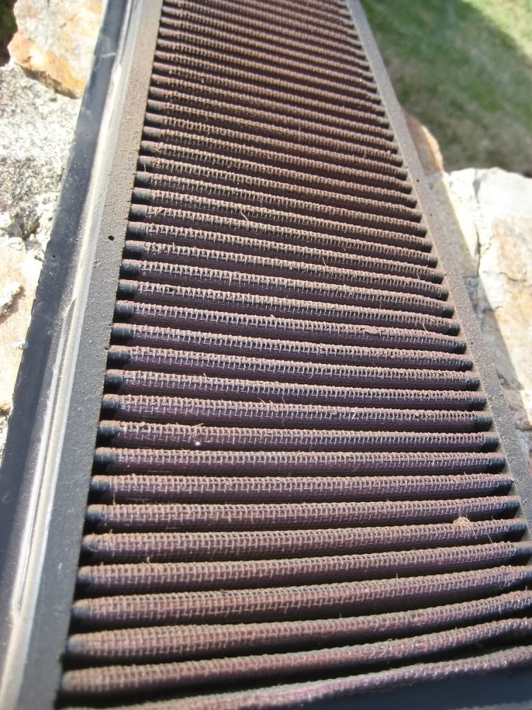

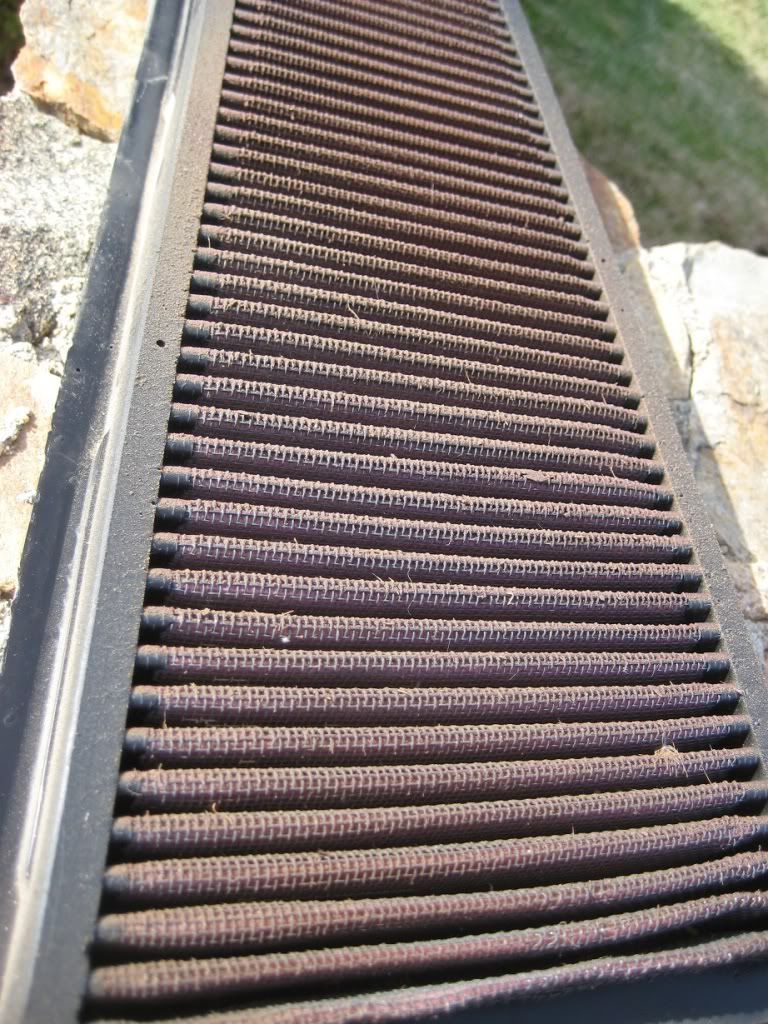

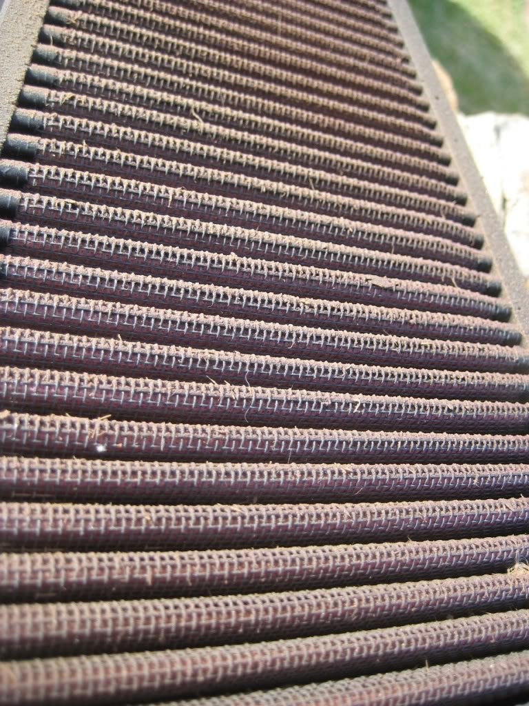

    Reasons to buy a K&N
    After two days in Ocotillo Wells eating dust:

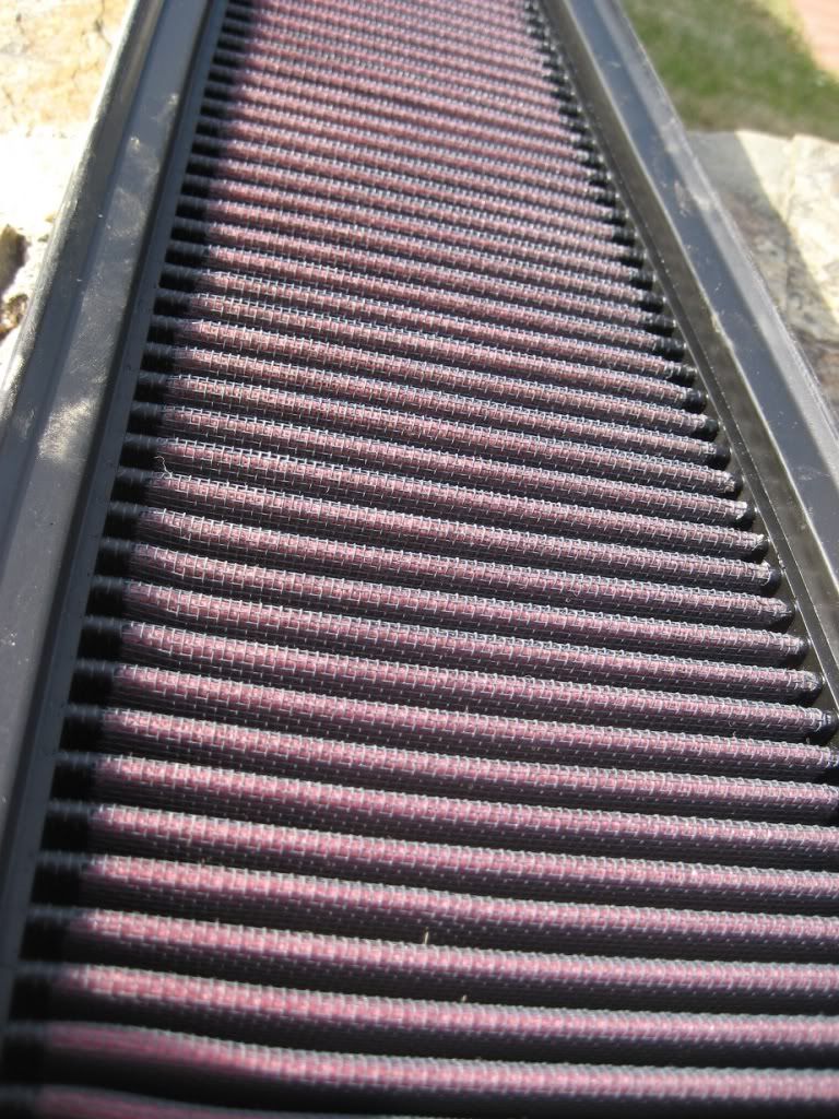

    Other side facing the throttle body (Before Cleaning):

    that some big filter pics:)

    AFEs will let dirt into the engine. I've seen it with my own eyes. One good day in the desert and the inside of the filter looks just as bad as the outside. No bueno for your engine.

    No worse than a K&N. All the oil samples I have donme with a K&N filter installed, have come back with the silica levels maxed. THATS no bueno for an engine.

    Silica = Dirt. The K&N air filter oil doesnt catch all of it. In fact, if you run it long enough, you'll see dirt start to build up behind the filter, in the intake tract. no filter will give more hp than maybe 2, over the stock air filter. If you want best filtration, run an OEM filter. If you want 1 or 2 more hp., run a higher flow filter.
