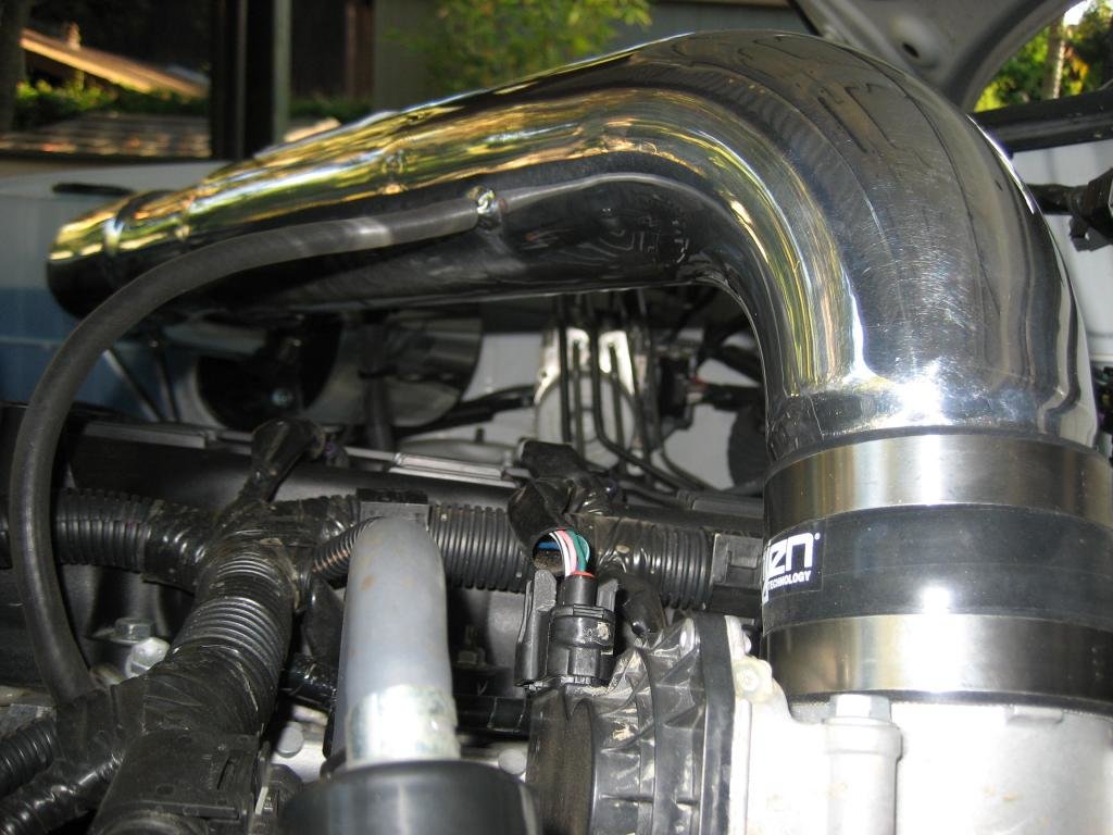

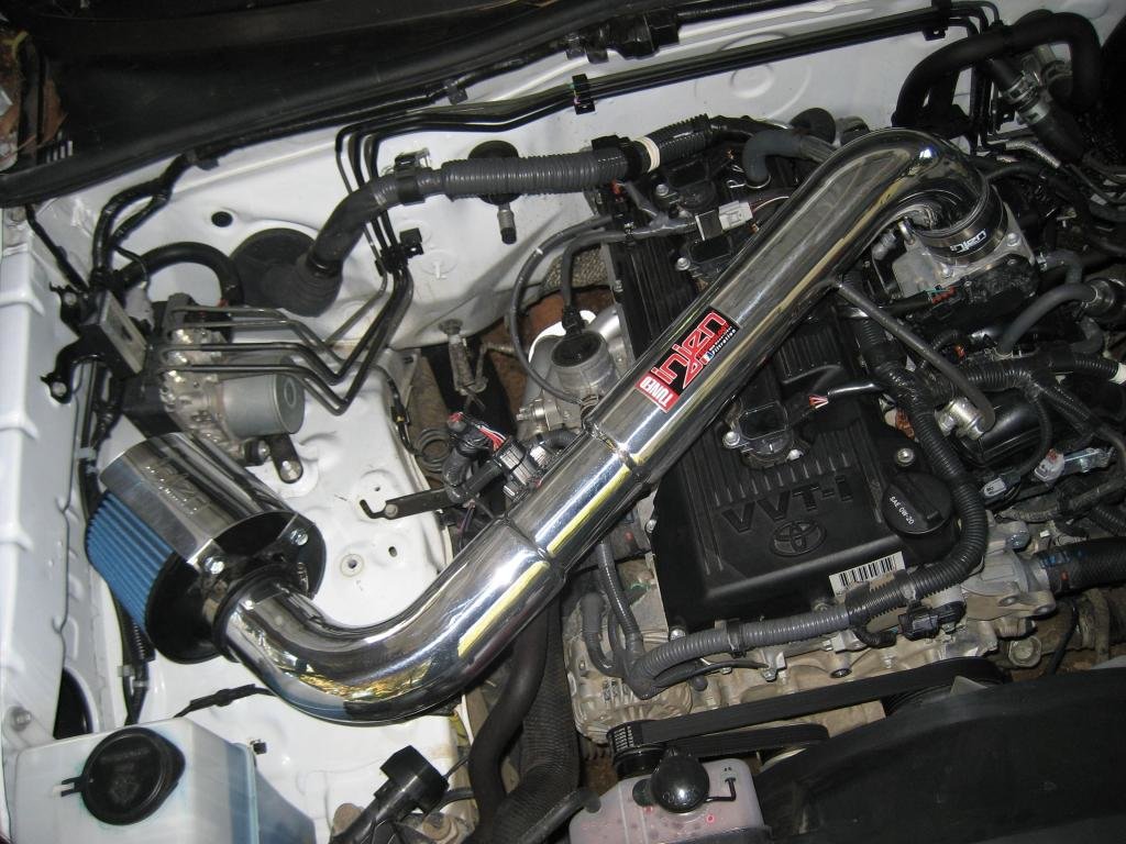

    I don't think that my Injen intake helped my engine either as the A/F on the dyno runs was really lean. When I removed the stock intake I took some careful measurements and found that the inside diameter of the throttle body bore is exactly 61mm, and the inside diameter of the intake air horn at the other end in the fender well is also exactly 61mm. This 1 to 1 relationship of the intake's entry to throttle body bore must be critical for the ECU to meter a good A/F ratio under full throttle conditions.
    So I'm going to make a 61mm inside diameter ring and insert it right at the mouth of the Injen intake to restrict the opening enough to richen up the mixture at wide open throttle. :thumbsup:

    I understand what you're saying, as all of aftermarket intakes are restricted in exactly the same way by the required diameter of the MAF sensor.
    My Injen uses oversized tubing and necks down to the proper size right at the MAF sensor...
    then returns to the larger diameter until it necks down again right at the throttle body...
    However the intake diameter at the air filter end of the tube is quite a bit larger than the stock intake which makes the Injen intake overall less restrictive at wide open throttle. Here's the dyno run A/F chart. In both runs I used exactly the same intake, and as you can see, they're both running way lean.
    So I'm going to reduce the opening at the air filter to match the bore of the throttle body exactly like the air horn on the stock intake.

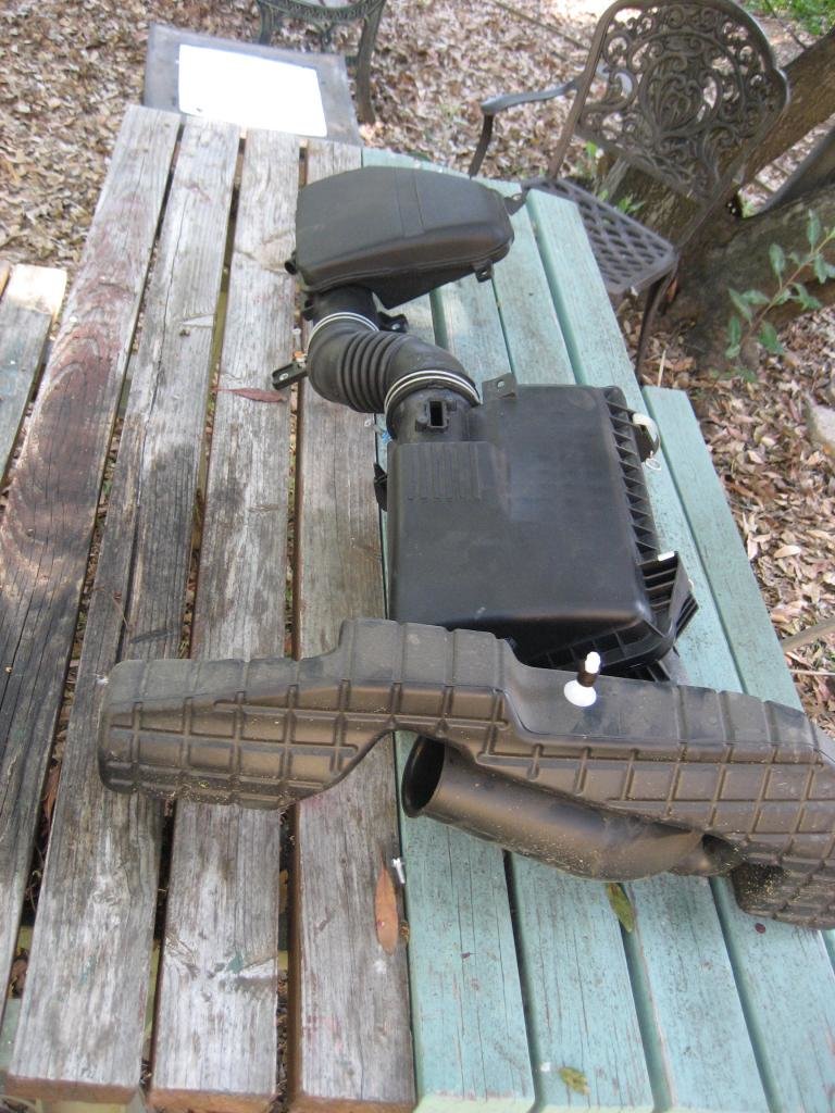

    Which causes an increase in velocity at the MAF and TB, but the total volume remains unchanged.
    Restricting the tubing at the filter will simply place another velocity change into the system, but will not improve flow.
    If this were a carb'd system and the velocity changes were post-carb, this would be a bad thing because the fuel would drop out of suspension when the tubing flared out beyond the MAF and the velocity dropped.
    In this case, the velocity at the MAF and the velocity through the TB are identical, whether the tubing ahead of the MAF and behind the MAF is 61mm or 610mm. The expanded tubing provides a bit of a buffer... almost acting as a capacitor, so the MAF does not "see" small fluctuations in flow at the TB... enlarging the tubing between the MAF and TB would increase that effect... I'd say with a 70mm tube you'd start seeing some serious mixture issues caused by the capacitive lag between the TB and MAF.
    Adding a restriction ahead of the MAF will only serve to increase the overall restriction of the intake.
    The multiple bends and chambers in the stock snorkel, the ridges in the flexible coupling, and the intersection in the stock resonator chamber introduce more restriction via turbulence than the stock 61mm snorkel inlet diameter.

    Isn't the stock intake considered a cold air intake? It draws from the right fender well outside of the engine bay, which is cold air.
