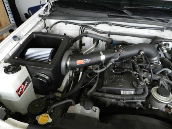

    K&N intake tube, Volant box, aFe dry-flo filter & oem wheel well baffle. There, some of everything..........minus any oiling.

    That's a nice looking setup right there. :cool:

    Thanks. Added the ram air to it the other day..............clear lid for filter box is next.

    :eek: Looks great! That's a serious air setup! How does it sound??
    Going with the full CAI short ram would be a diminishing return over just dropping in a Pro Dry methinks...

    I didn't care for the open filter in the bay like the K&N setup is. Soaked up heat even with the divider wall and also soaked up moisture enough to bog the truck on frwy in hard rain. The sound is noticeable with header and intake but is different and not brappy with filter enclosed in the box like it was when open. Other than the enclosed kind of setup, just the pro dry s drop-in in the oem box is next best IMO.

    Great. Thanks for the feedback. I can def see where you're coming from not wanting the filter out in the open like that. Wish they made a fender mount like I had on my old Foxbody mustang. What's your total bill for a setup like this if you don't mind me asking? Seems like a ram air and closed off box like you have is probably the best setup you can run. I'd like something like that also with some LCE headers. Do you see any real loss of performance or need for a retune? Running lean at all?

    No loss of performance and doesn't seem to be lean but don't have an afr hooked up to it. I do have the URD MAF calibrator and an innovate LC-1 wbo2 with gauge but haven't hooked it up yet. May complete setup with aeroturbine 2525xl muffler/resonator before going to tuning. I have the bluetooth elm 327 and torque app on my droid phone but haven't spent much time playing around or monitoring long term fuel trims yet....need to tho.
