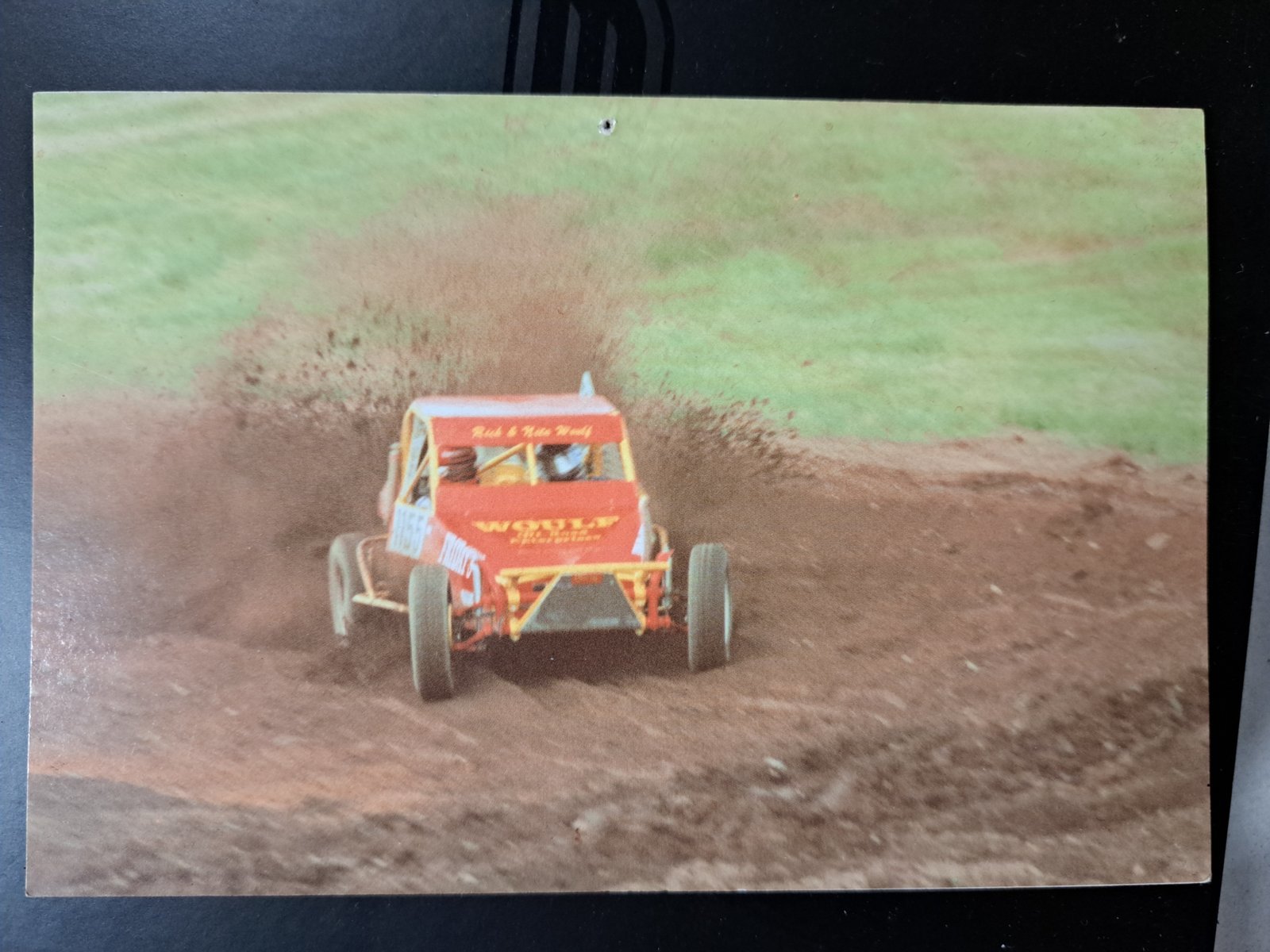

    Yup, useless in dirty/dusty conditions. Have used K&N for years and years. Have never found dust in my intakes, nor excess oil. If washed properly, they won't break down either. BTW, I raced offroad for almost 20 years. (Pic not me)
    edit: Personally, I don't care, you do you.
    This was me.

    What?! Not even some sliders on that bad boy?
    Disappointing.
