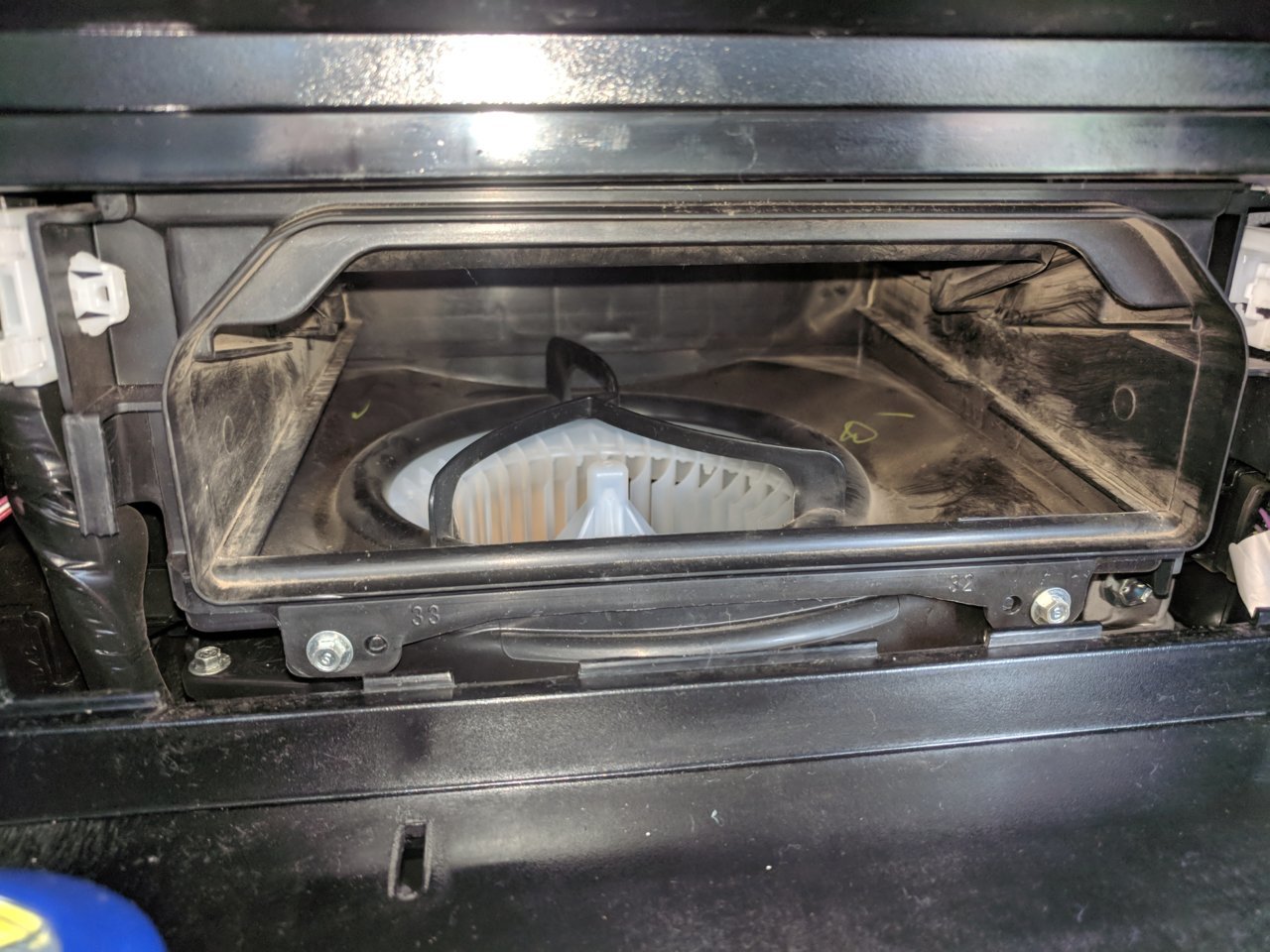

    Here is what I'm seeing:
    That's a bit too much bypass compared to other cabin filters that we've had.

    I run the K&N electrostatic cabin air filter. The fit is good and it isn't oiled. It has electrostatic recharge spray but is not same as red oil for eng air filters. Yeah, it has a smell but I like that fresh air smell it has for a few months. Have done factory and DIY washable too but staying with the K&N. The filter box for the 3rd gen looks different than the 2nd gen. 2nd gen has narrow slot just for filter to fit compared to that wide open looking pic above.

    I was asking if the K&N would fit and seal better. My pic is from the stock filter. It doesn't seem to seal well.

    After another dusty trip, I think I am going to order the K&N. Having the windows closed took care of 90% of the initial problem (duh!), but after every stop when I turned on the a/c and the fan up to cool things down a bit, I could see a blast of dust shoot out of the vents. After I got home, I found a similar amount of dust that got past the filter. I don't feel it is the filter media itself, but more that the dust gets by the unsealed edges.
    None of the other filters seam to have any edge sealing other than the K&N. Over the life of the truck, I might recoup the cost, but it is mostly about getting a better seal.
