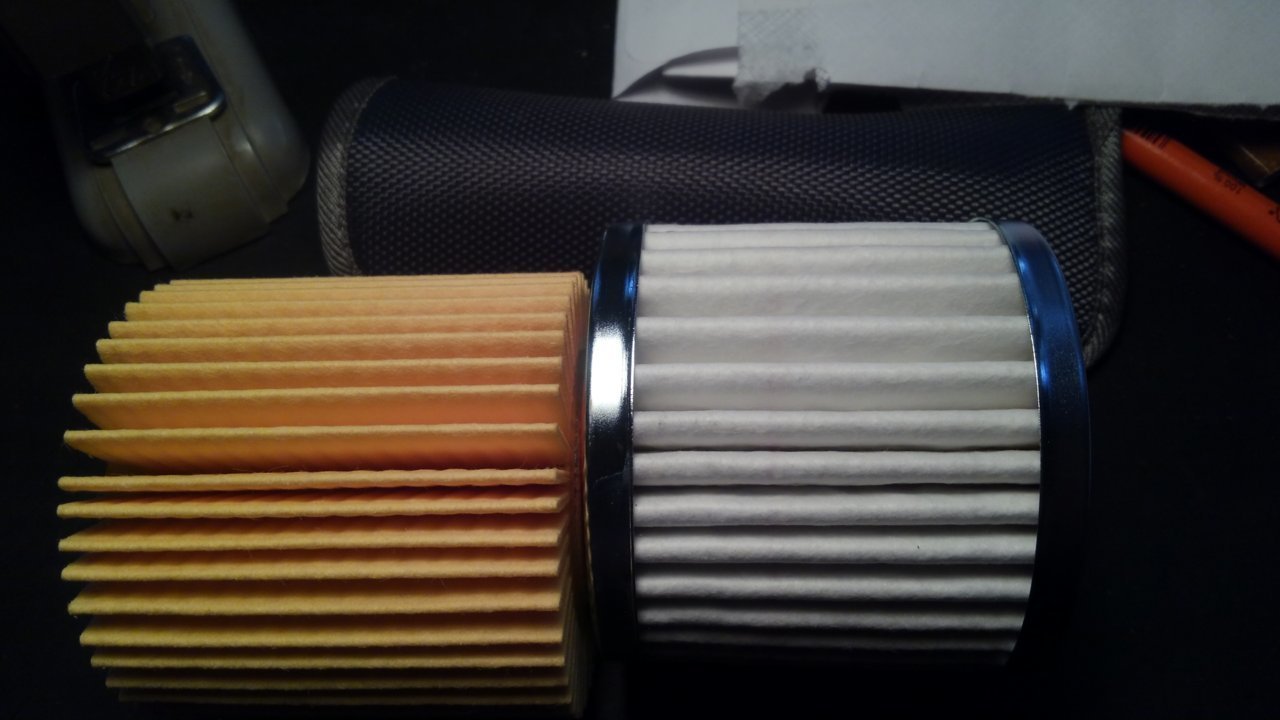

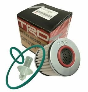

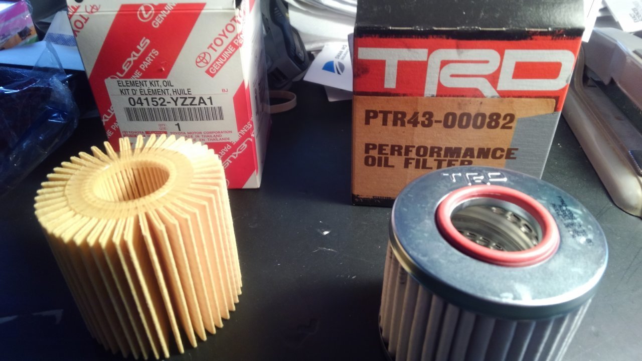

    PTR43-00082
    Here is the OEM & TRD side by side.

    My preference with the two examples from above would be the TRD one the right simply because the filtering media is synthetic versus the cellulose material for the left one.

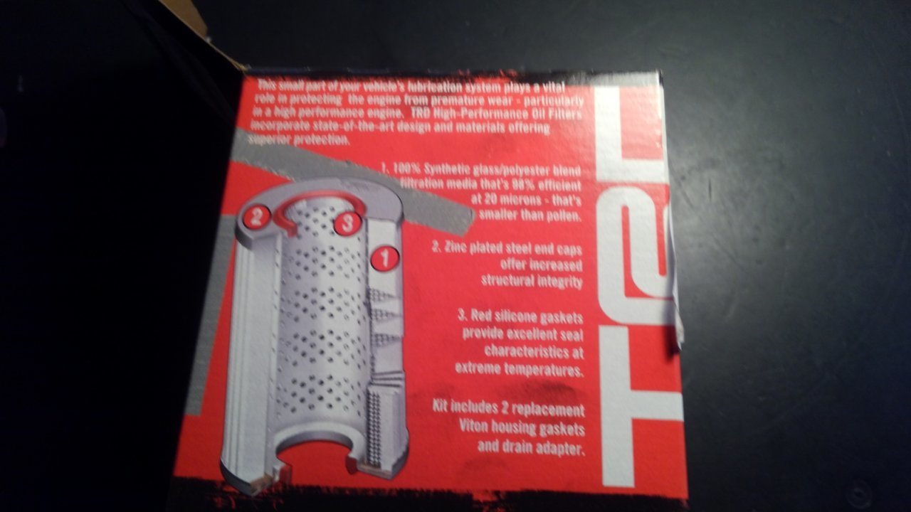

    Oil filters do use one of two types of media. Possibly one is better than the other. The upper filter in each manufacturer’s line uses synthetic while their less costly ones use cellulose.
