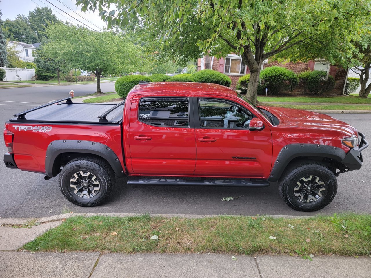

    I have the Retrax ONE XR as well. I really like it!. It is very strong and durable! It keeps people from messing with stuff in the bed. They just cut the soft covers in my area. Nevertheless, sounds like you have other issues to deal with.

    I don't have any water issues (Knock on wood) I didn't like the price for the Rhino Rack cross bars $$$ but they integrated nicely and I can mount my Thule carrier right on it.
    You made that rack!? You can start a business here!!! I'm sure anyone with a retrax rail system would be into that!
