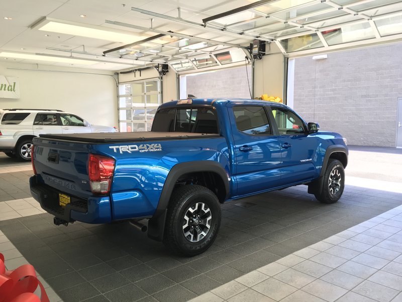

    Over the 4th of July weekend in 2016, I decided to drive up to Bend, OR and trade my 2015 WRX in for what I thought would be cheaper and more logical, a 2016 TRD Off Road w/6MT. I had the truck for about three weeks until I got word I was moving back to Oahu, which I wasn't terribly upset about (other than shipping costs for parts :bananadead:).

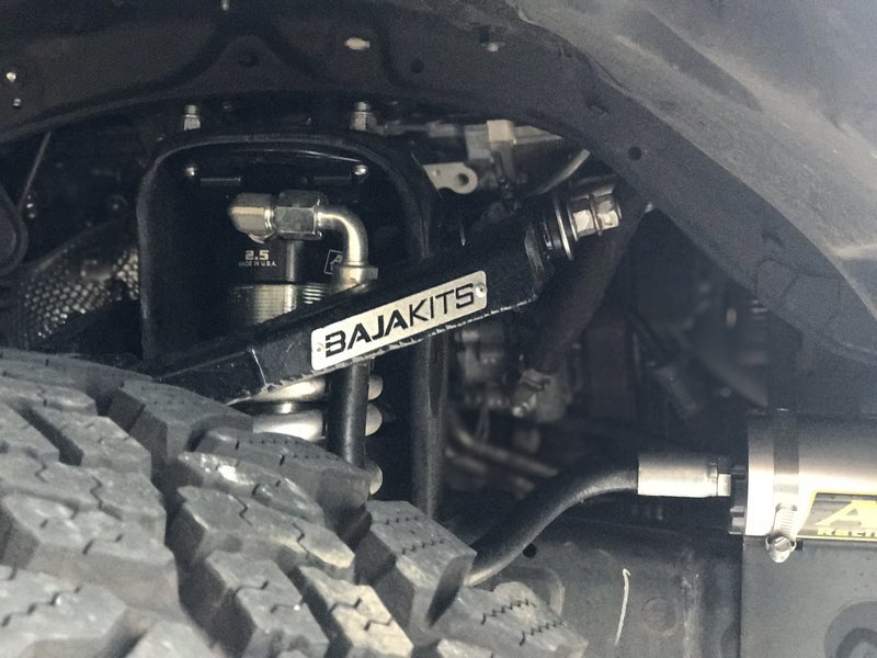

    Suspension
    • Bajakit UCA

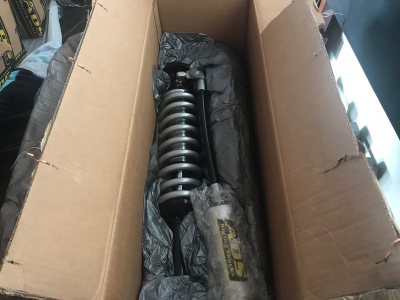

    • ADS 2.5" Extended Travel Coilover w/RR, 650#
    • ADS 2.5" Extended Length Rear Shocks w/Piggyback
    • AllPro Standard Leaf Pack
    • Timbren Bumpstops w/AllPro U Bolt Flip Kit

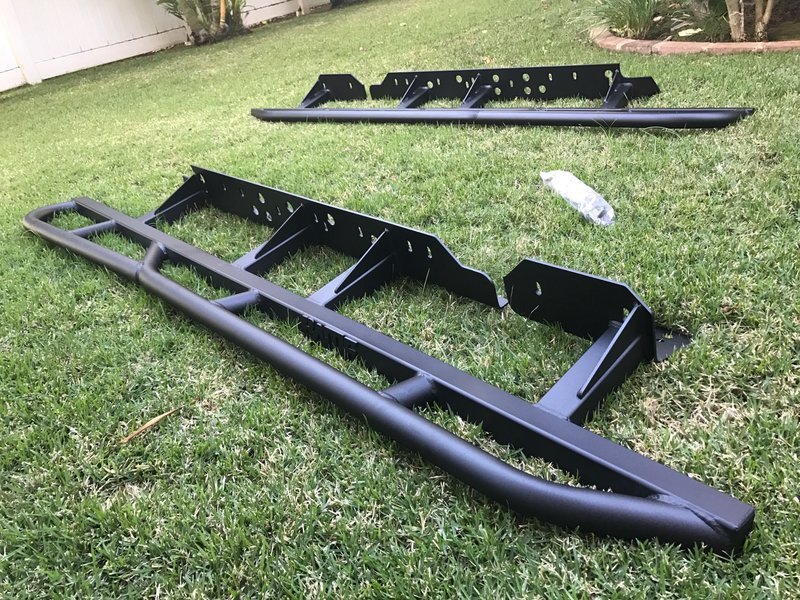

    Armor
    • BAMF Rock Sliders w/Kickout
    • Pelfreymarketed Front Bumper, Aluminum
    • CBI Full Overland Skids, Steel

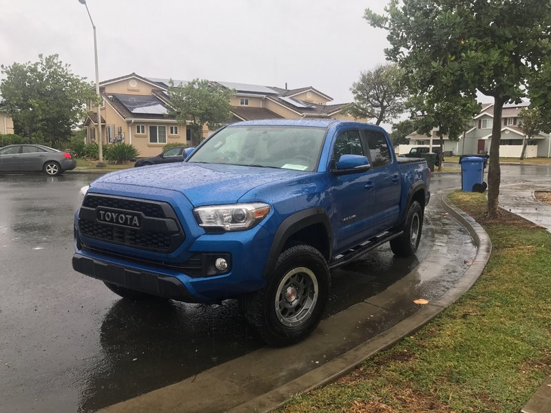

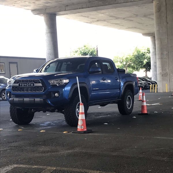

    Got a side pic on leveled ground, I'm thinking of getting that allpro standard leaf pack. I just want to see the stance

    Here's a pic of when I went in my for reconstructed safety inspection. I still need to do a pull off of my 5D.

    Man thats exactly what I want, what do you mean 5D?

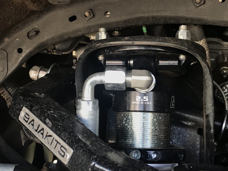

    Another question, are your coils cranked up all the way in the front?

    Driver side is first, passenger second.

    Thanks for helping me out, with the pics. Thats a lot of thread showing, makes me a little bit concerned for down travel.
    Ill be running kings which is almost the same as ADS, but I want to keep a good ratio between up travel and down travel, those leafs might just be right on par with my needs.

    I'll take measurements of threads showing when I get home, but I've seen way worse. I could have gotten 700# springs, but that would have been overkill unless I had major weight added up front.
    @HeadStrong Off-Road , opinions?
