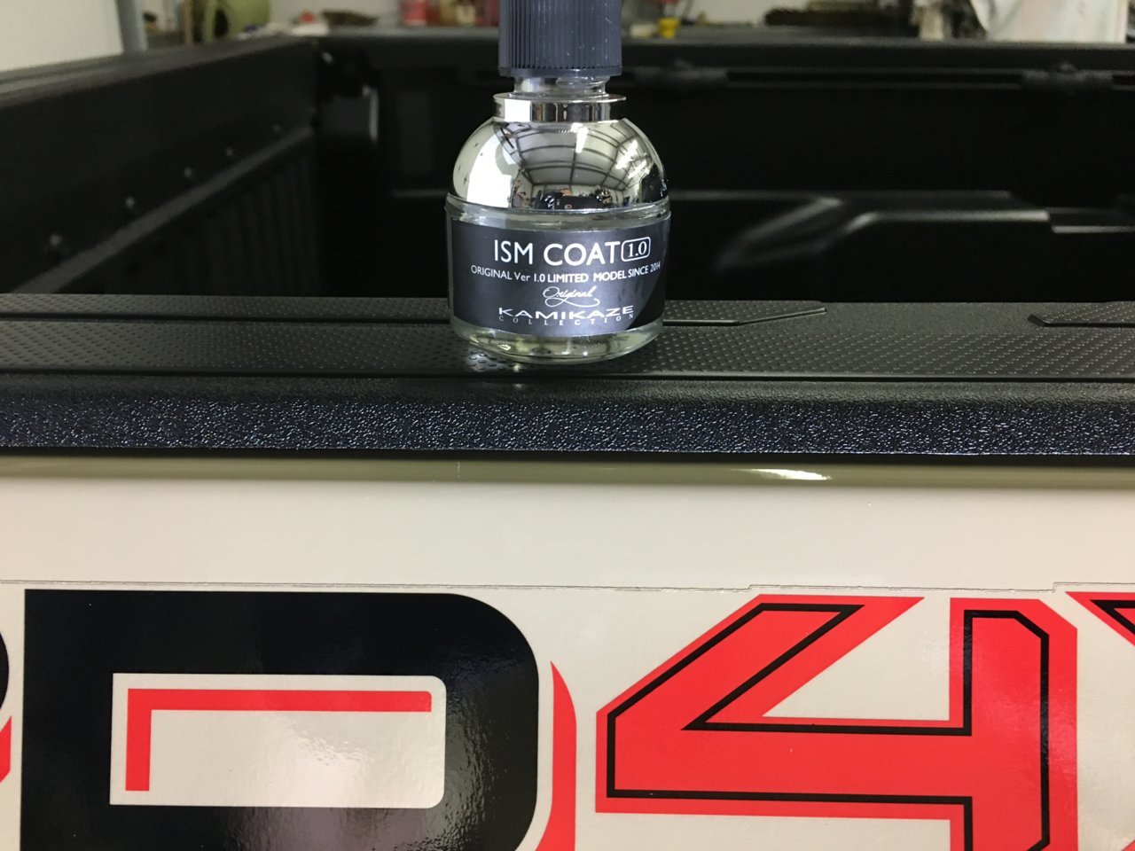

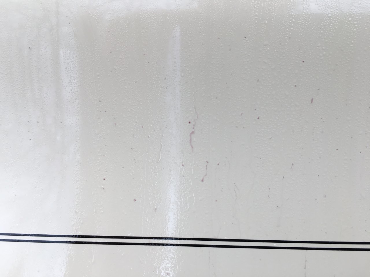

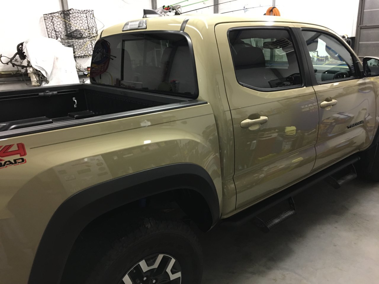

    I have used Carpro products with good results, but Kamikaze ISM is a superior product.
    I first decon the Tacoma after washing with trix iron and tar remover, the purple is the iron deposits. I then used the speed clay 2.0 from Mothers, did paint correction with Sonax perfect finish, wiped down with Carpro eraser. I installed the ISM coat and did all the black trim, it turned out great.
    5628C01F-ECFC-47AC-8A65-864E060FF93B.jpg 36672EC8-4FA5-4CA9-AE17-905D8C851468.jpg C8B0C5A0-F6EE-4CFE-A3E3-4502D460816A.jpg

    You truck looks great, but I have a question. What makes this product "superior" to others?
