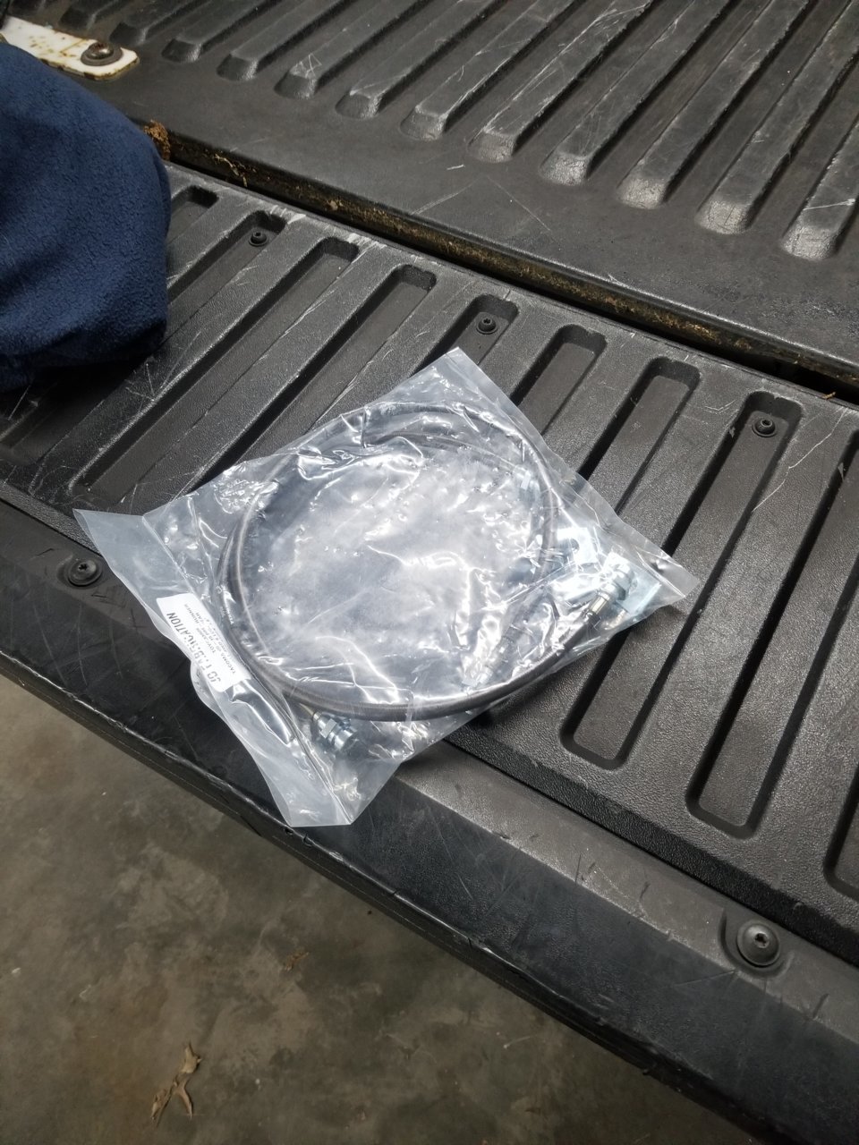

    I think having my LT kit sitting in my living room is making the day go by slower. I plan to back the truck into the garage and swap to my extended brake lines out of the rain. Hoping to get the rest knocked out before Monday.

    Well, its gonna be a big ol brake fluidy mess I'm sure. So as long as you plan for a mess and a shower should be alright? Right? :fingerscrossed:

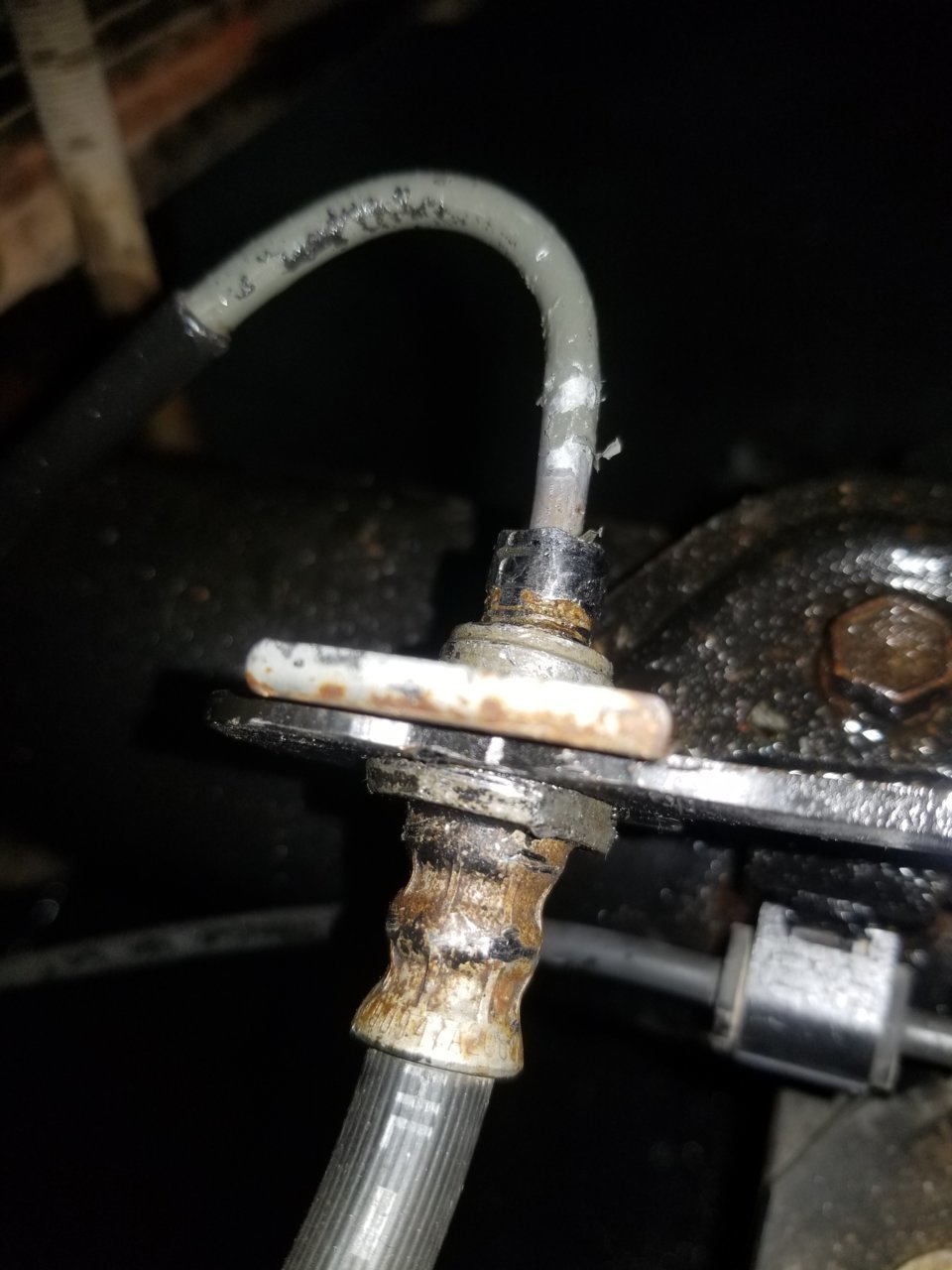

    Annnnnnnd the second hardline rounded off. Guess im buying a new drivers side hub line tomorrow... did a number on my finger when the wrench slipped too. Always something.

    Did you use a flare nut wrench? Usually they strip when you don’t..

    Nope, just regular old 10mm.

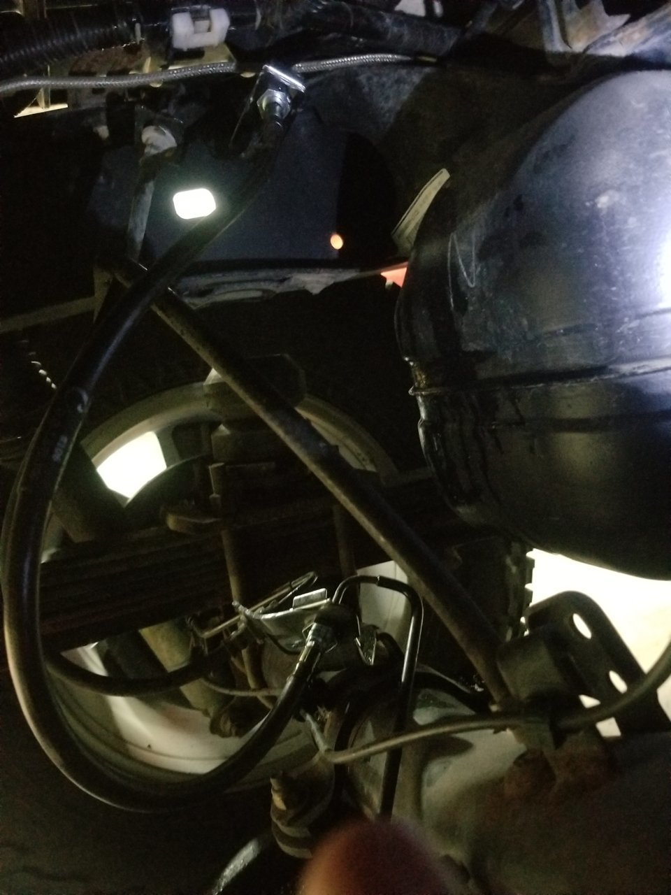

    Well pay someone to do it. I finally got it done but now I have squishy brakes even though I bled them. :annoyed: I'm sure it has to do with these having ABS systems. :facepalm:

    That would be the issue. Those fittings are soft and a regular wrench will wreck them.
