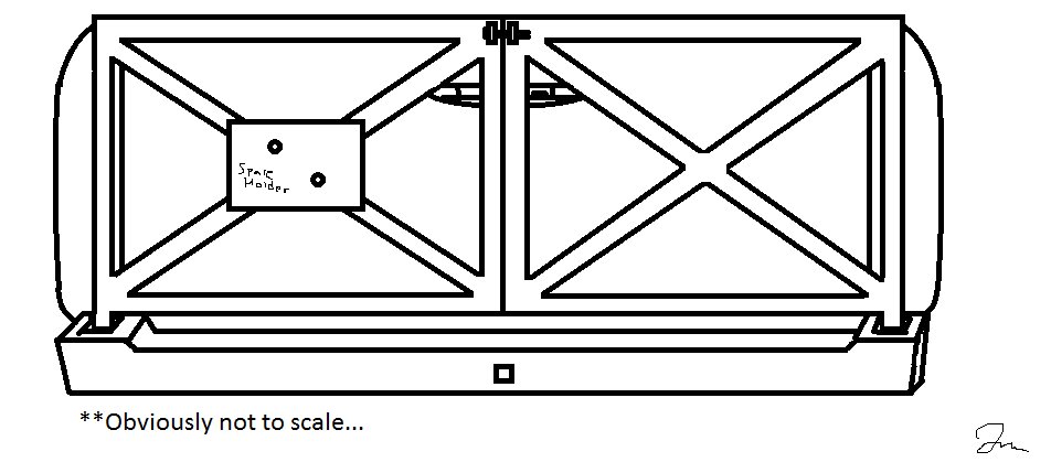

    Maybe consider offsetting the tire/wheel mount? Here' a rough sketch of what I'm talking about.

    Ah yes, higher, always an option. Positioning is always negotiable. Yours swings down! That's new! actually, is yours completely replacing the tailgate?

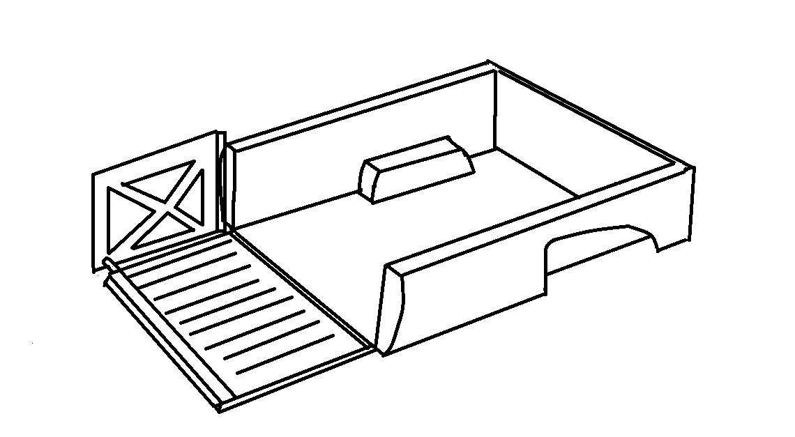

    Ah yes I was thinking more along the lines of:
    Potentially utilizing the latching mechanism or incorporating a tailgate protective cap that latches to the gates.
    Edit: sorry for bad scale. Also this is just one gate for visual purposes.
    Edit 2: Could even go as far as making an accessorie peice to put to close it out that could also be used as a cargo seperator in the rails.
    Edit 3: This would turn my trail limo into a stretch limo. :rolleyes:

    All interesting ideas. Have to prove a way to lock the "swing in postion" while the tailgate would be open.

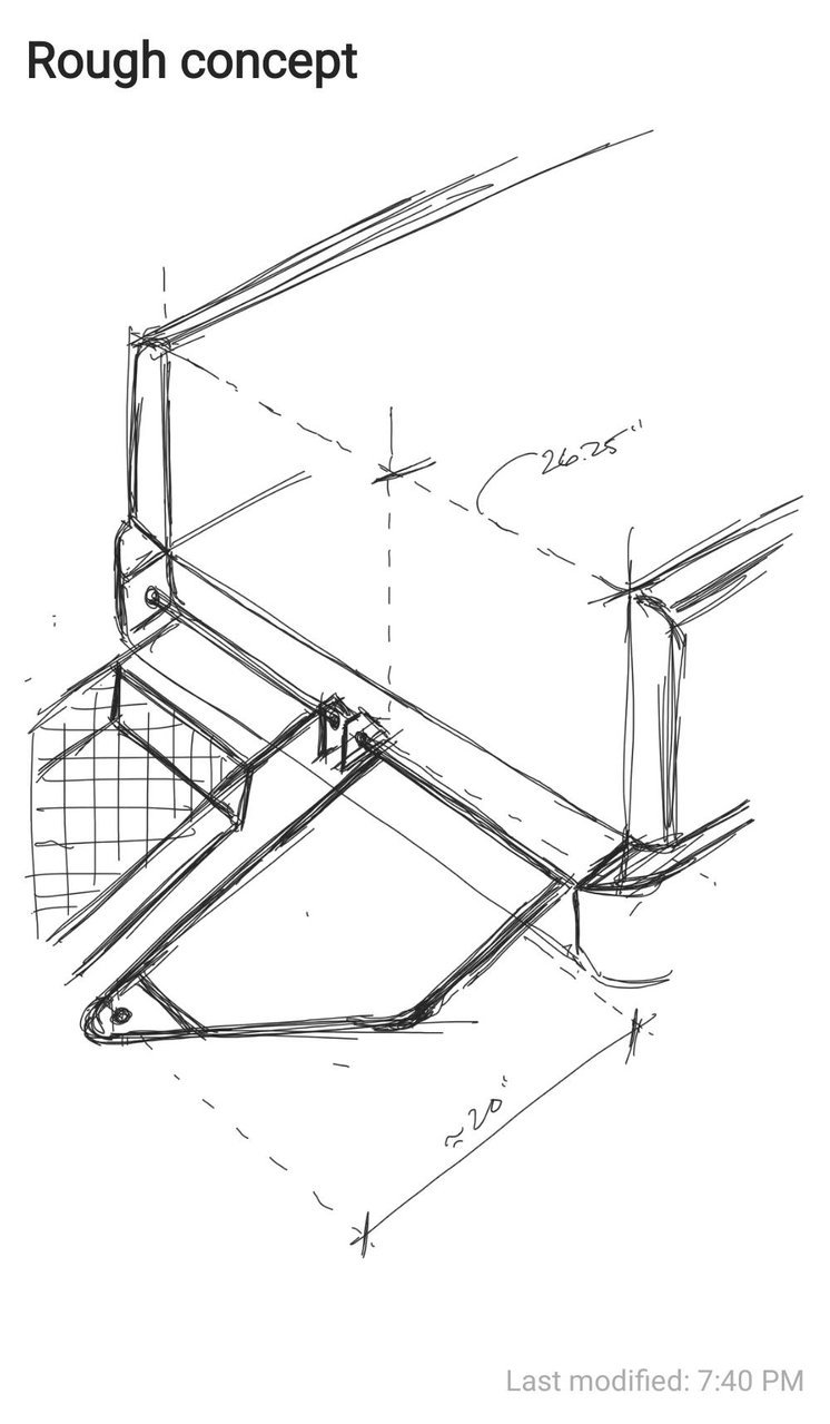

    Was thinking about it some more, but these would lock the gates closed by sliding into corresponding holes on the bumper.
    as for the latching mechanism to the tailgate...might have to scrap that idea, as the gates would extend past the end of the tailgate almost 9" Unless the gates were shorter but then their use would be hindered and it wouldn't look quite as good.

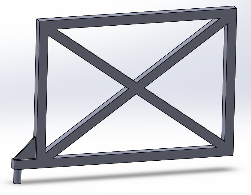

    finally got solidworks again at work :thumbsup:
    Here's a first iteration to size.

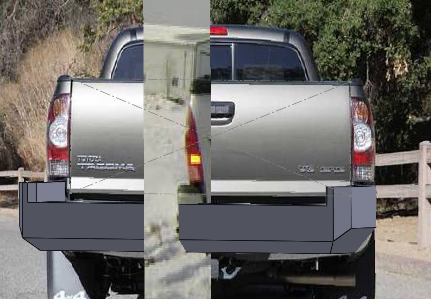

    Edit: WIP
    Looks too much like BodyArmor's atm. Will be making it match the bed sides better and will be shortening it for more clearance. Shaving edges here and there to reduce weight.
