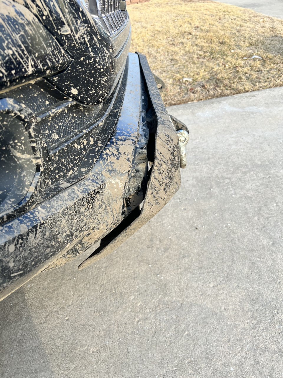

    Seen SoS bumpers do that. That style only bolts at the bottom and not through straight to the frame, unfortunately.
    @RCI-Offroad makes a helluva great front bumper :D

    also sos? like sos concepts? ive never seen one of those bend like that because of its mounting location and i know people that have and still run those with no issues????
    rci makes some weak control arm skids thou

    Lol. I've seen several SoS Concepts bumpers piss off their owners.
    No they don't... You just abused yours.

    ive seen poor quality as in something wasnt done right but it was usually fixed or not that big of a deal
    do remember i run sos stuff and was part of the group and overall saw no issues with anything they made and ive never had an issue with anything they made besides one bracket being off for my hc rear
    and ya they do... i hit one rock with the damn thing and it split in half!

    The winch plate on that slimline bumper looks like it has good bones so you could go full tube or even a hybrid style. Might hit up Kris at Okee Built Fabrication or Hard Knoxx offroad to recoup some money. I personally don't like bumper mount recovery points that don't have direct ties to the frame weather its welded into the winch plate or separate. I'd recommend using the welded tow loop on the frame itself for recovery.

    tbh it looks really thin prob best to just get something else from another company like rci or someone if he wants a slimline again

    It didn’t bend. The mounting holes are slotted so you can adjust the mounting location. Great for looks and universal applications but horrible design for actual use. The winch plate probably held more than it was rated for without issue and really impressed me. And I’m sure I can make the bumper work but it was a piss poor design from DV8

    Does the winch plate attach to more than just the 6 frame studs on the front? Toyota really didn't engineer these tabs well and I almost ripped the whole tab/stud combo off when winching a ram out of KS Rocks. added frame stiffeners and tied the bumper into the radiator support on the bottom which really increased it's strength. Thing didnt even break loose after messing up a silverado.

    his does not it bolts to the side and allows it to slide forward its meant for looks thats it, those studs are also rather weak and most when wheeling hard or using a lot of winch pulls will cut those off and weld in new kits that are stronger to reinforce that front end that will usually fix the issue then add frame stiffeners and its pretty much solid
    i wouldnt want to use that thing for anything other then looks lol but most bumpers these days for tacomas are all the same just with a little different style to em

    Just the 6 studs. Ideally I’d gusset the winch plate to the frame horns.

    Looking at the website the winch plate itself mounts to the 6 main studs, which is i agree a poor design. The gen 1 ARB i just picked up for the red truck surprised me with how much R&D ARB put into these, as it ties below the rad support as well as behind the first crumple zone with stiffener plates. I agree using the winch plate as is is a poor design but for a custom build wouldn't be bad base to start from and improve. Look at what Dirt Lifestyle did with the existing winch plate from his existing bumper. Nice tight design almost made me like 3rd gen noses.
