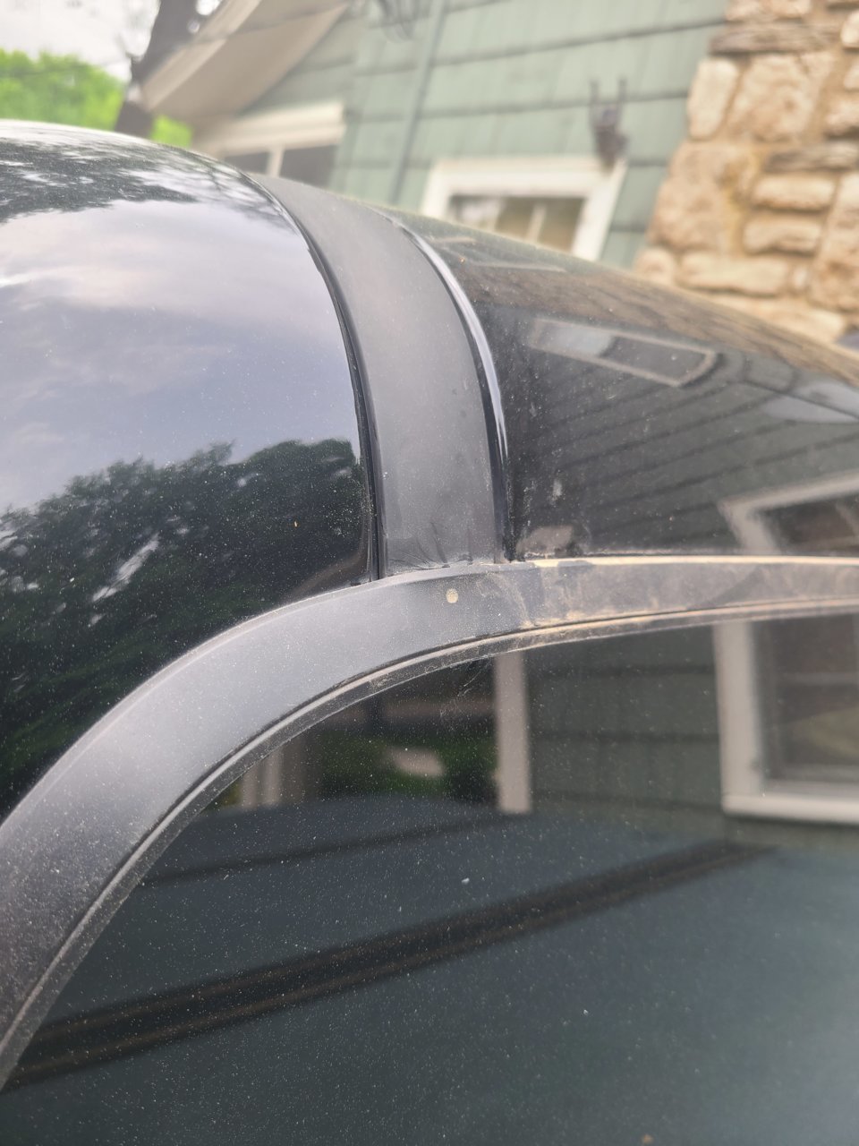

    Hey, have a question. I have a leaque at this section on the cab when it rains. Would this be a body shop fix? A glass in20220520_132549.jpg staller fix? I don't need my cab leaking water when it gets heavy rain.

    I would peel the seal away a little and see what's going on. If it's rusty could be a cab issue but if it's not I'd throw some silicone in it and lay the seal back down. If that doesn't work I'd go to a glass guy
