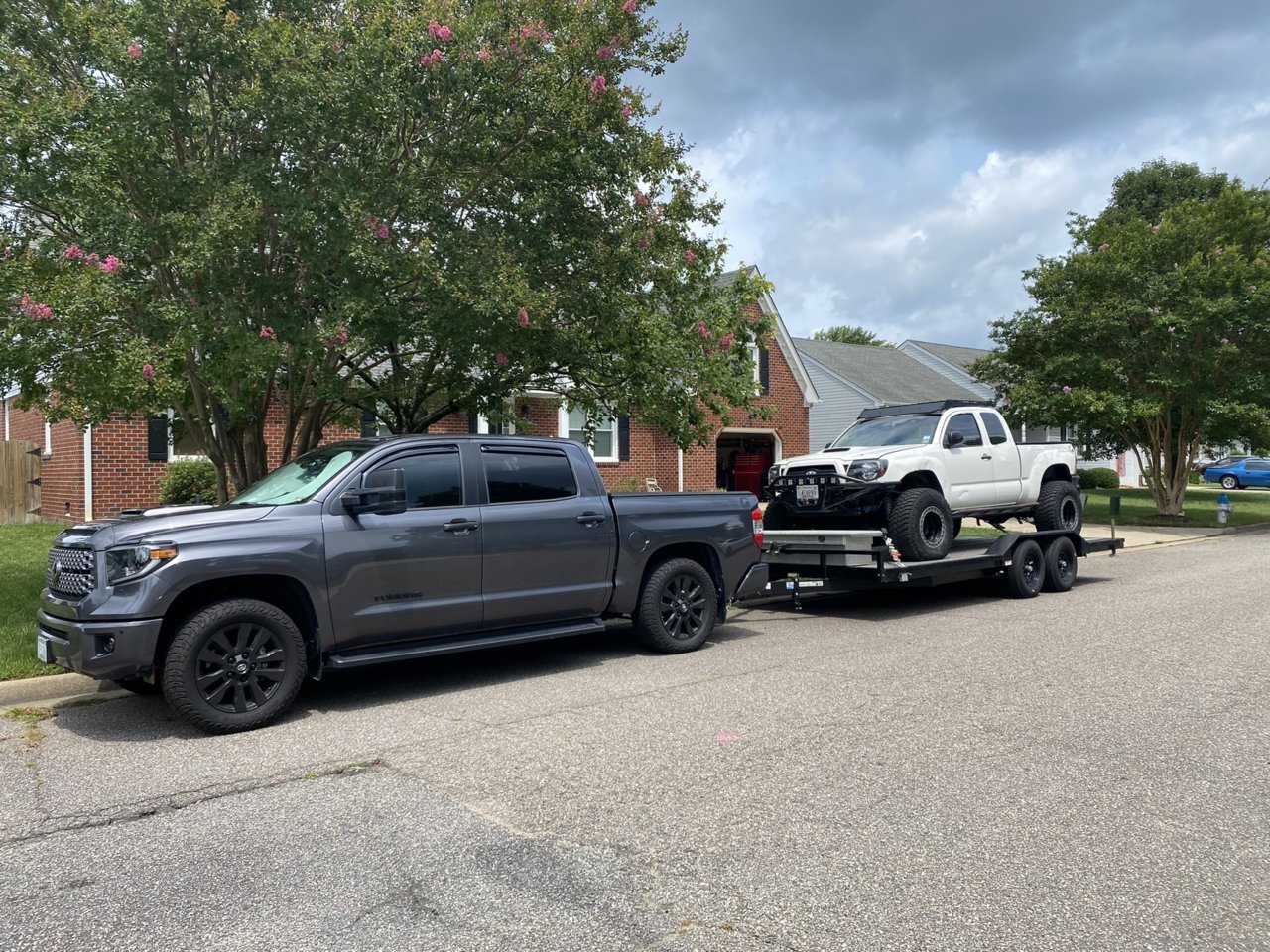

  17. Aug 10, 2022 at 5:22 AM
    EatSleepTacos
    Mar 24, 2015
    #151688
    59,842
    Randy
    West Valley, AZ
    2017 4Runner
    Absolutely get a WDH, I believe the manual even states to use one if you're towing over 4k lbs. I have the Curt trutrack on my tundra and love it. Once it was correctly set up, it dropped the front AND rear of my tundra 1/2" when loaded with ~1,000 lbs of tongue weight. It also has sway control so I can comfortably cruise at 70-75 and it tracks straight as an arrow.

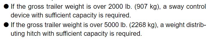

  19. Aug 10, 2022 at 5:26 AM
    EatSleepTacos
    Mar 24, 2015
    #151688
    59,842
    Randy
    West Valley, AZ
    2017 4Runner
    I was close, the tacoma manual states anything over 5,000 lbs needs a WDH. I would still get one though for 4,500 lbs.
