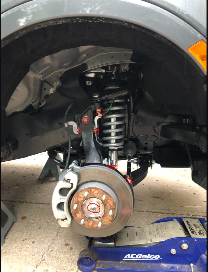

    nah no beer just on the ranger you have to unbolt a lot of things plus we ran to the parts store to get a socket and played with my pup for awhile and bs for a bit so not exactly 2.5 hours for that. give me a sec and ill show you all the stuff you gotta take off

    ill admit its a lot of shit to take off.. but once its off it goes in and out really easily but since i had never done it before we did take out time just chatting and workin on the truck so as stated it took longer then it really should have

    so first thing you have to do is remove the two nuts on the spindle holding the speed sensor and the brake line. then unbolt the sensor, after that remove the main nut on the spindle that holds the sway bar in place, then unbolt the tie rod, then unbolt the cv axle, after that unbolt the upper control arm, once thats done the spindle and lower can move freely buuut it wont fall out of the way to far unless you pull the cv out of the hub, after that you unbolt the two bolts on the bottom of the control arm for the coilover then go to the top 3 and unbolt them, after that you grab the spindle and force it down out of the way and have a buddy push down on the coilover to reseat it in the arm so it then can get out of the upper bucket, once thats done its out of the truck and then repeat all these steps and either put red lock tight on all the components or replace all the nuts if its the 4th time they have been off the truck (according to ford) so overall its a lot of things to unbolt compared to the old tacoma but its not hard once you know what you are doing. we took our time to not mess up and chat since we havent hung out in awhile and he hadnt seen eevee in a bit either so ye.
    so everything circled must come off to get to the coilover

    ya its rather annoying tbh... but oh well once you have done the process you can get it done really fast we did the passenger side really quick where it just flew back together
