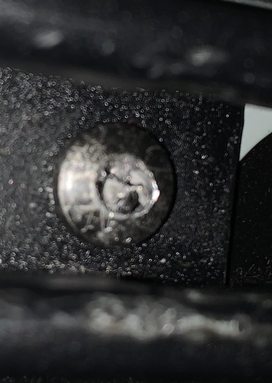

    I’ve put a metal saw blade on cut a solid straight line deep enough to get a flat head screw driver on it a try. That’s worked for me several times.

    That was my first thought but couldn’t get my dremmel to get through the metal. Now I’ll have to make a slot to get that line through the piece of drill bit and bolt head. I’m so p!ssed the factory made these so tight.

    Yeah I’ve destroyed several bolts over the years either by my negligence or whatever. Metal saw blade I used was on a screw driver handle but like a sawzall blade. Like this.

    Same trick I use. Don't forget to absolutely soak that thing in BB blast or something similar. Let it sit overnight. Unfortunately, winter and corrosion can really destroy these low grade bolts that are on the bed hardware

    Thanks! FYI it’s not corroded. Brand new truck with only 1,000 miles and garaged. Just screwed in at the factory WAY too tight.

    No, I don’t have a tool that can get between the rails and grind a slot for a standard bit to hold on to. Another suggestion I got was to get a cobalt bit to drill through the stuck steel bit piece.

    Yeah could just drill the whole thing out.

    Like I said, I think having 4 of 5 brackets tight and the 5th held in place by the attached lowered bed rail might be secure enough for the cover to not move. So I’d like to not ruin the casing but just want the damn thing off.
