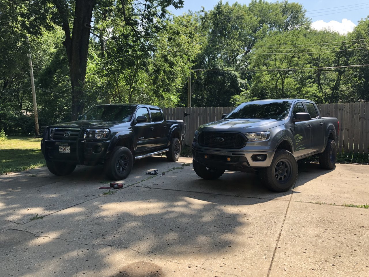

    Sold mine and somehow these things still show up in my driveway lol
    he was having a issue with his pads and rotors had some rocks in it or somethin so no more noise now but I noticed his driver side hub is making a load of noise so it prob won’t last much longer
