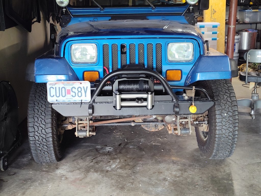

    Almost three years later, finally did it. Look at me being on top of shit.
    No remote solenoid, running low on room under the hood.

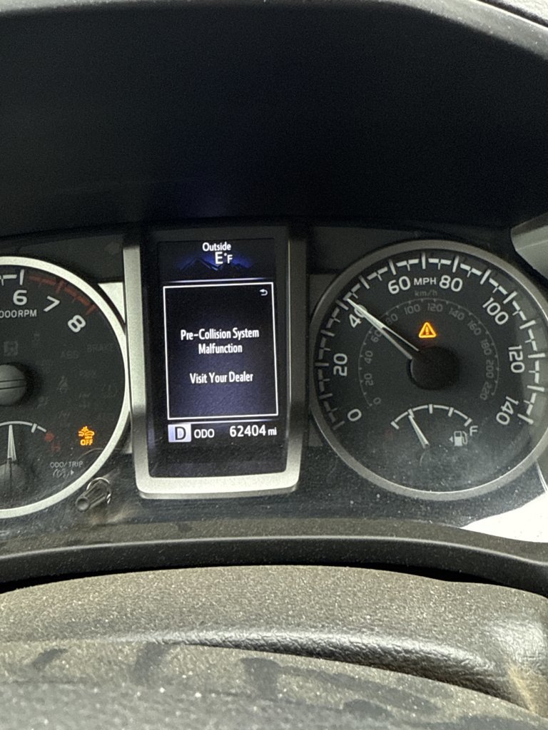

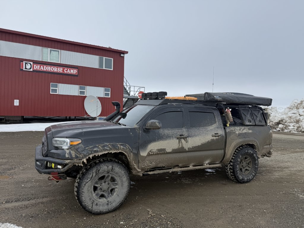

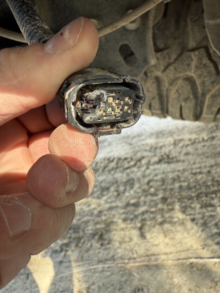

    Anyone happen to have a wire schematic for the IG1 No2 circuit for a 2021 Tacoma? I am up in Alaska and drove the dalton highway yesterday. I smoked a huge pothole and blew the fuse. Keeps blowing them so need to find what all this fuse powers so I can try to find the shorted wire.IMG_0642.jpg IMG_0574.jpg IMG_0579.jpg

    If it occurred during a pothole. My guess would be the speed sensor wire.

    That was my first guess. They all look good but that doesn’t always mean they are good. Not getting any ABS faults tho…so idk.

    Put your voltemeter in continuity mode and use it like a fuse, then start jostling looms till it trips or returns to voltage.

    Found the issue. BSM connector started sizzling after a day of driving with a fuse in.

    Woah, that is wild
