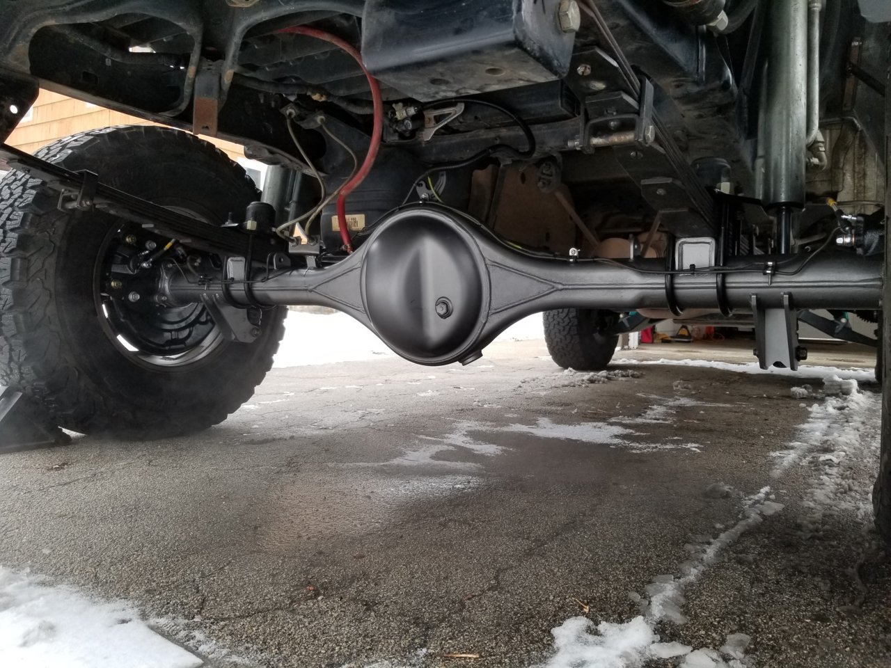

    If we weren't geared differently I'd be willing to trade you my e-locker rear axle

    I'd do it in a heartbeat. I've got my eye out for an e-locker rear end in 4.56. It's a long shot, but would be so worth it IMO. I've looked into making the locker work as a standalone and it's worlds more simple than the ABS nonsense I'm looking into currently.

    Well, if you don't mind setting up gears or getting a preset third member this is an option for down the road.
    I personally hate the e-locker and want to go to a standard axle with a Detroit Truetrac

    My original axle is sitting in the garage. It has 3.73's and the oem elocker. New setup is the stock tundra 4.30 gears and I'm installing an eaton elocker in it.

    My truck is also a manual so 4.30 is sufficient for me

    Haha, mine also doesn't have the factory shock mounts any more
