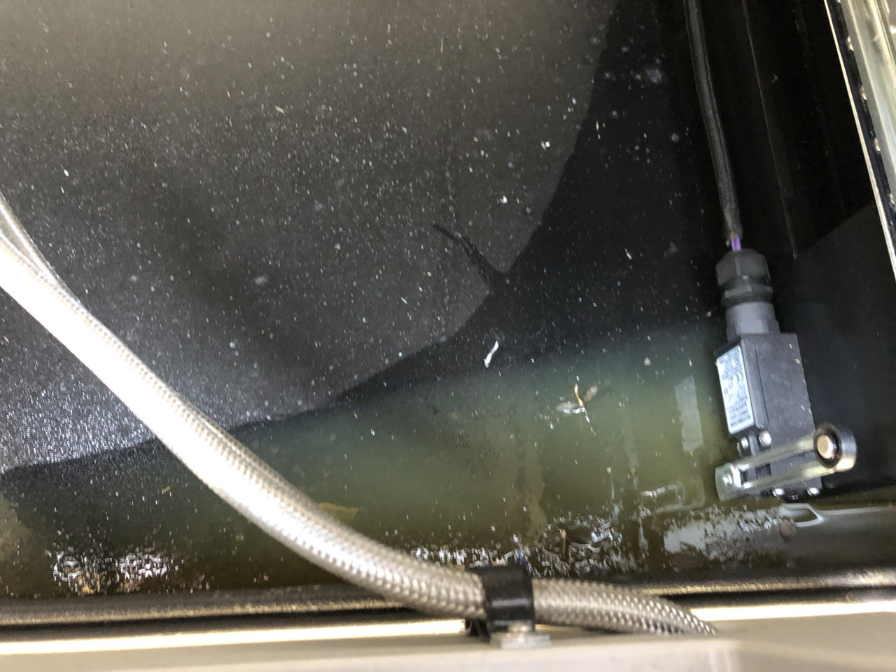

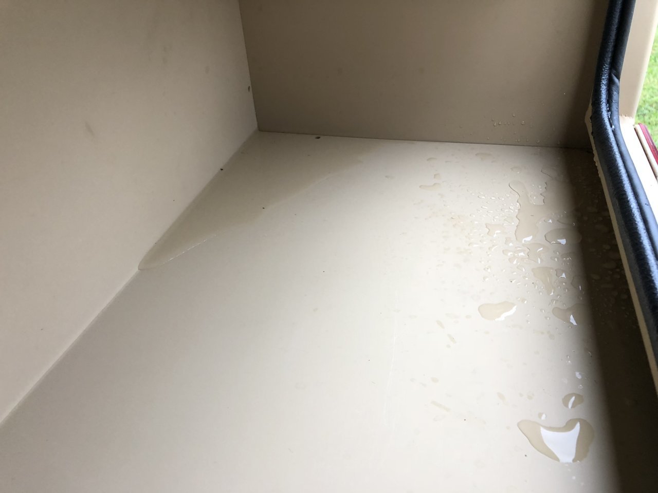

    Yes, all HDPE drawers.
    This is a small sampling of the issues. Apparently some things aren’t designed for the rain and humidity of the Midwest. Resealed this that and the other thing. New gaskets. A bunch of marine sealant. Still leaked like a mofo.
    It wasnt designed to channel and manage water flow from the rain (since thats not really a thing in Arizona), so it basically ran right in the doors.
    Other issues with short cuts on build quality i discovered after the fact.. simple things like wire management, termination and shielding which should be thought out in a $30k off road trailer.. not a spool of wire run with no shielding and basic crimps (not even water tight ones exposed in the undercarriage).

    Okay, there are so many things here... Just common sense stuff, really. :puke:Some decent design would have immediately looked to boat storage for ideas. Why no drain holes? How did they not road test in the rain?:frusty: And that HDPE panel looks to be almost an inch thick. That's skid plate material lol

    Yeah it was real great when I opened it up in July and everything I had stored in there was covered in mold..
    there was some really nice things and some really questionable things. The way the boxes are joined and the roof rack is really stupid. If you drill a 2” hole, it’s gonna be a lot more difficult to keep water out than if you have one just big enough for the bolt to go through.
    if you look at the doors, it would run off the top, right around the edge and against the seal. Most trailers have a gutter and multiple gasket system to prevent this problem.
    I think the majority of the trailers are in the southwest so it’s not really a problem. After the issues with mine, I found out a bunch of other people were having issues as well.
    pretty sure they still haven’t fixed the problem even in the 2021s
