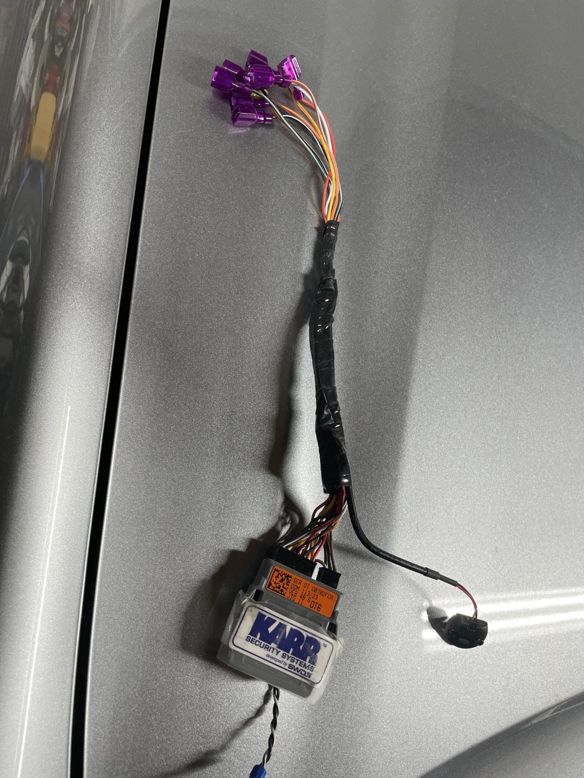

    Steves55
    Steves55 Well-Known Member
    Dec 6, 2017
    #237816
    512
    Palm Desert, Ca
    2023 TRD Off Road
    Here's the one from my 2023 that they told me they removed when I refused to pay for it. They lie. It's their nature. No more dead batteries. Had a guy at a car stereo place remove it.IMG_1710.jpg
    Furthering[OP] likes this.

    Two screws, cut a zip tie and disconnect all the male connectors from the T-taps. Really nothing to it.

    Didn't you have reconnect/splice back together the main starter wire, which was cut (grrr...) to put the alarm control box in the circuit? All the alarms I've removed that was the main thing that took care.
    This shows the original ignition circuit (green with black tracer) cut to insert the KARR control box (the larger gauge orange wires).
    As I manipulated everything getting ready to remove the alarm, one of the orange wires simply pulled out of the poorly-crimped butt splice. This is one of the reasons I hate these f'ing things. That same open circuit could have -- probably would have -- happened out camping some time, where diagnosis and fixing woulda been a lot trickier than in my driveway.
    Here's everything that came out of my Gen 2's KARR installation when I took it all off.
    Here's where the KARR control box was mounted above my 2015 DC's driver side kick panel. This is a pretty typical location to look for one.
    mit88 likes this.
