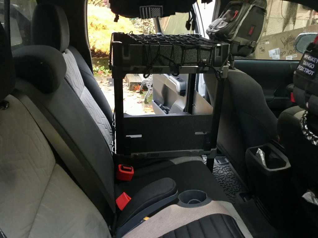

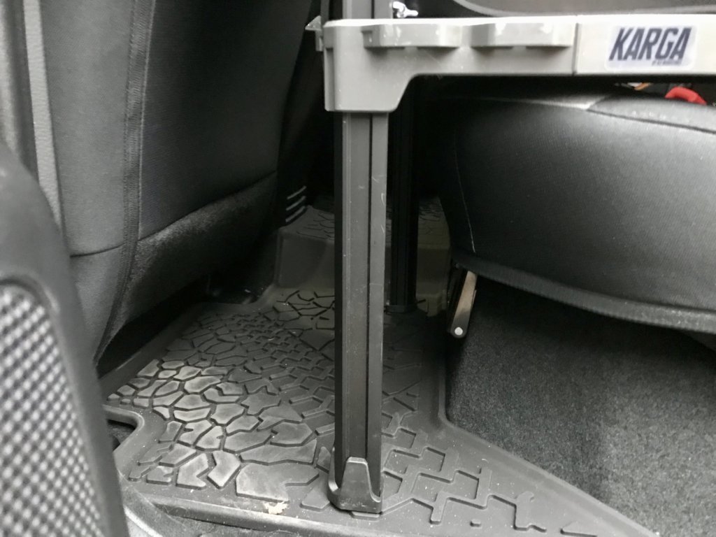

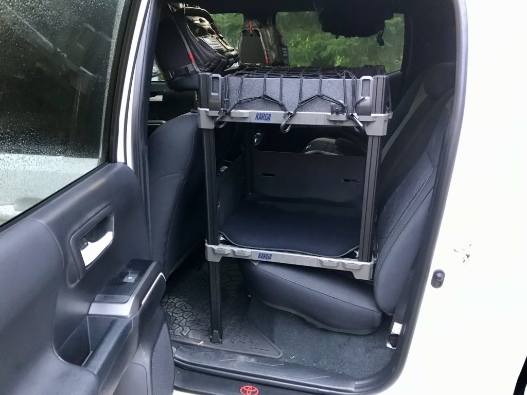

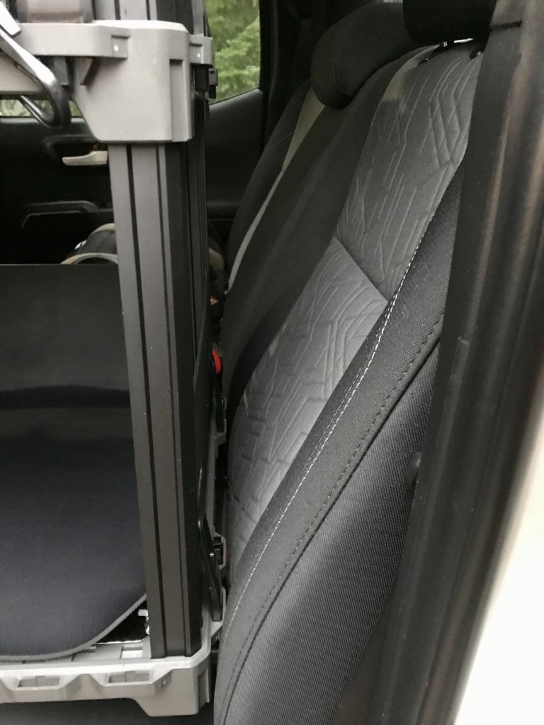

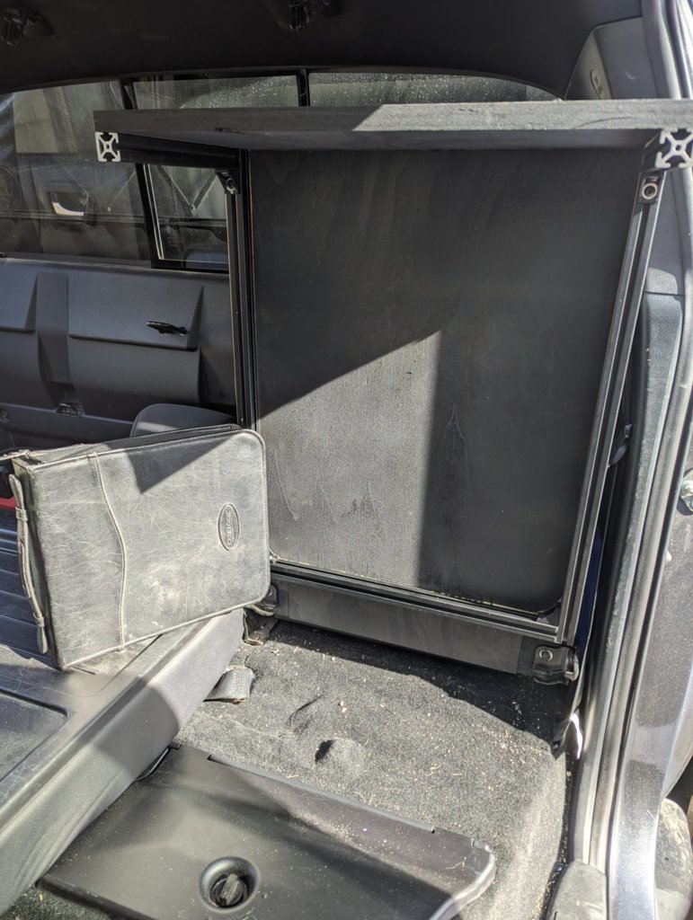

    So I was watching a Talon SEI video and he had just installed this unit in his new Taco so I went to the website to check it out. It is a shelf unit for your back seat without doing a rear seat delete. I like the idea of the seats remaining in place for ease of using them later and the sound deadening that they provide. The KARGA unit is removable in about 3 to 5 minutes with the seats available for use. It hooks into the child restraint anchors and sits on the floor on one side.

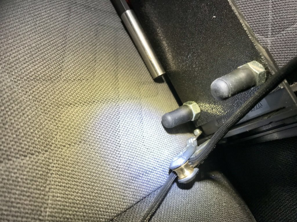

    I liked the unit with good quality materials and a smart system to secure it in the truck. Bad things are the instructions which are a little confusing at first but I figured it out once reading it several times. The other item is I felt that there were bolts that were close to the seat that might cause damage to the fabric. I put some rubber protectors on the screw ends to keep the damage from happening. Below are the pics that I took.

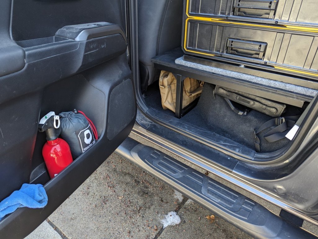

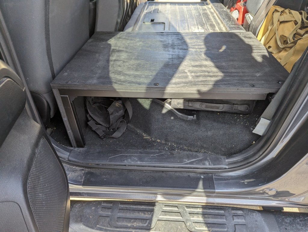

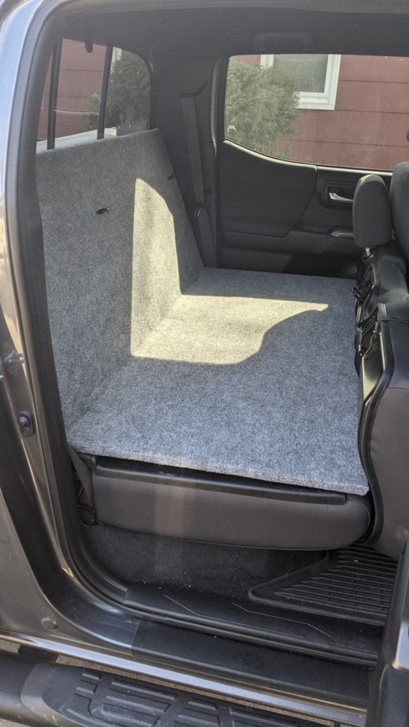

    I build my own that attaches to the bottom 40% seat bolts so that way it can flip up to get access underneath and is the same height as the 60% seat when folded down so my platform can fit across the whole backseat. It takes about 10 minutes to put the oem seat back in, but I have never used that seat so it's not a big deal for me to have it out.

    got a pic of the hinge or how its bolted into the seat that still lets you flip it up?

    My truck is loaded with tools right now so I can't get a good pic of it. But it literally uses the oem seat hinges and seat bolts. On the wood platform I put some T-Nuts on topside so I can just thread the factory bolts into the platform from the bottom.
