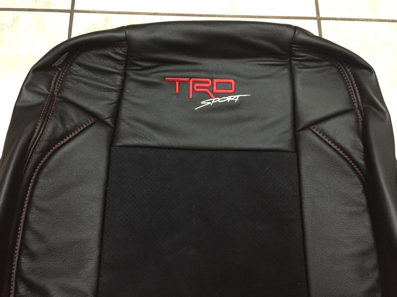

    Good looking 2016 Kit
    Black Wrap
    Raven Suedezkin perforated insert
    Red Contrasting Stitch

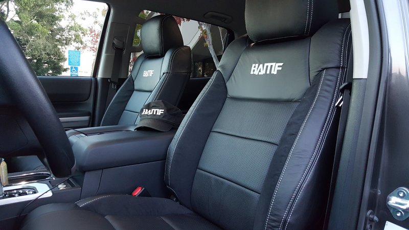

    Do you have a picture of these installed? I'm thinking about doing something similar.
  9. Jan 6, 2016 at 3:42 PM
    #549
    JLee
    JLee The Man! Vendor
    Jul 20, 2010
    #40461
    19,621
    Jerry
    Grass valley CA
    02 Extra cab SAS Linked front and rear
    I lost track thousands of dollars ago.
    Yep I do!

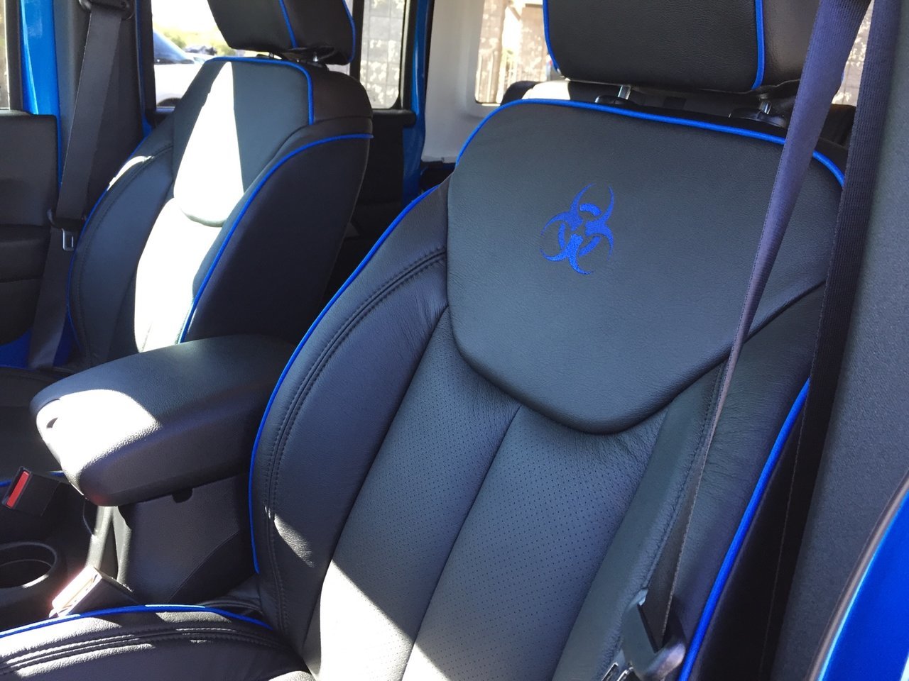

    Have to toss in a pic of a recent Jeep Wrangler install....
    Black w/Cobalt Piping and Bio Hazard embroidery.

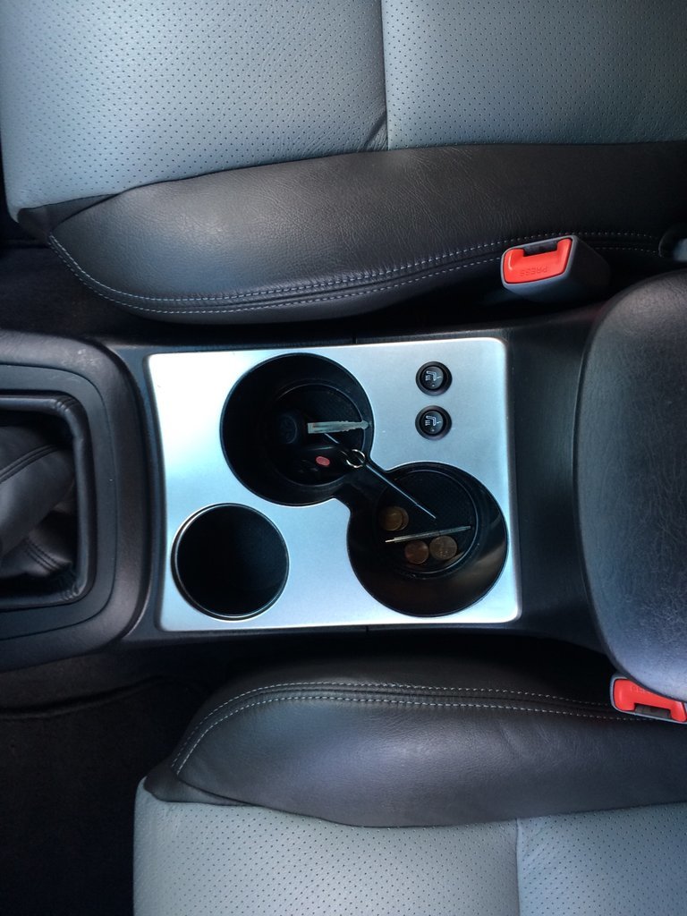

    My leather arrived today (the OR one) and it looks great! Won't be able to have it installed until mid-February, but I'll post pics when it's done. I Also wanted to note that the switches have an LED in them to let you know when they are on. Some pictures of the 2-way round switches that I found on the internet don't show one - maybe older models - so I thought I'd point it out.
