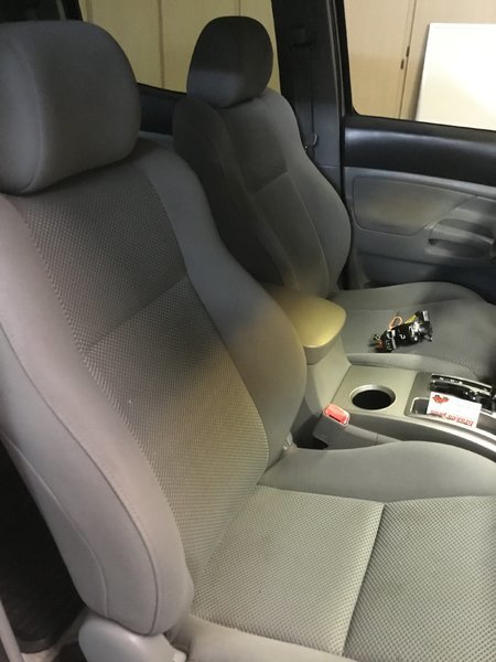

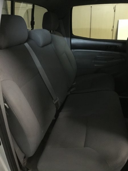

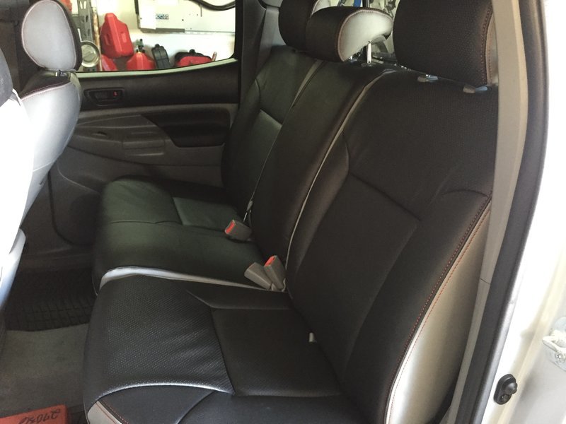

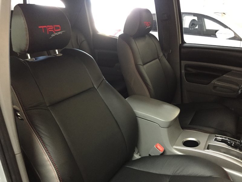

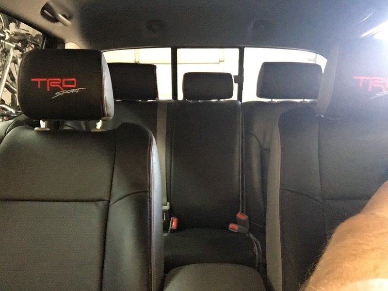

    Hey fellas, just installed new katzkin Leather yesterday myself, and I love it. What do you think? Feel free to ask any questions about install, price, whatever!

    Looks nice. What's the condition of OEM covers? Airbag compatible?

    OEM's are very good. One dime sized hole on drivers left where you get in and out. Everything else is great

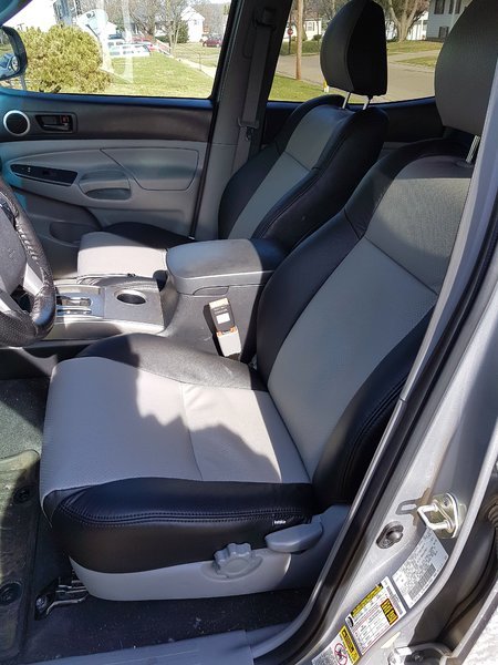

    AJT Designs Shifter AJT Designs Battery Hold-Down ARB Awning 2500x2500 ARB Twin Compressor w/ Slee Offroad Mounting Bracket Avid Brush Bar Avid Step Bars Black Rock Wheels Series 997 Type 8 Circuit Breaker/Relay Panel Custom TRD Decals Bulletproof Fabricating Raptor Grill Bulletproof Fabricating Cooling Panel Bulletproof Fabricating Tow Hook Duluth Trading Company Dog Hammock Exhaust Breather Mod eBay Special 3-Gallon Air Tank Expedition Essentials TPAM EZ Down tailgate damper Flagpole Mounts, Dual Foglight Mod Front Camera Rear Camera; full time available General Grabber tires Goat Armor Hella Supertone Horns Iggy Switch Panel Icon Dynamics Stage 3 Suspension Katskin Leather Interior KickAss camp shower LED Bed Lights LED Interior Lights Midland MXT275 GMRS Two-Way Radio OEM Audio Plus Reference 500 audio upgrade Plano Cases. 42" roof mounted, X2 Pop-N-Lock Tailgate Handle Prinsu Cab Rack Prinsu-like Shell Rack Redline Tuning Hood Struts Rigid Industries 40" Light Bar Rigid Industries Ditch Lights Rigid Industries Spotlights Toyota Bed Step UltraGauge EM Plus v1.4 Vixen Air Horns, Four-Trumpet Whole bunch of decals worth about 5HP each Yakima Road Shower, 10-gal
    How hard was it? That is, was this the first time you took on such a project or had you done it before?

    Hmm, just be patient, it's pretty easy, just time consuming. Theres a special way to do the headrests though!
    1. Drivers and passenger you will have to cut off the skin with a blade, the rears will slide off
    2. Rears you will be able to slide new ones one pretty easy, but not the fronts
    3. For the fronts, there should be a plastic bag under the skin, make sure not to cut it
    4. Get your shop vac and wrap the plastic bag around the nozzle and tape it shut, the less leaks the better
    5. turn on the vac and watch the headrest shrink
    6. squeeze it to help get the air out
    7 slide on the new headrest amd position it,
    8. Turn off the vac, and viola
  15. Mar 7, 2017 at 7:28 AM
    Gmoneybags
    Gmoneybags [OP] Well-Known Member
    Feb 19, 2017
    #211067
    97
    2006 TRD Sport Crew Cab
    I've NEVER apolstered ANYTHING. And I did it all inside of a day. No wrinkles, and no problems. Just some elbow grease and common sense should get you through

    Looks great though dude, nice inserts
