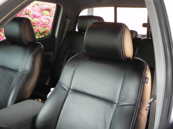

    not my pic, but my exact seat! hopefully ill install them this week... pics to follow!

    WHEW! Finally got the leather installed on the seats. Just need to work up the courage and time to do the door panels.
    It was a long struggle, and I can guarantee that I will NEVER be installing leather myself again! I even spilled blood over this damn thing!
    Anyways, on to the pics.
