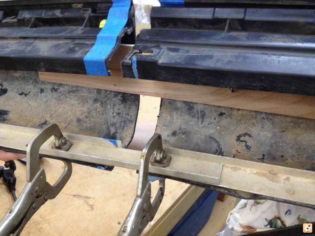

    Ok so quick update, I started cutting on the test piece and here is how it turned out so far.pezy4a9e_78c6a51b4bd44e4c605b6f39f3c0cb13354f3622.jpg
    And after that I braced the position so now it is ready for fiberglass.
    Hardest part is gonna be matching the form of both sides. On the final set, the gap will be much closer because I now know how much to cut down the mounting rails.

    That's ABS. Fiberglass is not going to last, no matter how much you sand it.
    It needs to be plastic-welded, using ABS filler material, and either heat, or a solvent.
    I used regular plumbing ABS cement on my Satoshi.

    Good to know, I have some extra plastic I can use to fill the gap and use that ABS cement to hold it together, is it easy to work with.

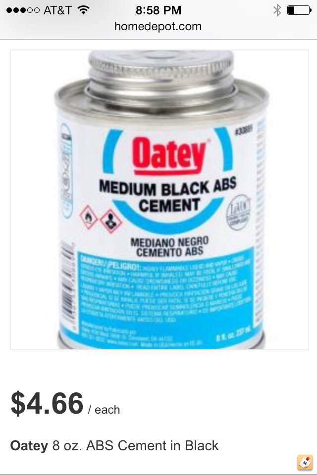

    Will this work to bond the pieces together properly?

    Correct.
    Better than your previous idea for sure! ;)

    You want to be adhering abs to abs.
    Best bet would be to get your part to the proper length you need it to be at and then use the cut out section as backer and filler.
    Do you get where I'm coming from?
    This is essentially how I fill the sides for the satoshi's - I use abs to fill the gaps.;)
    Like rich stated - fiberglass is not your best choice....

    Well I have to order the ABS cement, no one in the area carries any so the progress is postponed until next weekend.

    No plumbing or home improvement stores in DWF?
    That's crazy... ABS cement is in every plumbing department on the planet that carries black "plastic" sewer pipe.
    And ditto on Homer's comment on backing. You'll have to be careful to avoid getting into the area occupied by the rocker panel, but there should be enough room back there for at least one layer of uncut ABS.
    Secured solidly to the truck on both sides of the joint, cemented with ABS cement, a butt-joint might last and not crack. Make it a lap joint with a piece across the back that's a few inches long and the chances of it not cracking go up a lot.
