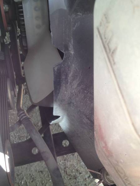

    Update:
    I was working under the hood of my truck and noticed chunks missing from my fan shroud and I have no idea what could have caused this, Does anybody have any suggestions as what could have caused this?

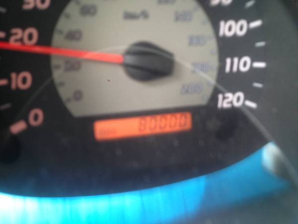

    Finally passed 80,000 miles the other day.

    Los Angeles
    08 Base
    Satoshi with FJ badge, factory cruise, factory intermittent wipers, Redline Tuning hood-lift struts, Hellwig Swaybar, Rosen DVD-Nav
    Broken motor mount, engine torqued and the fan hit the shroud.
    Previous owner could have lost the fan carrier bearing/water pump.
    Both would be unlikely at low mileage.

    **Afe cold air intake w/pro dry filter, Yellow tint fogs, Daytime running lights, led dome light, led license plate lights, Led tail lights, 3 inch carbon antenna, spec d projector headlights, carbon fiber look interior trim pieces, Djm control arms, Djm notch, 4x4 leaf springs, beefed taco 2 inch blocks with offset pin, Rear Qa1 Shocks, Sittin sic stock height coils, x runner bilstein front shocks, weathertech digital fit floor mats, debadged.
    Maybe a rock flew up in there and just bounced around
    Never seen that without serious damage to the core.

    Lowered: 3 inch drop blocks (Beefed Taco),Satoshi Grill, Morimoto bi-xenon H1 Retrofitted headlights, Flowmaster exhaust, Blue LED interior and exterior, blue LED dome light, Anzo black LED taillights, Hifonics Brutus 1100w Mono Block, Bazooka 300w Amp, LED license plate lights. Lifited: Fat Bob's rear shocks, Fat Bob's 3" spacer and rear AAL, Nitto Terragrapplers, weldertaco wrap around rear tube bumper, TrailWorx Fab tube front bumper
    I hope that is all that happened.
    I have heard that can happen from a broken motor mount but wouldn't I hear a very noticeable sound of a fan hitting the shroud every time I accelerate heavily?
    Possible it was like that when you bought it and never noticed?
    That could be possible. But if it hasn't, I should probably look into it just to be safe.

    4.5/5.5 drop, DJM arms, QA1 coilovers, 6lug leafs, QA1 18-way, rear swaybar, Batwing Big brakes, high flow cat, indy/hurst shifter, memphis amps, focal 3-ways, Eclipse AV unit, SunDown 10" custom box, TRD bucket swap.
    Check mounts and beating of they aren't leaking out broke who cares
    Wait, what?

    05 5 lug minitrucker
    Check mounts and bearing, if they aren't leaking or broke who cares
    That is what I thought. Just making sure.
    Just checked my motor mounts and they still look perfect.
    Have your GF sit in the truck.
    Stand outside and watch the engine (NOT standing in front)
    Have her "gun" the engine with the trans in gear and foot on the brake.

    07 4x2 reg cab / 12 4x4 double cab
    Yup. My accord had a broken mount and when I'd rev hard the whole engine would shift up and in one direction. That was just in neutral tho. Rich you is one fart smeller! I mean smart feller lol
    My 2nd car had a broken mount.
    Fucking thing torqued over and LOCKED to full throttle on me. Made for a fun trip down the road.
    Ya... it was a 12-second '69 Camaro... not a Civic.
    Replaced the stock mounts with Moroso solid mounts.
