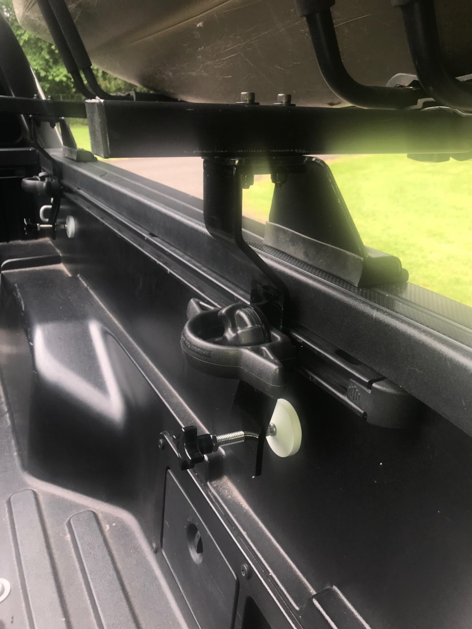

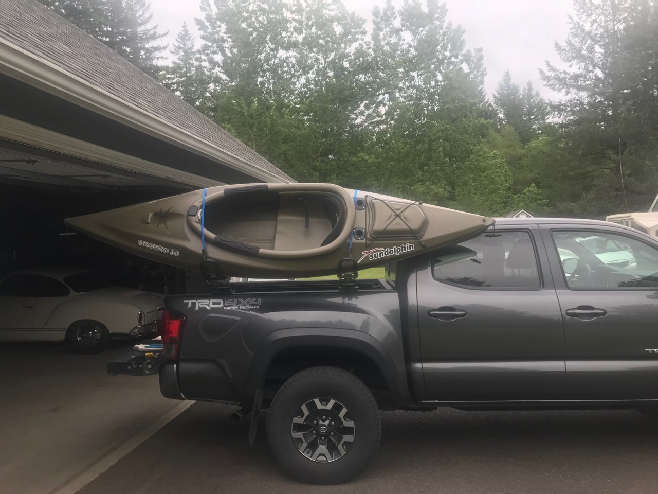

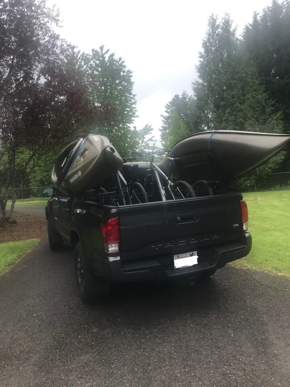

    Wanted to carry two 10 foot kayaks and two mountain bikes also pulling a small trailer and still have room in the bed. 2017 off-road 5ft bed. Haven’t hit highway speeds yet... should be soon

    It a Frankenstein of sorts... I purchased the J-hooks and bars from E-trailer.com. I originally intended on mounting the kayak carriers on top of a pop-up tent trailer but thought differently after not be able to come up with a good way to mount without compromising the roof. I had a really sharp guy help figure out how to make brackets that would utilize the Tacoma bed rail system in the way you see. he drew them up and I had a machine shop water jet and bend the brackets, Purchased the hardware at Mcmaster carr, Also added another rail up front to attach two mountain bike forks. probably could have found a cheaper solution but probably not near as fun to design,build and install.
