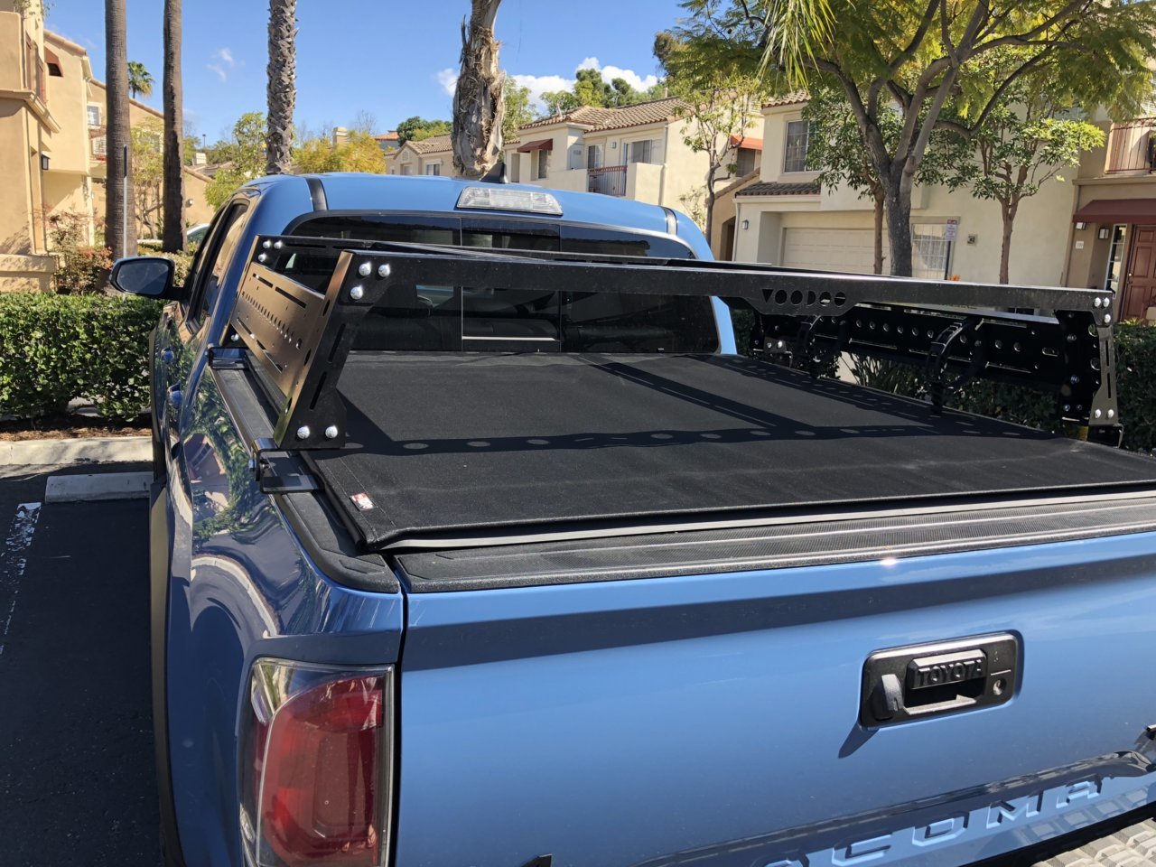

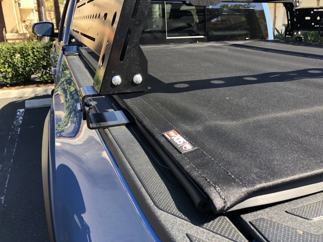

    I have a Truxedo Pro X15 and a KB Voodoo bedrack. You just need to cut some aluminum on the rail of the tonneau cover.

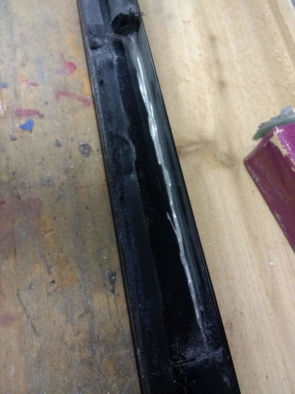

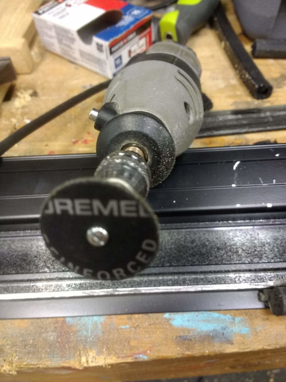

    I have been running this combo for ~6 months and am really happy with it. I still need to redo the weatherstripping on the tonneau rails, but that hasn't been a priority for me here in Colorado.
    Here are a few pictures I took along the way:

    Awesome! Your rig is looking great, thank you @drakenclimber. I too am in Colorado and am also not concerned with the cover being completely waterproof, it would just be nice to keep most of the elements out of the bed when it's full of gear. How far up are you able to roll the cover with the rails in place? Another advantage I'm hoping for versus a trifold/hard cover is being able to open and access the bed at least partially with loaded racks.
    You're probably already aware, but I found some truxedo specific replacement weather seal here that I am planning to use to fill gaps or replace post rail modification.

    I can carefully roll it up under the first (farthest back) Voodoo railing, and I can slide it under the second (farthest forward) railing if need be. It's honestly pretty easy to fully get the tonneau out of the way if you want full access to the bed.
