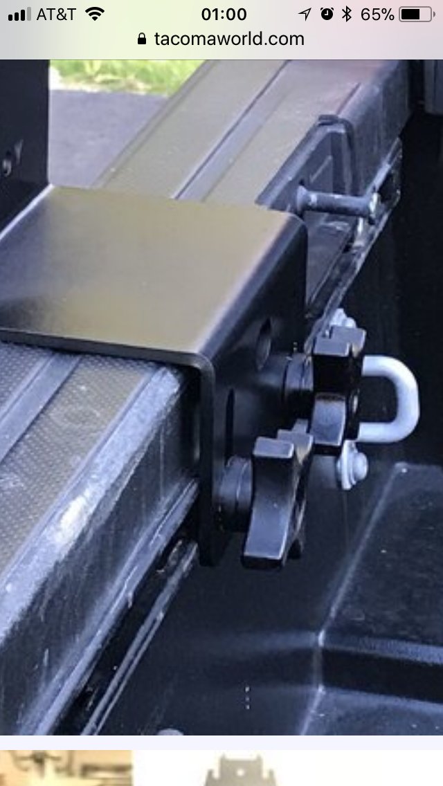

    To move the mount up with the button head, were you still able to use the washer? Or just the button head bolt?
    Could I just squeeze the provided bolt and washer in there? Or is that a no go.

    So I did use the washers. It works with them. You get one side in there, and the other will hang up. I hit top with hand and it went down no problem.

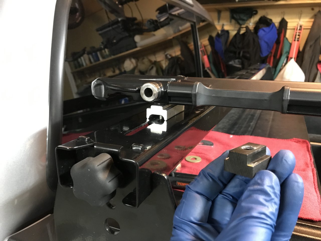

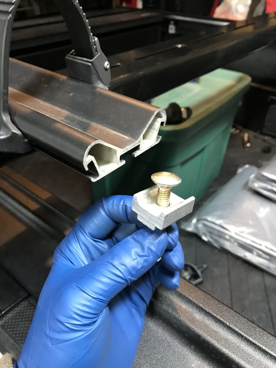

    I realized these rail clamps work as shims. I mocked this up with the Jetliners. It works okay. Used two bolts. Mounting to a longer track or metal piece would be stiffer. These will work I think, just need the right shim. Rockymounts makes a track but I don’t know if these will mount to it. I ordered two loballs and will install those.

    Well, the stock hardware deff doesn’t fit between the canister. Just tried a handful of times, no go. I’m going to pick up some button heads tomorrow. I can’t believe you got a washer in there. It doesn’t look like I’m going to be able to! GRRRRR!! Gonna keep trying!

    Edge should slip past the button head. Just bang it pretty hard and fast with fist. It should drop in past the edge! Go to an ace hardware type of place not Home Depot. They will have them. Good luck!

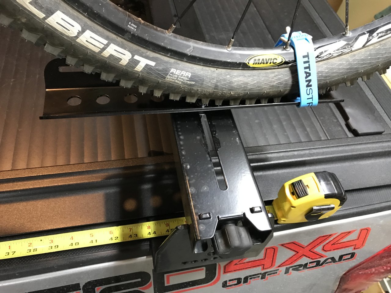

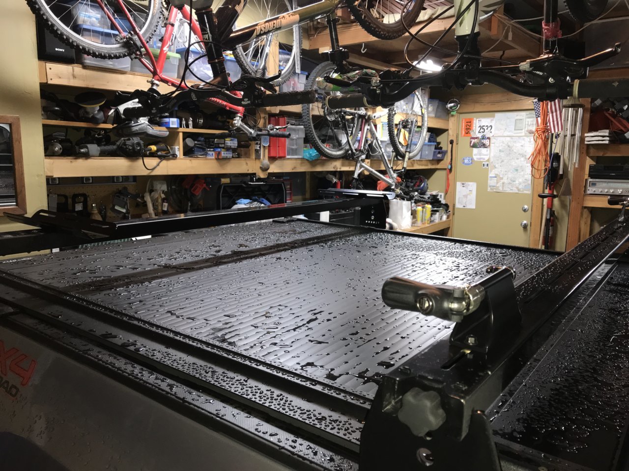

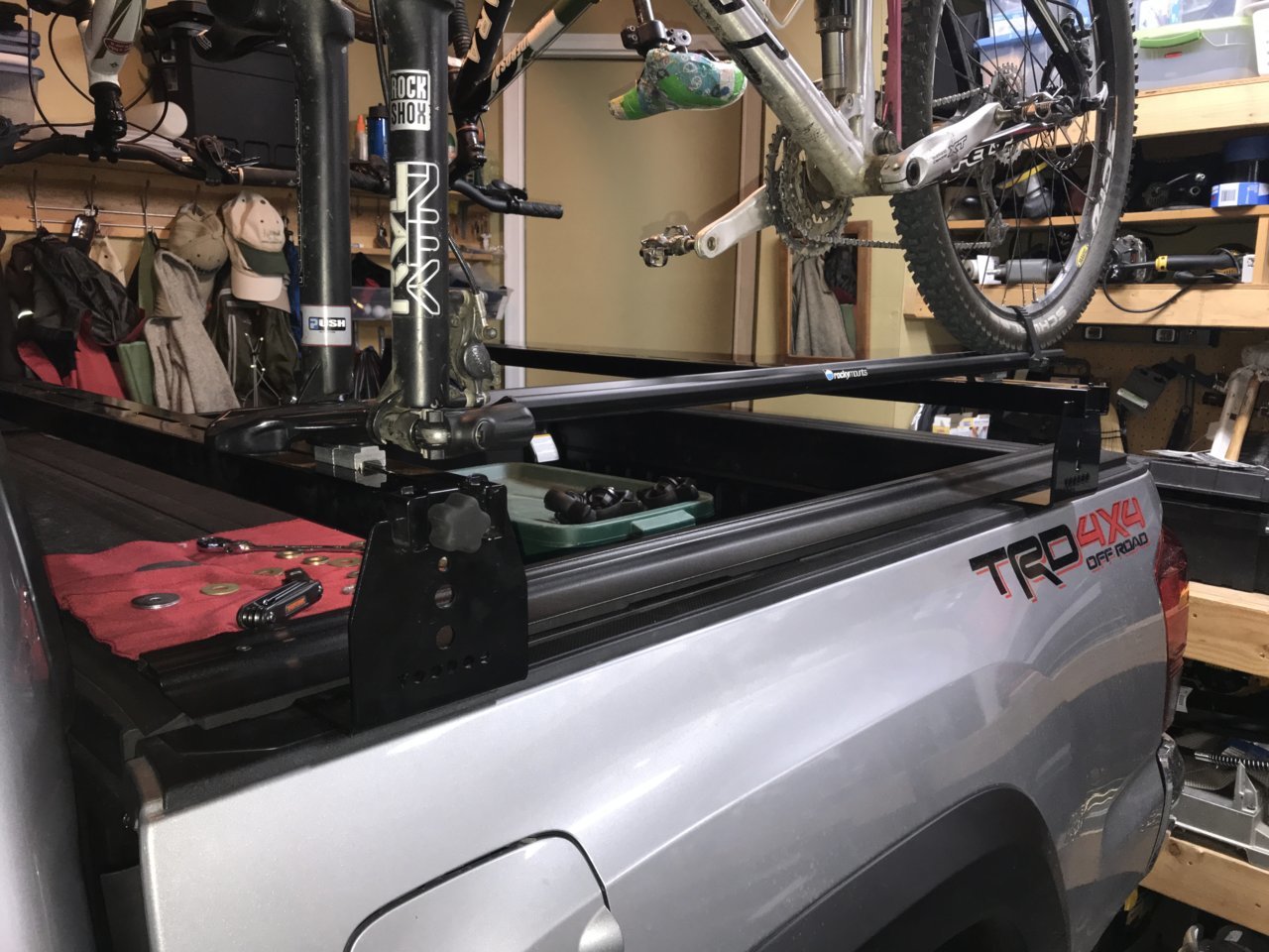

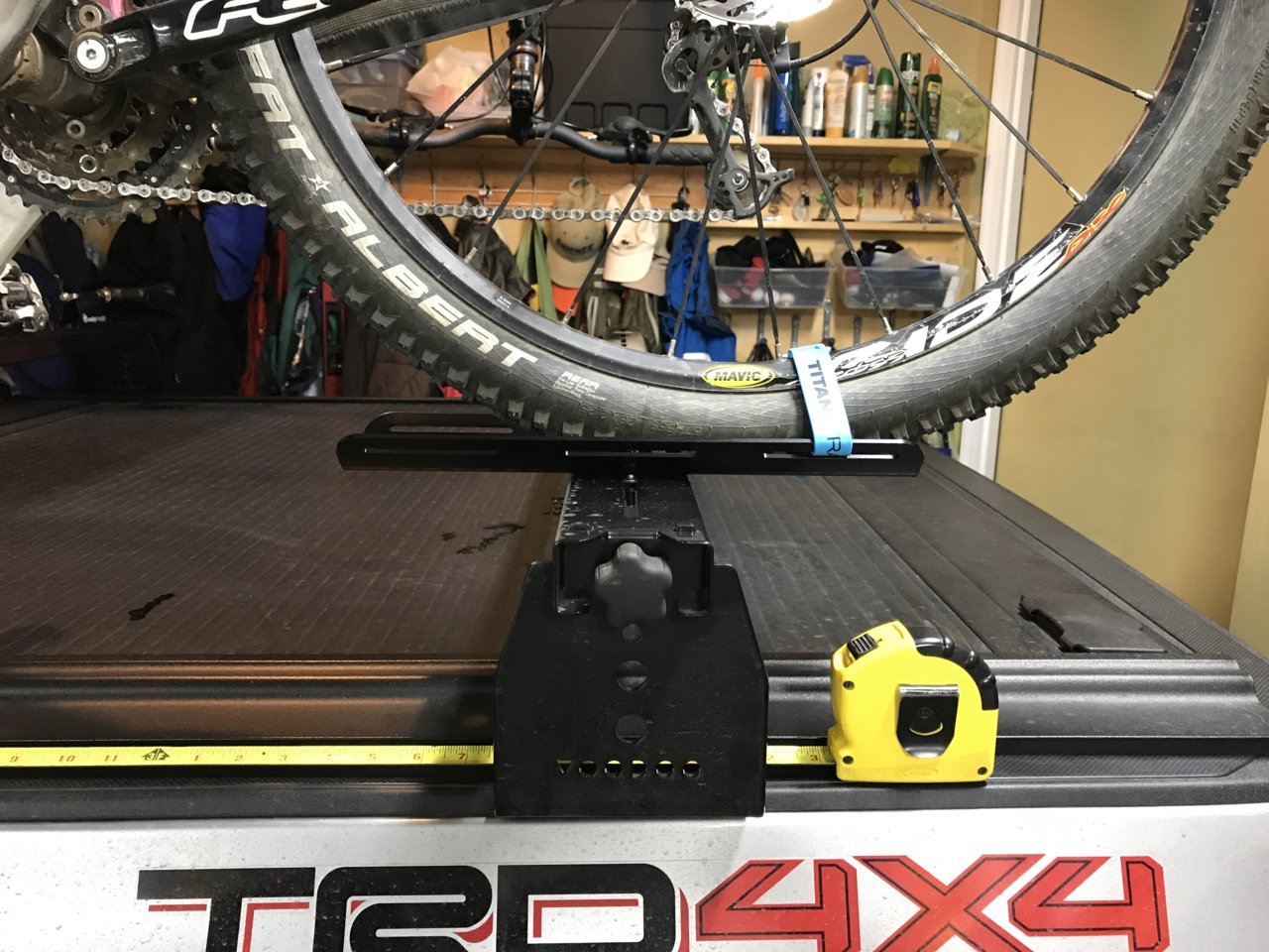

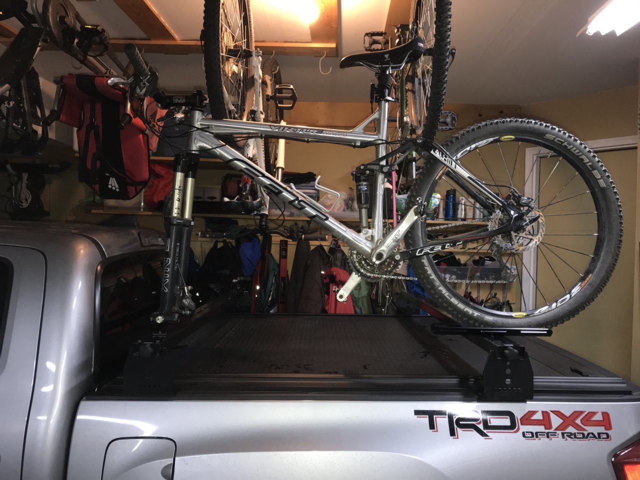

    B6261F6F-D07F-4AFC-A16E-59E725655931.jpg Rear KB trays installed. Like them, good setup! Substantial and nice look.Rockymount fork mount fronts. Winter here again for the day. Look forward to getting back in the saddle. Feel like I posted way too many times on this thread! Stoked that it’s figured out! :D

    Can you post a pic with the bike mounted? I want to see where the rear tire sits. And also how far up is your front bar?
