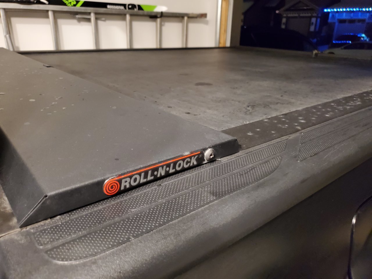

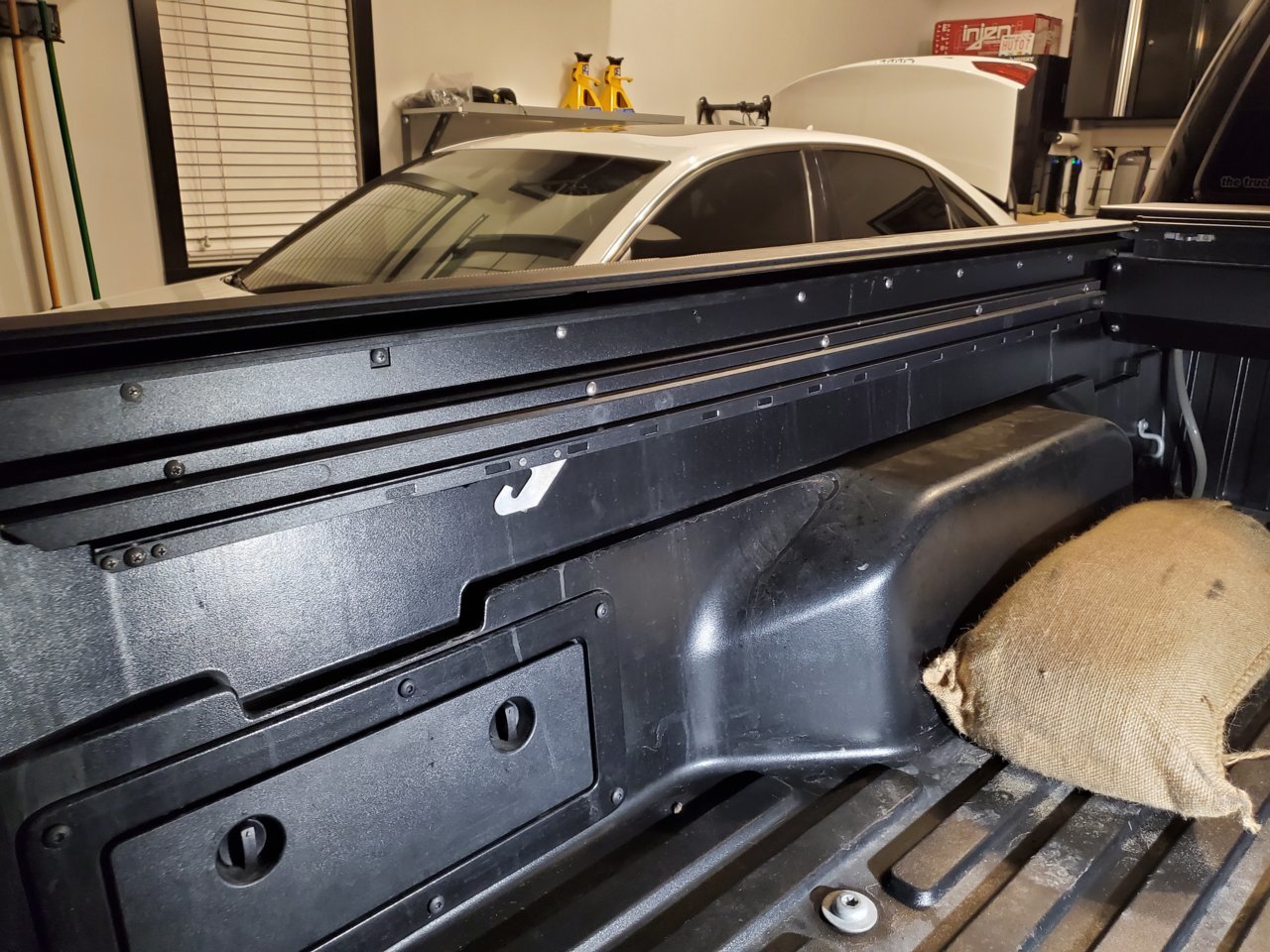

    Just looking for anyone who may have installed these Crossbars with a Roll N Lock tonneau cover? I've attached a couple pictures of the cover. Just curious as to how much work I'd be getting myself into and what sort of modifications I'd have to make.
    Thanks!

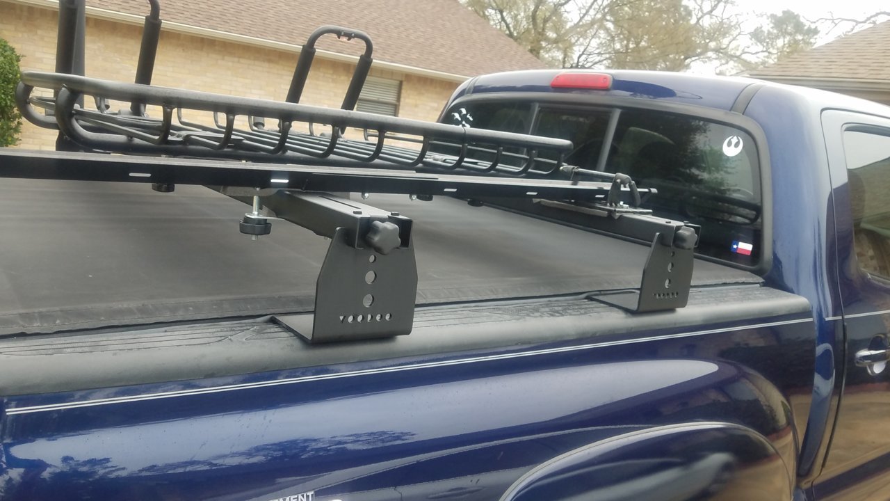

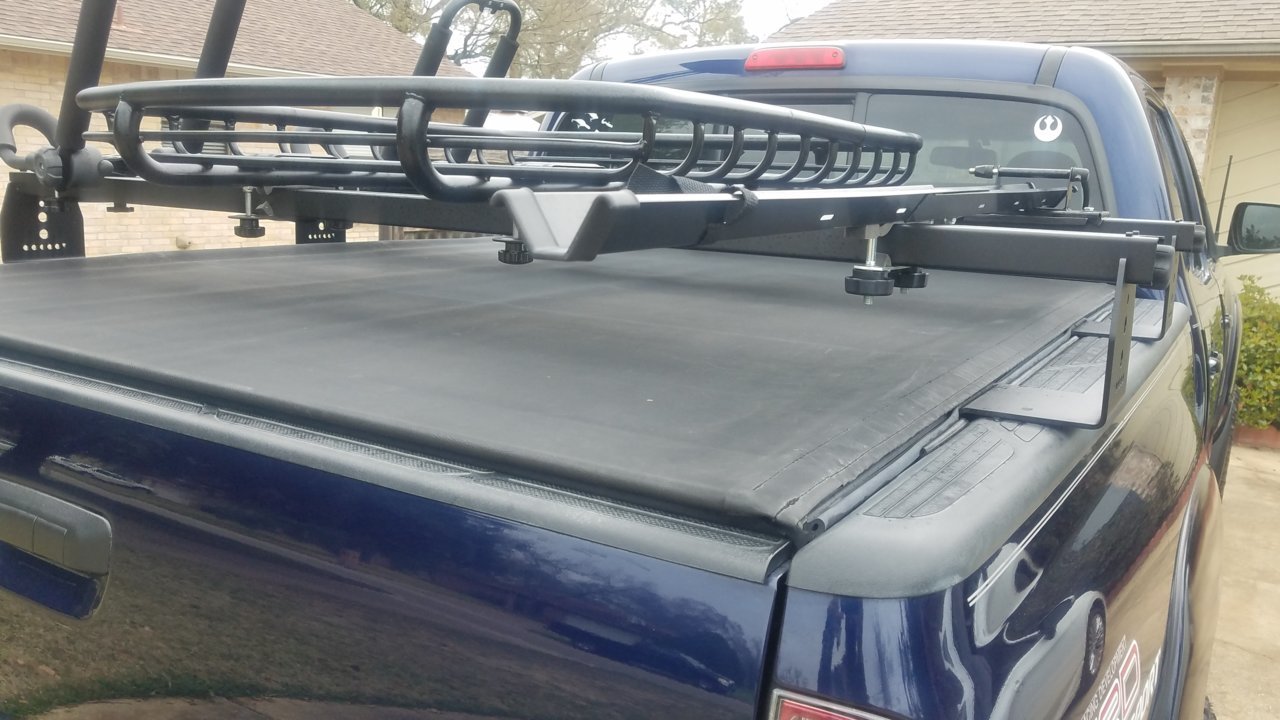

    Late post, but I have the crossbars installed with my Truxedo Low Pro QT. Because the brackets are so thick, the tonneau cover rails are pushed inward making closing the cover a tight fit; but it works. This also creates a gap between the bed rail and tonneau cover rail, which was solved by running weather stripping in the gap. I took a dremel to the plastic caps on both sides on the end of the cover where it clips in to the tonneau cover rail to alleviate some of the tightness. Shaving off just 1/16th of an inch made a huge difference. I've come across a number of posts asking about the Truxedo roll up covers, so I thought I'd share my experience.
