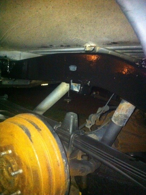

    Hey TW,
    A couple of weeks back I posted about KBS Rust Seal, and no one on TW seemed to have used it. Rust Seal is a product much like POR-15, or Rust Bullet, it is a moisture cured urethane, creating a barrier not allowing oxygen, moisture, etc to get to the frame or existing rust. The KBS System is a three part system like POR-15:
    1. KBS Klean- Degreaser
    2. KBS RustBlast- Phosphoric acid metal etch
    3. RustSeal- Top Coat
    So I ordered my KBS Frame Coater kit for a price of $65.00, pretty nice compared to POR or Rust Bullet in my college student opinion. So the box was nicely packed and arrived quickly, shipped and came in three days.
    I started by getting all the loose rust off the frame, and then sanding the painted section with 320 grit sand paper per KBS directions. I used a wire brush for the loose stuff and a file for the top of the frame since a brush wouldn't fit between the cab and frame. After that I used a diluted mixture of water and the degreaser (5:1) and scrubbed down the frame. It was crazy how much dirt and grime came off the frame.
    So now the cool part, RustBlast is like any other rust etching product but it seeing it first hand is pretty damn cool. The stuff is nasty as hell, I wore a mask and eye protection. I also work long sleeves and gloves. You have to keep the surface moist with the product for a minimum of 30 mins for it to work. After doing that, the prepared surface had some white powder (zinc phosphate) on the frame. The rust was literally gone, it was really cool because some of the surfaces were corroded badly. Then I rinsed the surface thoroughly.
    So after that, the RustSeal goes on, the actual paint goes on very thin, a little bit goes a long way. For the passengers side of the truck I paint the fully boxed section of frame and the top, bottom and side of the C channel. I will go back and paint the inside of the C channel tomorrow. One of the coolest parts of the stuff is how well it self levels.

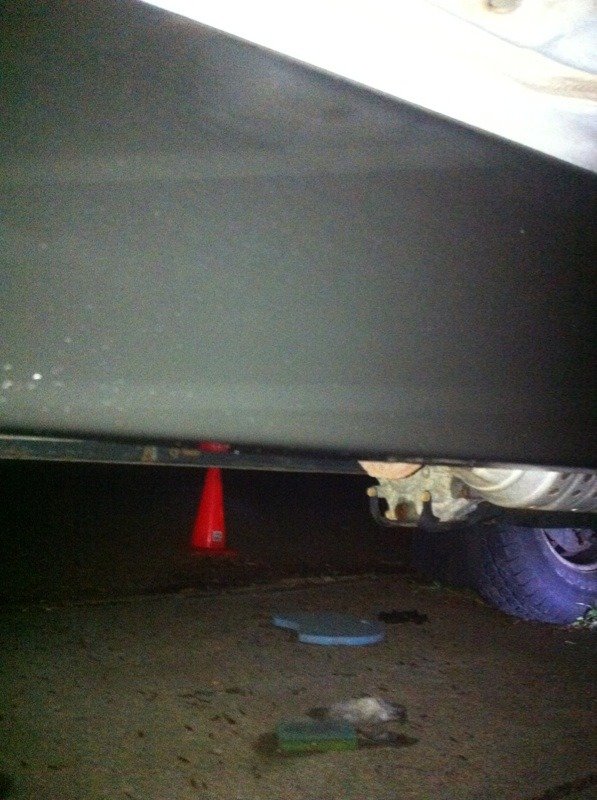

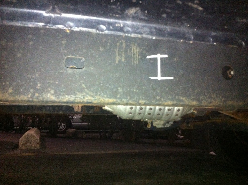

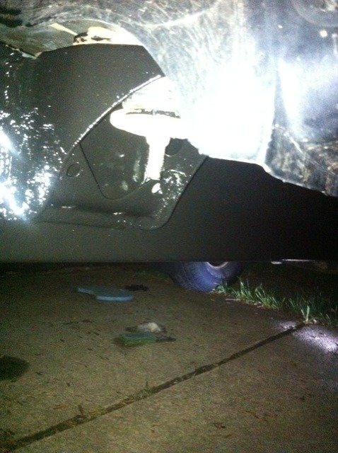

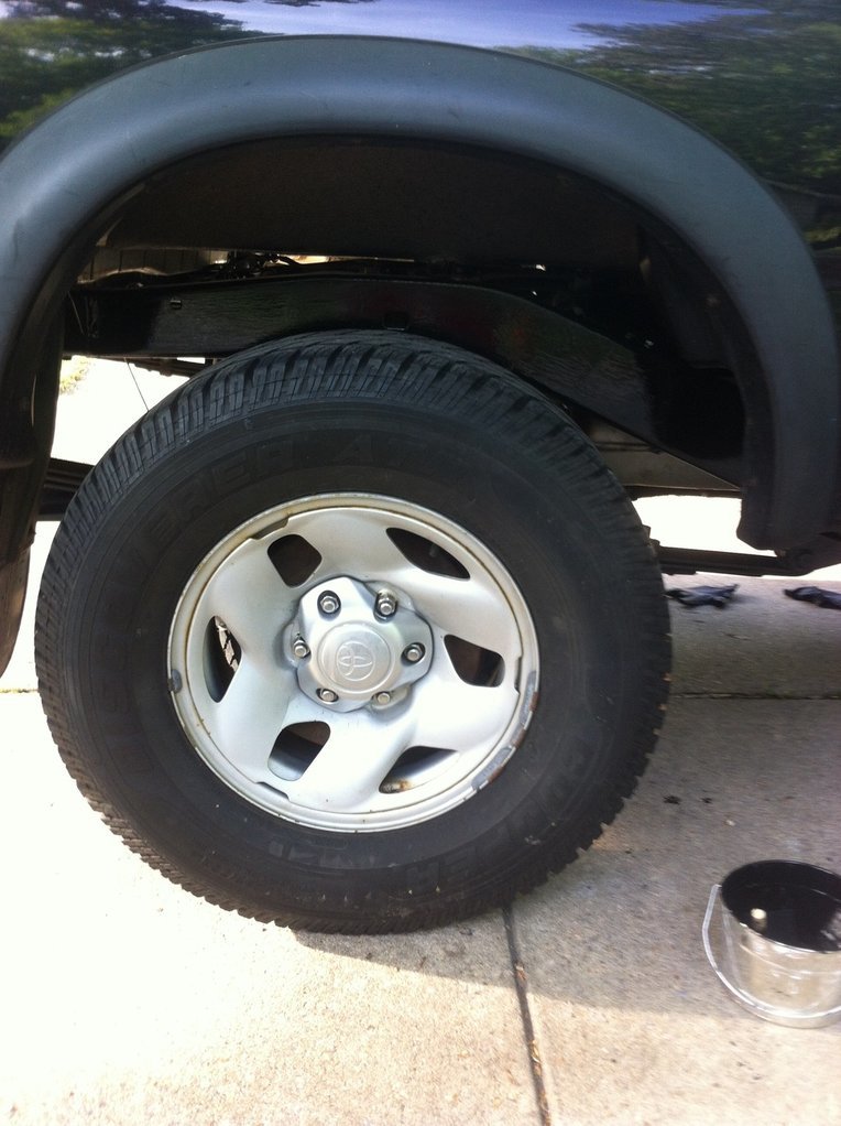

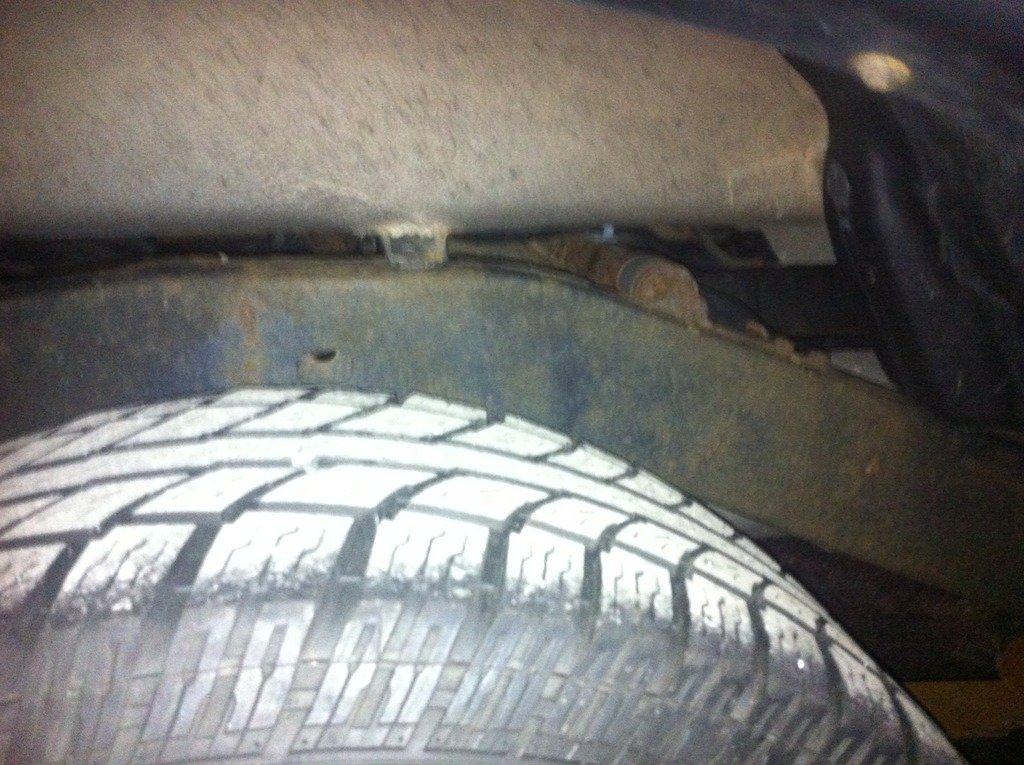

    Before:
    After:
    Yes, I know my drums are rusty :), and that shock
    My frame is about 45% done at this point and I hope to be done by tomorrow evening, I am doing this before I go back to college for a summer class and internship.
    Overall I am excited about the results, but I still need to finish. I would say that prep takes the longest, where as painting took no time at all. I have about 12 hours on this project, which included painting the leaf springs, and skid plates as well.
    RustSeal is an awesome product and it seems tough as nails.
    I will post more pictures tomorrow and in a few months to show how it holds up!
    Thanks,
    Tommy
    More Picture 5/14/2015

    Update: After 6 months, the KBS Rust Seal looks great and has not changed since the day I applied it. There is no flaking of the coating. In addition to rust seal, I used KBS cavity coater for the inside of the frame and that was also easy to use.
    Although we haven't had a major snow storm on the north east yet I have gone off-roading with the recoated frame and driven a fair amount.

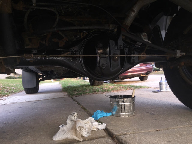

    Update: After 10 months, and the end of winter, the rust seal has held up great! I did actually miss one spot on my frame so I painted that area this last week. Aside from the KBS products have held up great to the salt.
    I also applied rust seal to my rear axle, and third member. (Painting in progress to show the difference between unpainted and painted)
    ca62f5dc82166d1a621cd0024fb1be06_6a51f0a1b386a4ef4e874d89cdbc684f745cf4c5.jpg715090a05cb52b97e53670679cfe2b27_71ca268b5d7e10132de18e42e279afcffdced594.jpg
    I have also inspected the frame for weak spots and found none!
    I am hoping that all of the work I have done has added many more years on to my truck.
