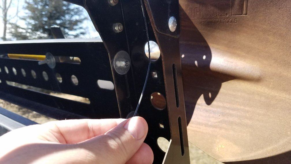

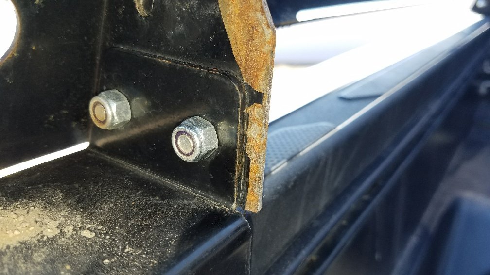

    anyone has issues with their kbvoodoo rack system mine seems to be having paint coming off in sheets, i dont pressure wash it etc just odd that after year it started peeling off in chunks. anyone has similar experience with theirs?

    here are the pics, i took pics of the worse spots, but looks like the edges stripped off on all of them now, as seen in last pic, just leaves little thread like that eventually falling off. kinda sucks, any one recommend good paint to do on these, i am thinking taking it apart and sanding again i guess and repaint, or is there other alternative?

    I was thinking salt perhaps....but don't see any. What did KB Voodoo say?

    No. Known issue he had with powder coat. Kinda sucks

    Our powder coater really fucked us with a bad batch of parts. We will get you replacement parts.

    It does suck. It’s a shitty situation that this guy put us in. Honestly it’s been a catastrophic event for us. We’ve spent a small fortune making it right for the customers who’ve been affected.

    It was an entire trailer load of parts that they admitted that they forgot to do the phosphate rinse prior to powder coating. It affected about $14k worth our inventory.
