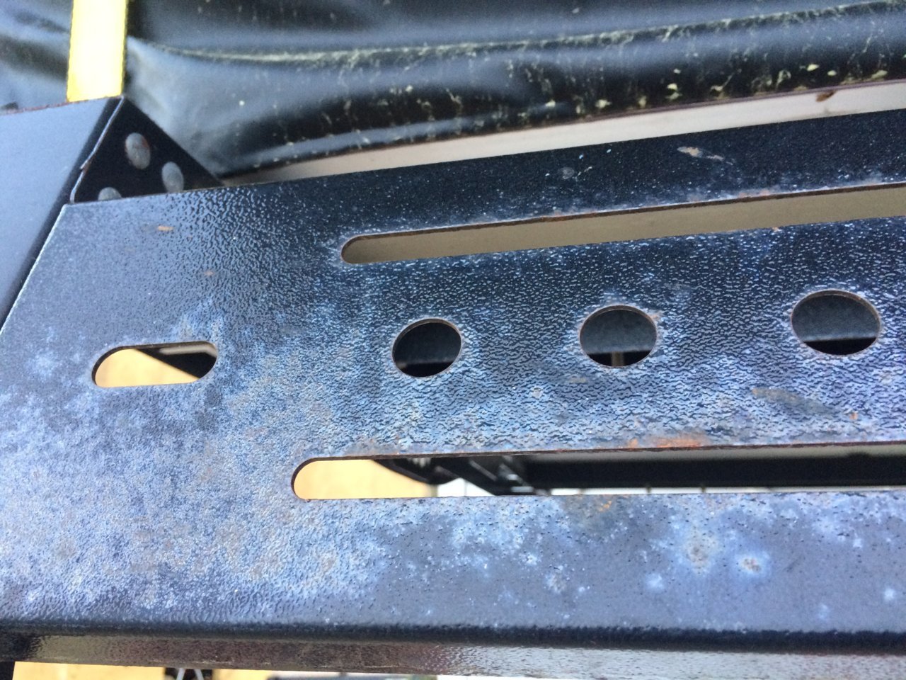

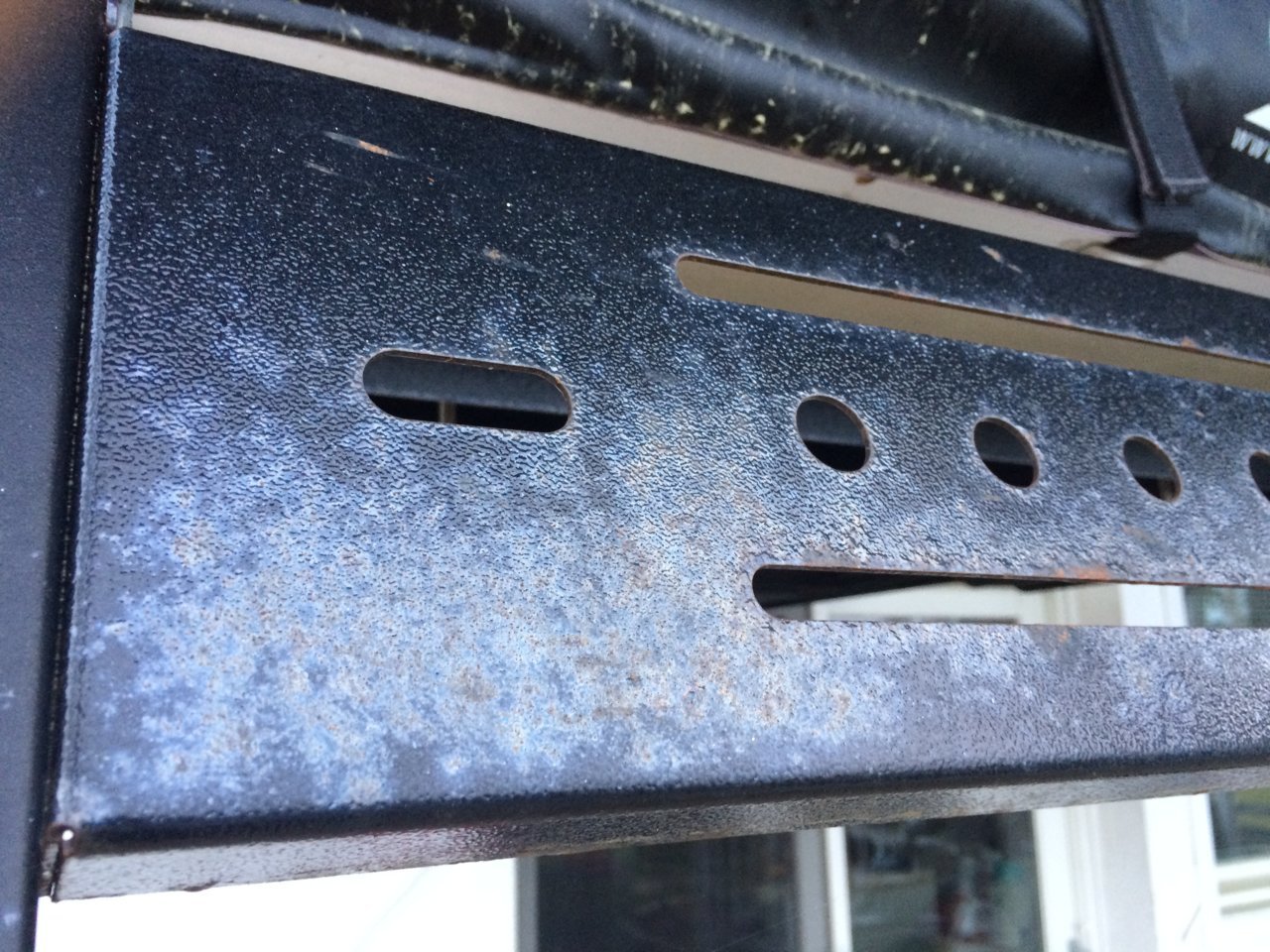

    There appears to be a couple of instances with the crossbars:

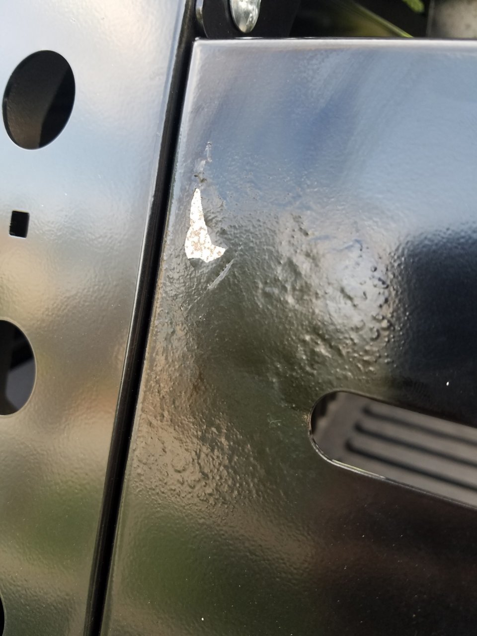

    This is what I was referring to. The coat was literally sprayed so thin it rusted clear through the coat. I have personally done powder coating for 8 years. This was due to insufficient coat thickness when sprayed. And it was well before the 'bad batch'
    Powder coating can definitely have the potential to be extremely durable. Take brake calipers for example, find me a pair of brembo brakes that have the powder coating coming off in 4 months of minor exposure. Again, if done CORRECTLY it has the potential to stand up. But even so, have a look at these pictures, this was 4 months with no more than a weeks full exposure to sunlight and an occasional rain, the rest was storage in a shed. Coming from someone who has personally done powder coating, this is absolutely unacceptable.
    Offering a Non coated version would be a simple alternative option that I am surprised they do not do, however, if they are going to offer coated final parts, they need to be able to stand behind it. Only helping some of the people who complain the most and ignoring others is just messed up.
    Again, I brought it up early on before the process and was ignored by KBvoodo. Its easy for the guys on here to defend them if they weren't the ones who got ignored or sold a bad product.
    Squeaky wheel gets the grease..... sounds like only the customers who are adamantly demanding they fix it are the ones who got help.
    What they SHOULD do, is refund everyone with coating problems the cost of the coating....

    Not a customer... but I've heard nothing in here about primer. My powder coater uses a marine grade primer on my projects first, then a good quality powder (I think they use prismatic).
    Have had lots of stuff coated over the years and the quality issues here look like thin coats, no primers, and bad prep. And Voodoo should be suing the coater for poor quality and to support the people that have bad parts. Them not owning up is ridiculous.
