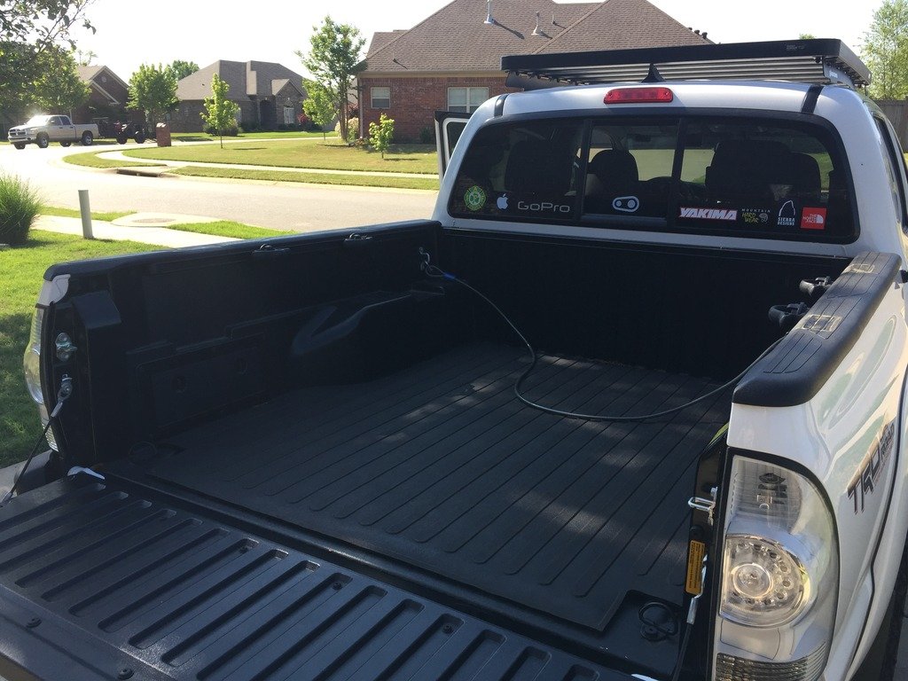

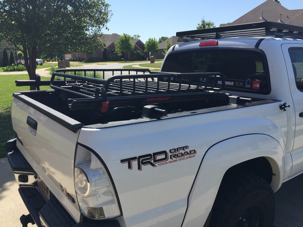

    The truck it will be installed on
    Removed my Yakima Bed Rack

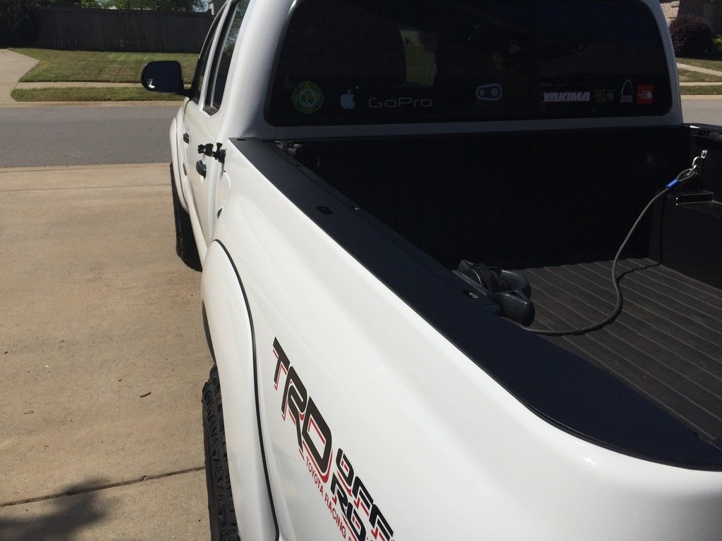

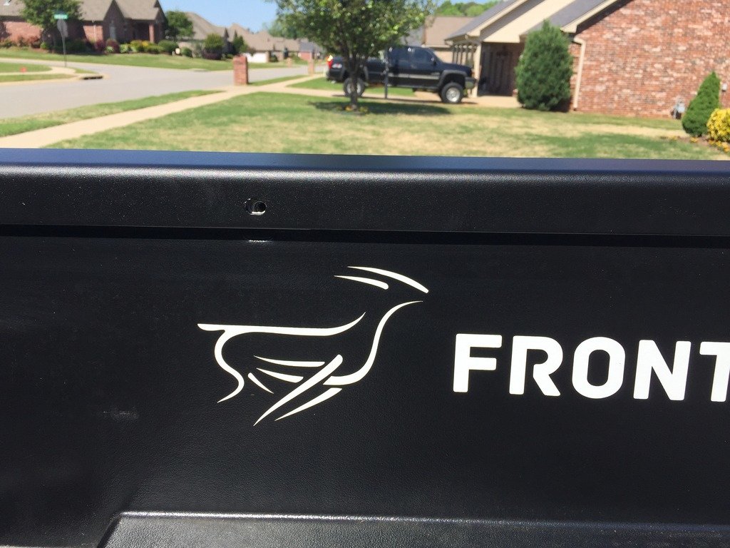

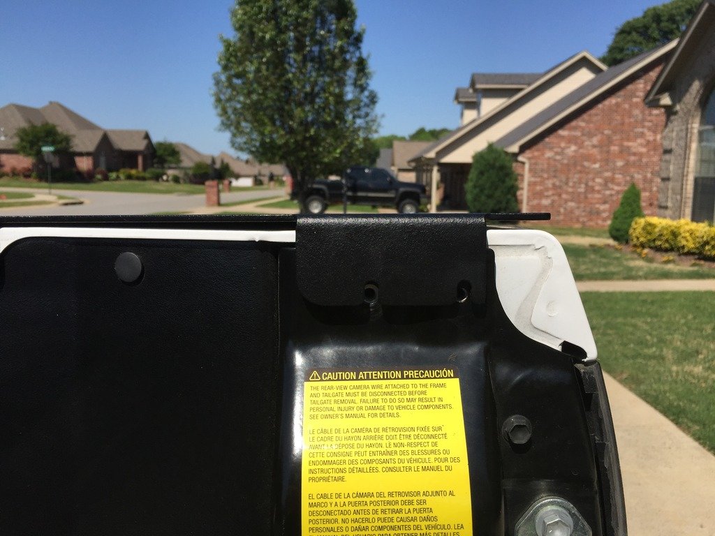

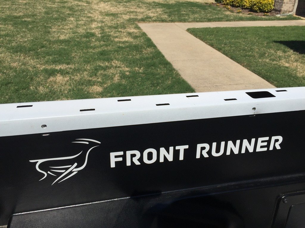

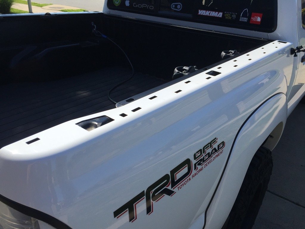

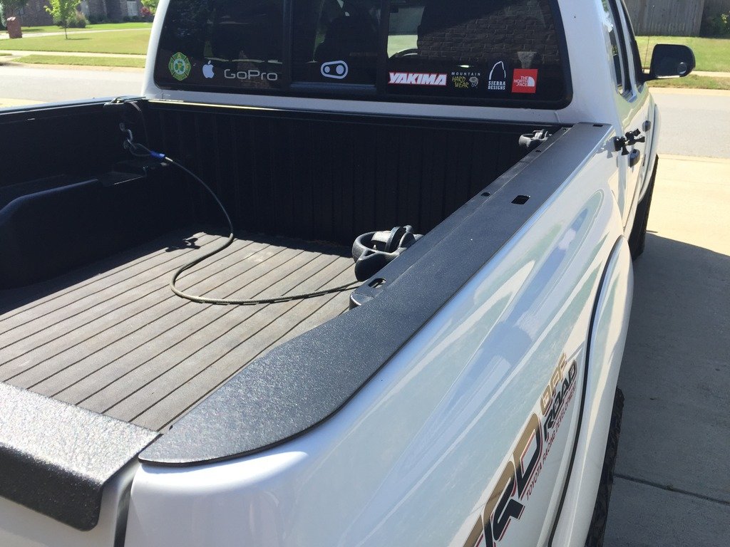

    Popped off the plastic bed rail protectors. Just start at the back and pull up. Broke a couple tabs but not really concerned since they won't be going back on. Luckily I didn't have any paint scrapes to worry about. Cleaned the top of the bed before installation.

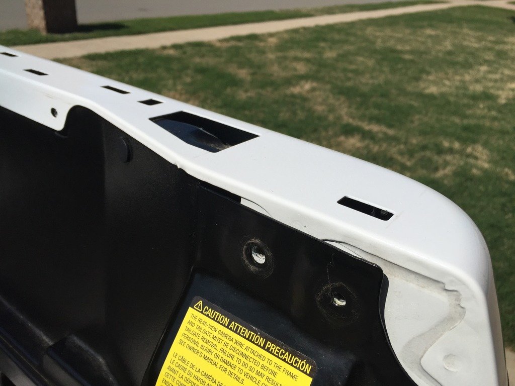

    Removed the 4 mounting bolts that hold the track in place

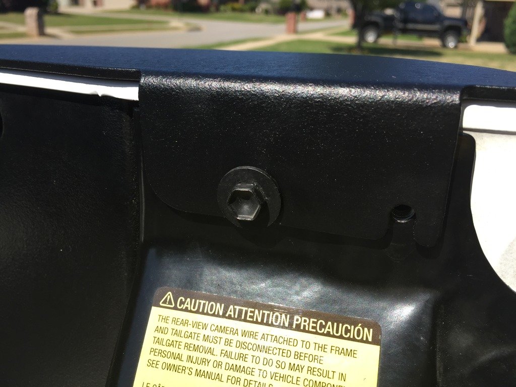

    Removed the 2 (10mm) bolts at the back of the bed
    Placed the (supplied) double sided tape in the middle of the bed rail

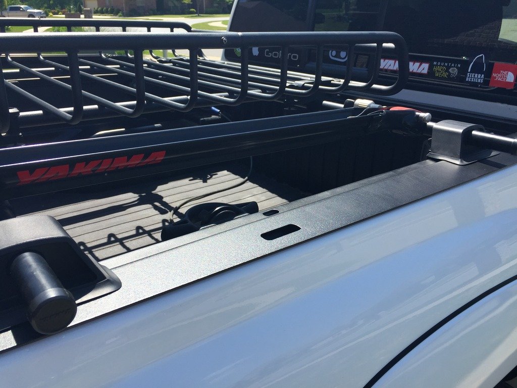

    Placed the new cap on top of the rail making sure the mounting holes lined up
    This is the important part. Make sure you push down on the back of the rack while tightening the 2 (10mm) bolts as it will make the rail flush with the bed

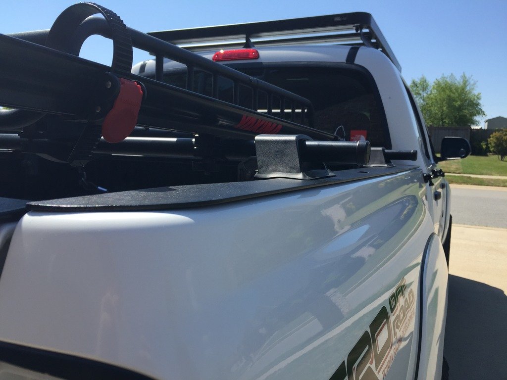

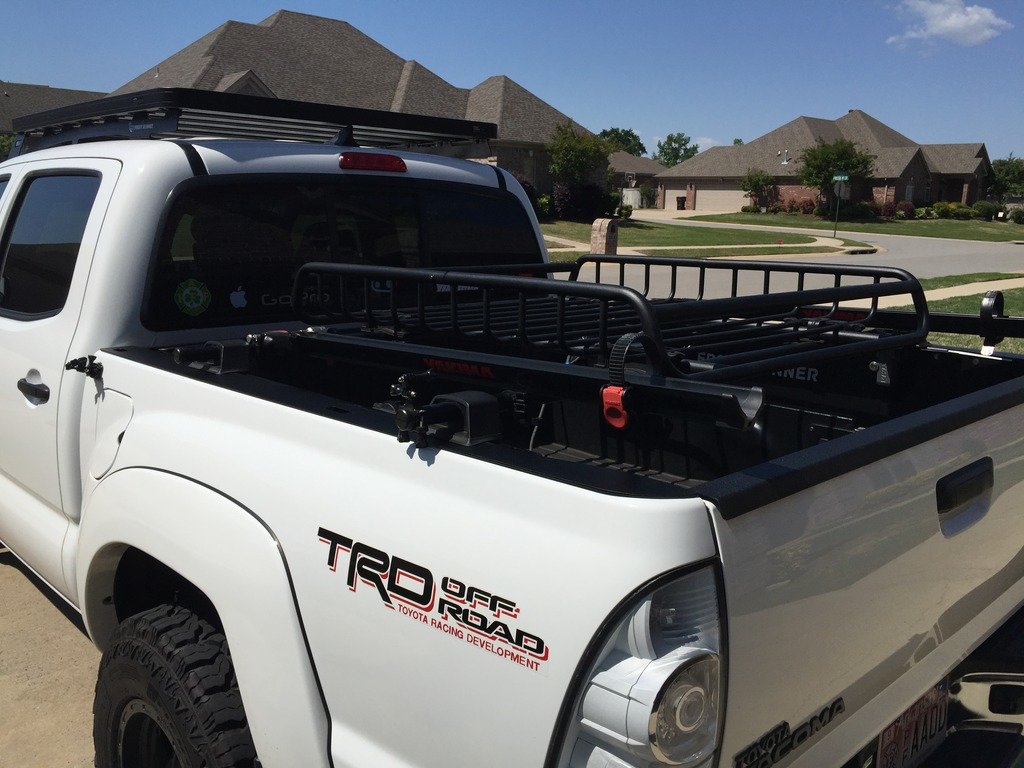

    Remount the tracks and stand back and admire your work. Total install time was less than a hour and that was with me making some adjustments to my Yakima Rack.

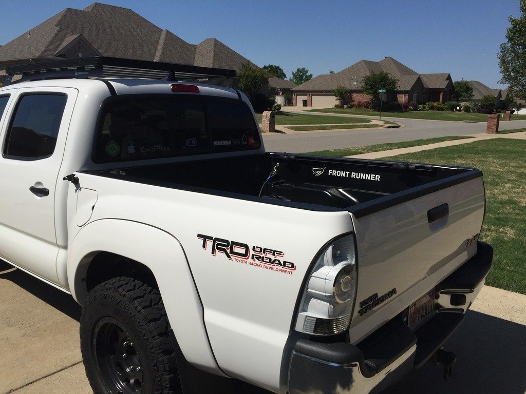

    Yakima bed rack installed on the new bed rails
    Thanks again Chad for a quality product!
