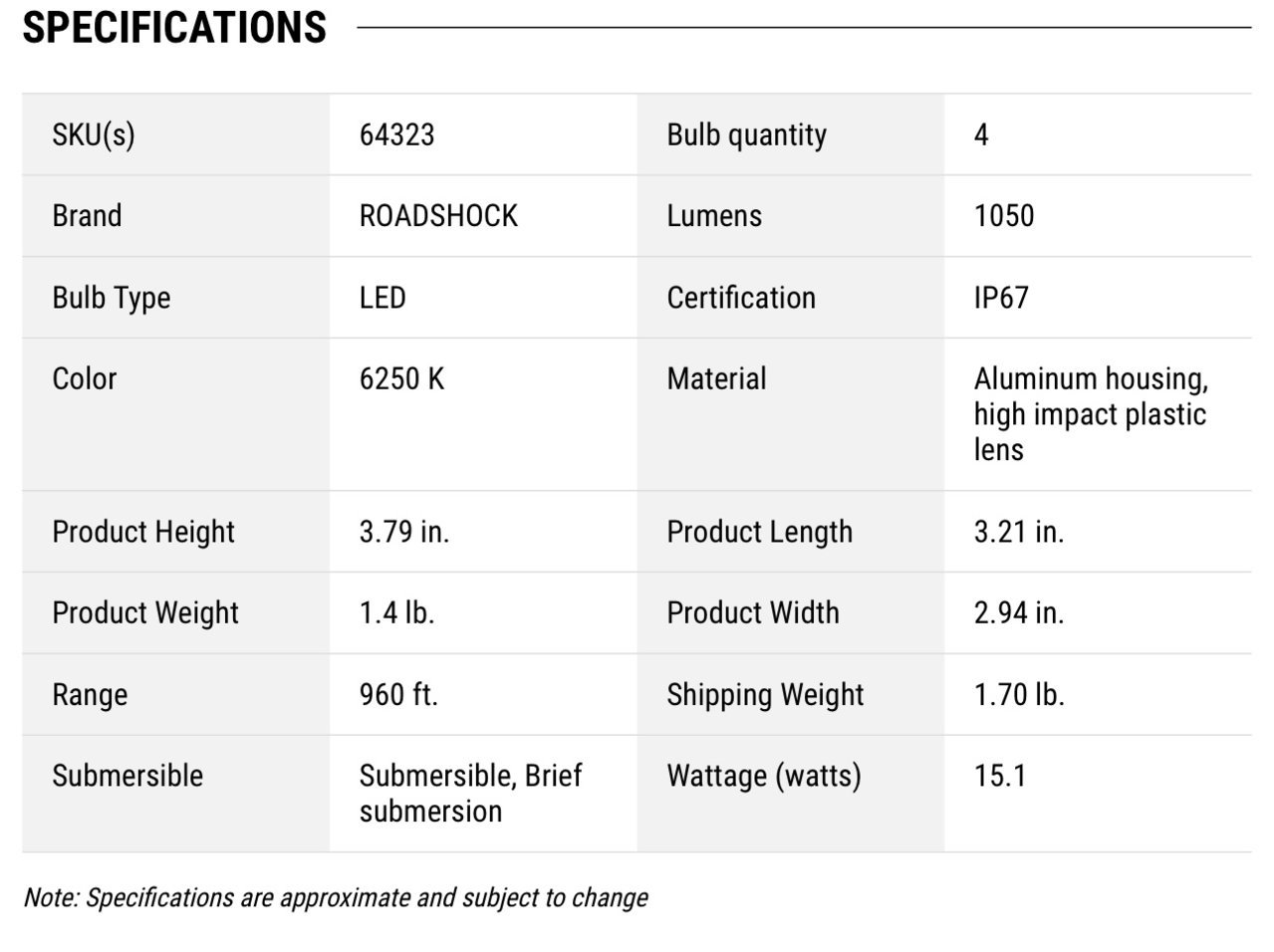

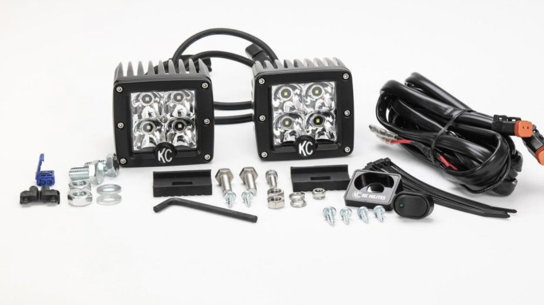

    So I am looking at getting some lights for my sport bar on my truck. Looking to run probably five 3” cube spot lights.

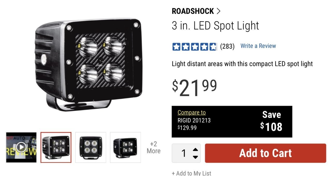

    i was pretty set on the KC c series, but was in harbor freight the other day getting some miscellaneous tools and happened to run into the harbor freight Roadshock brand. Looking at the specs, they’re really not that different, and they are significantly cheaper than the KC lights!
    by chance does anyone have either of these, or possibly even better and have had both at some point and can comment on how they compare to each other?

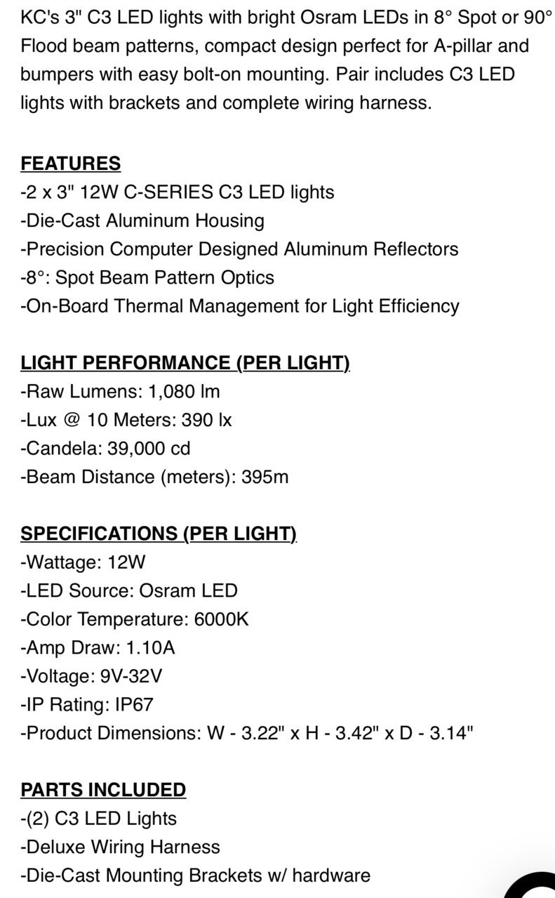

    so from the specs, the KC lights throw about 335ft farther, are 30 lumens brighter, and use 12w per light instead of 15w per light. So while they are indeed better, the Roadshock is $22 per light and the KC is $185 for two, or essentially $92 per light. So with a $70 price difference, I feel like the Roadshock really holds its own versus the KC.
    Another difference is of course design feature. The KCs are more chrome in the middle with black housings, and the Roadshock are more black in the middle.
    Regardless, just curious on what you guys think.
    thanks for your input!

    Are you wanting lighting shooting down far away or are you okay with something with not as much distance? and or patterns wider / smaller? They both look like a SPOT pattern.
    Aside from the chrome / black internals colors. The KC looks to have the reflectors covering as much real estate in the housing for more cast of light. The HF looks like it will cast a small spot using smaller reflectors.

    Those HF units look pretty poor. Smaller reflectors are not going to perform as well as larger ones. By those published specs the KC units will throw light an entire football field plus further than the HF units. I wouldn't put a lot of faith into the HF lighting specs being accurate. That said those KC lights are not anything special either and overpriced IMO. The KC C3 pods are made in China, they are not up to par on quality or performance vs most the KC main product line and carry a greatly reduced warranty. If you were looking at spending that much on pods, I'd go with the Diode Dynamics SS3 Sports, only $15 more than the KCs at retail and absolutely no comparison in performance. The SS3s will make it look like those other lights are not even on in terms of output intensity comparisons. And with the 20% off sale at Hotshot Offroad on Diode Dynamics good till 1/5, the SS3s will actually be cheaper than the KCs. I'd suggest contacting @memario1214 (Hotshot Offroad) to get hooked up with real quality lights at a great price.

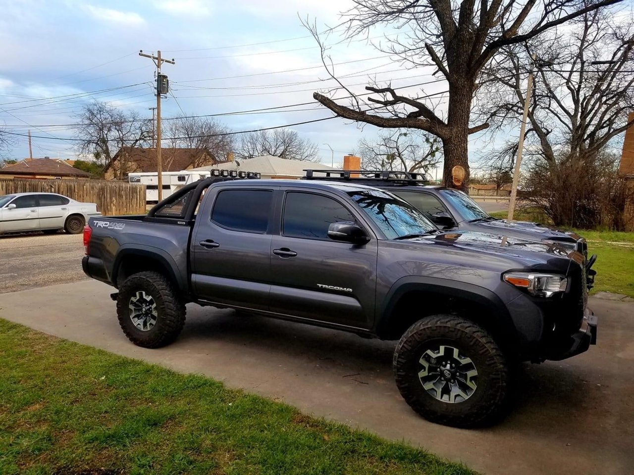

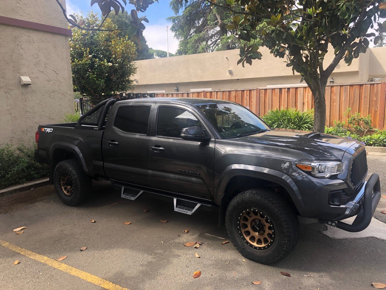

    0ABC7359-C859-4819-A47D-20FDA3B3C70F.jpg FD69F097-58F9-4E3D-9ACA-B4B8C5F0C36C.jpg

    Oh... are you planning on mounting small 3" pods on a rear cab bar? That is a terrible configuration for lights that small. You'll get no light on the roadway ahead of you, basic geometry of light being obstructed by the cab. And if you use crap lights, you are barely going to be able to tell they are on, aside from lighting tree tops above you maybe. They will provide virtually no usable visual functionality. For rear cab mount lights like that, I'd look at something in a much larger form factor to be useful, even going to inexpensive halogens like Hella 500s would be vastly better. If you are sticking with 3" pods in that location you might as well buy whatever is the cheapest thing possible since they really won't work there at all anyway.
