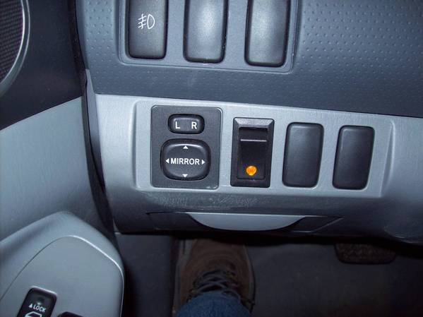

  5. Mar 20, 2009 at 4:40 PM
    jrobson
    jrobson Well-Known Member
    Jan 4, 2009
    #12211
    1,091
    Mobile, Alabama
    09 DC 4x4
    Ultimate lift kit, LR UCA's, Bi-xenon 8000K headlights, Xenon 8000K foglites, (4) KC slimlites on N-Fab light bar, Extang trifecta toneau cover
    A buddy of mine used factory switches like the ones in the newer generation tacos. After about an hour the one night he smelled burning plastic. Turned out the switch started to melt behind the dash. I don't know if this was a dealer install screw up or what, but when I just had mine rigged up I just used the switches that came with the KC slim lights. Looks a little different, but I think it looks fine.

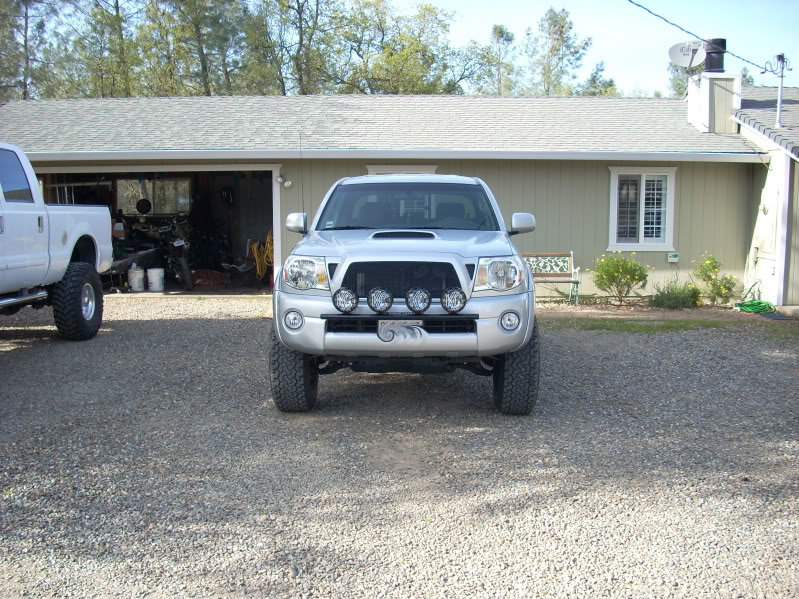

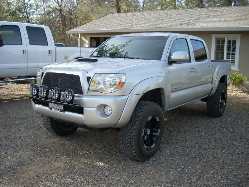

  15. Mar 25, 2009 at 4:59 PM
    Stillfly199
    Stillfly199 [OP] ( . )( . )
    Feb 26, 2009
    #14098
    5,002
    J.D.
    Bro Capital of the word
    2010 FJ Cruiser
    Here you go, they arent hooked up cuz I have a class at 530
