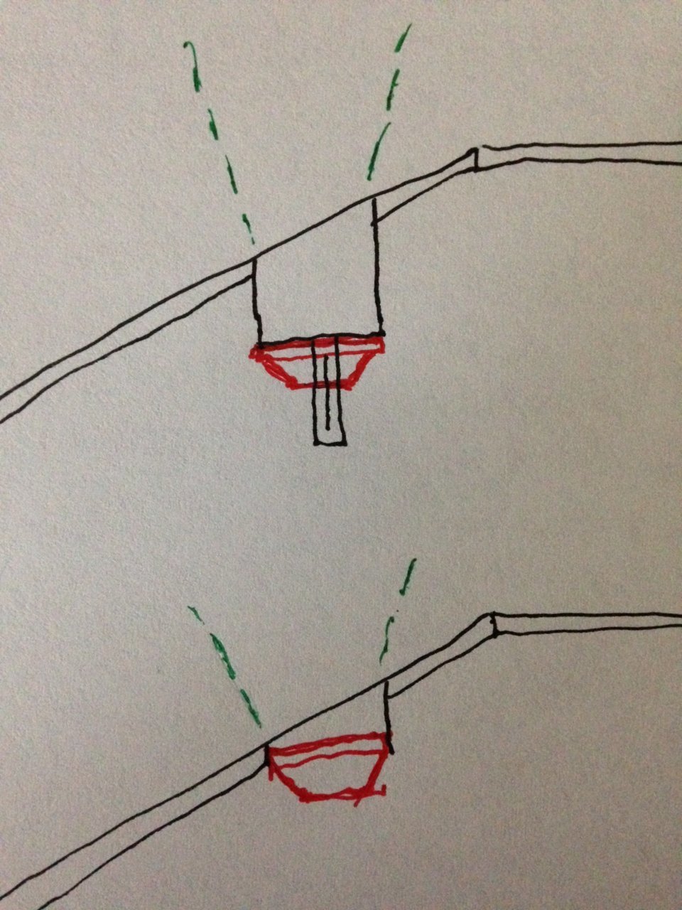

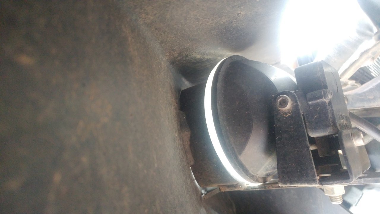

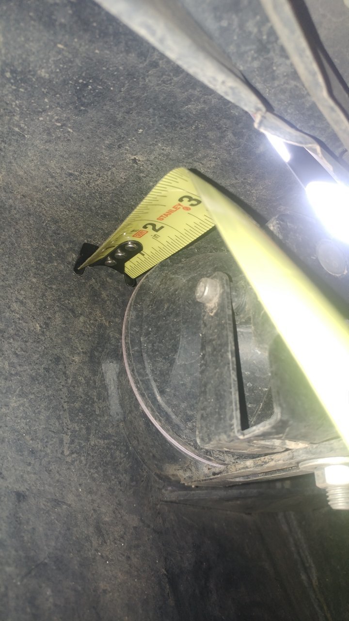

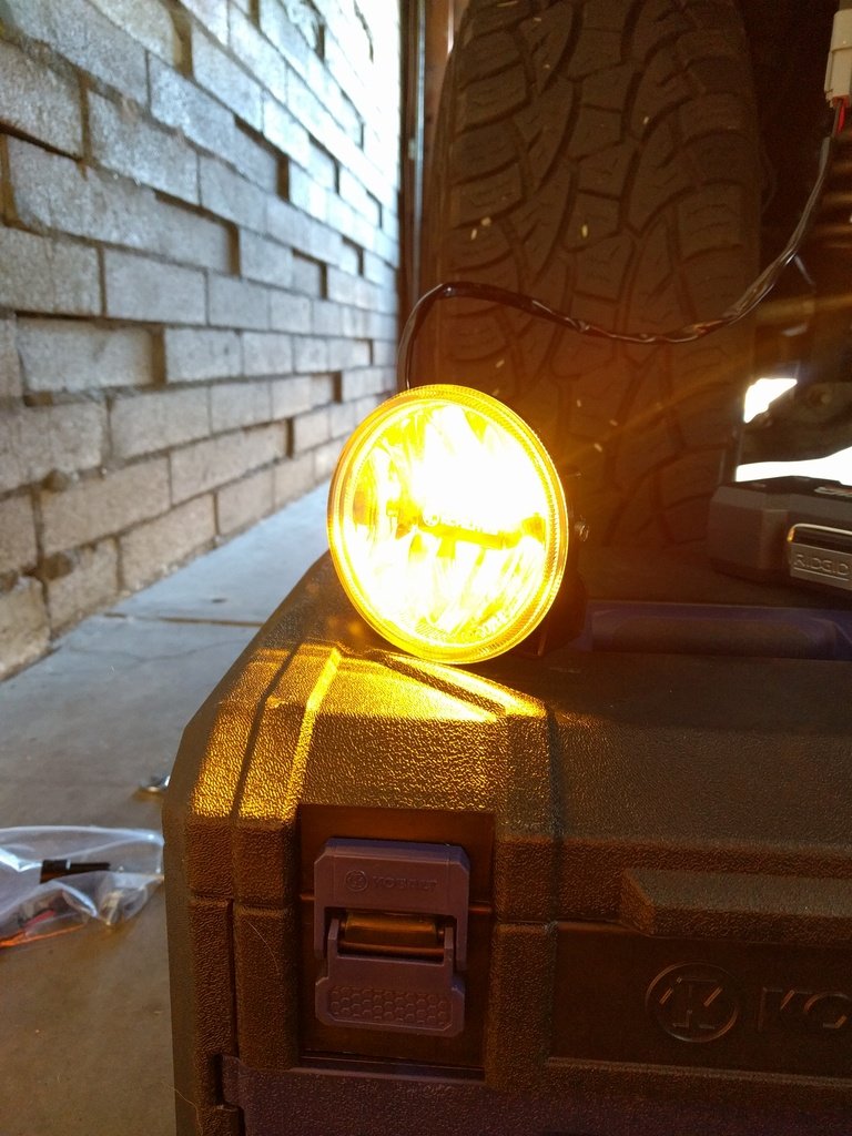

    So from the outer edges, there's about an inch that you could gain if you were to trim them down a little bit. However, the limiting factor may actually be at the top of the lights. That section of bumper right above it is downward sloping, so you may need to bend the light mount bracket on the bumper lower (or if you're going to just cut it off and reweld it on which would be easiest, then account for that) in order to move it forward as much as possible.
    Either way, I think you can easily lose an inch in mounting depth. If I were better at welding/had the proper tools I would even attempt this myself.

    Looks good. I will be ordering the bumper without powder coating so I can modify details as needed.

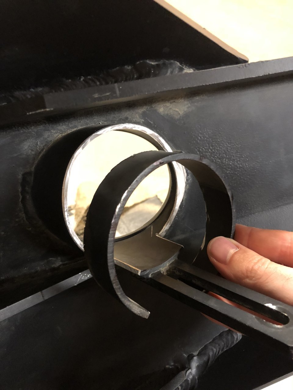

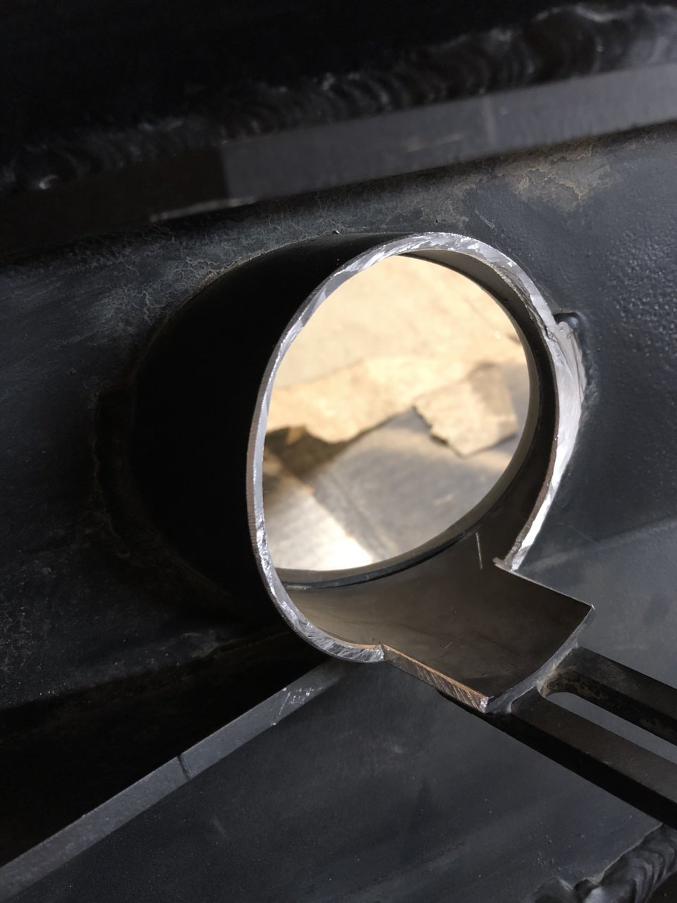

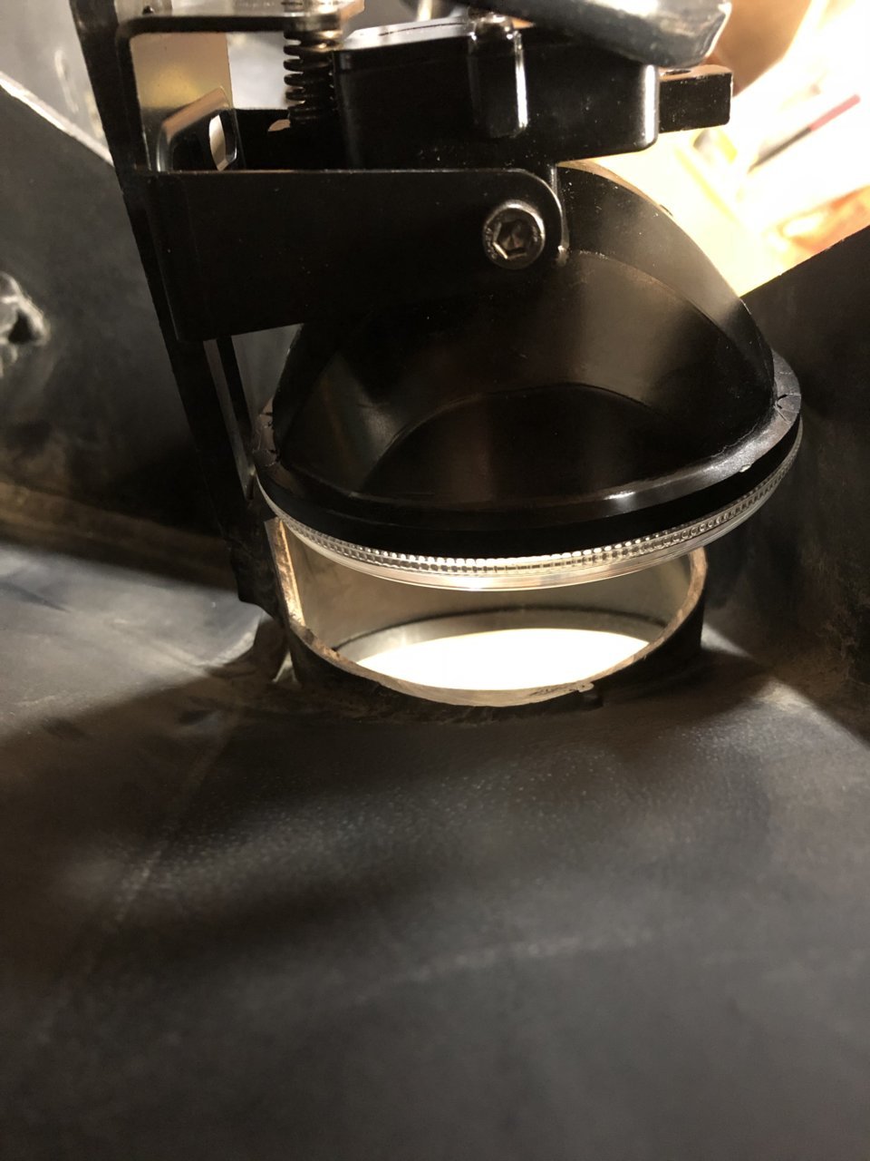

    So I got super lucky and picked up a Pelfreybilt used locally!!
    Now working on get fog lights mounted farther forward. Rough cut on one side done. Using a battery powered dremel...:annoyed:10minutes of cutting hours of charging.

    Dang!! Looks great so far, although I bet that's a massive pain using a battery Dremel. Keep us updated on how this goes! If you think it is worthwhile when it is all said and done, I may be doing this to my bumper in the future.
