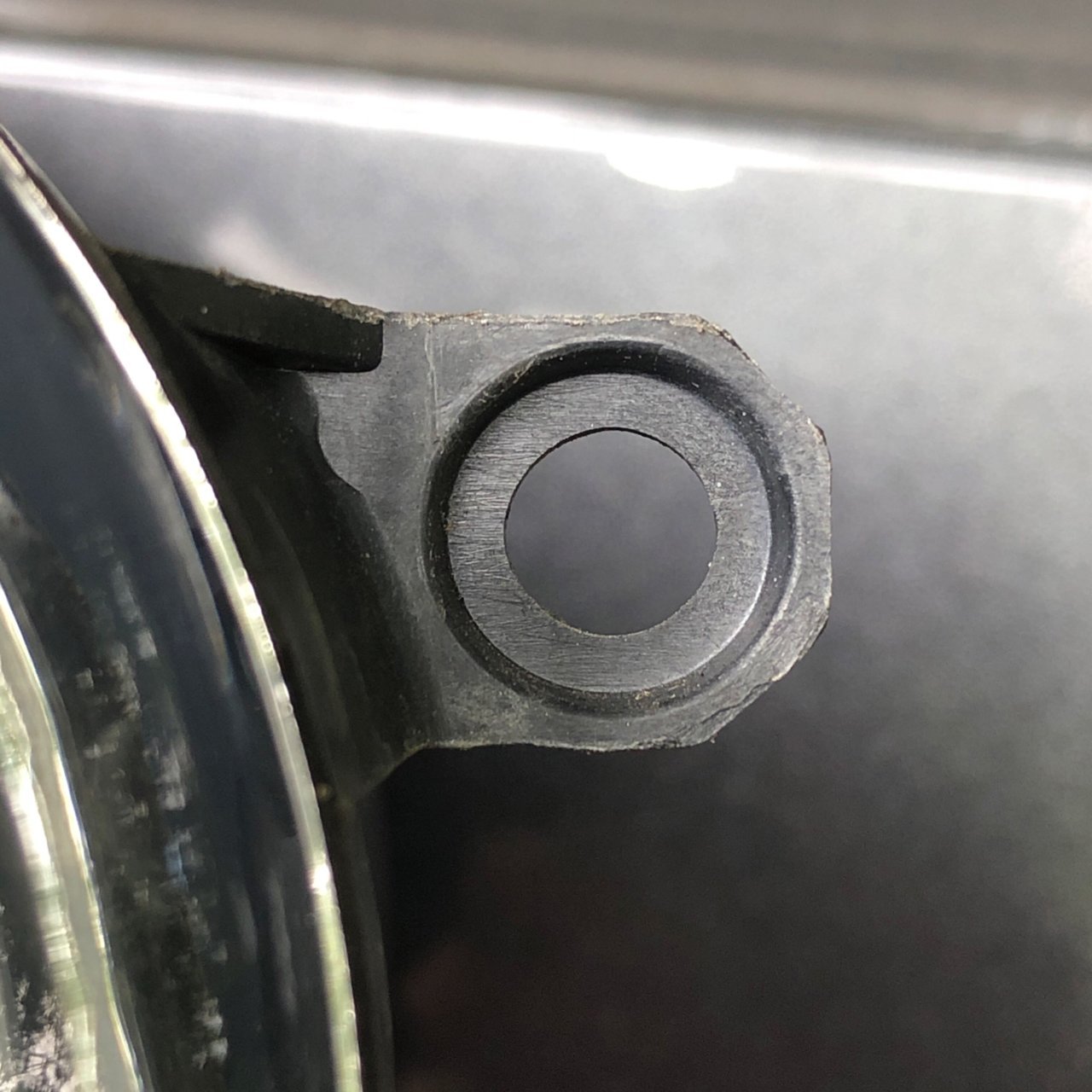

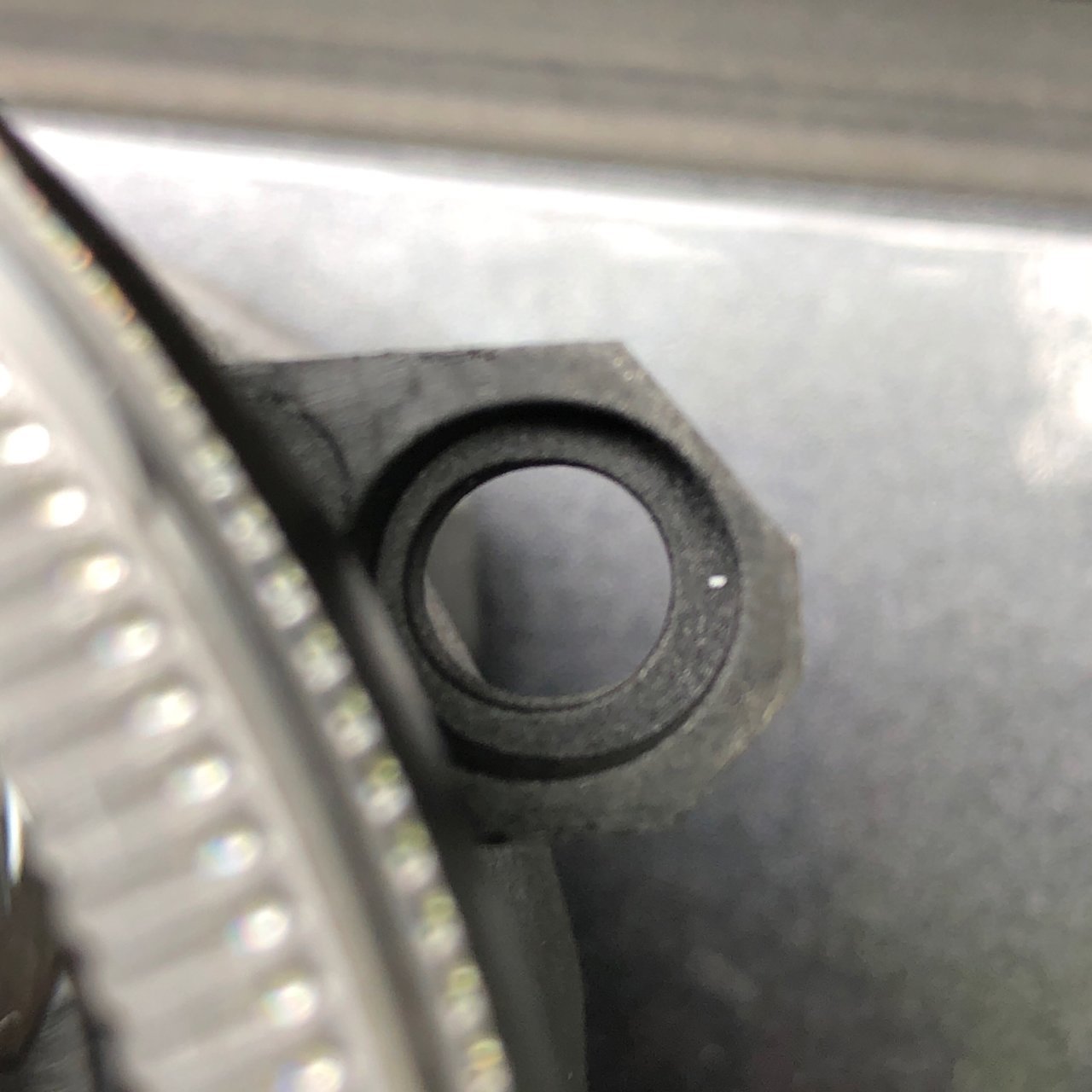

    I just attempted to install the Gravity 501’s in my stock 2017 bumper and the two bracket ends on the side will not seat completely. They appear to have three angled sides on the end as opposed to the stock lights rounded ones. And the other bracket end in the opposite side, the one the screw goes through to secure, does not have the appropriately sized recess to snug up against the factory bracket. Also, the oem fog lens housing is actually angled that compensates for the way it is mounted in the bumper, the KC light is symmetrical and flat, so when it sits in the bumper it aims 30-40 degrees to the sides. Everything I read said these were plug and play and easy to install, but these are not fitting correctly at all. Anyone have the same problems or any suggestions to remedy?

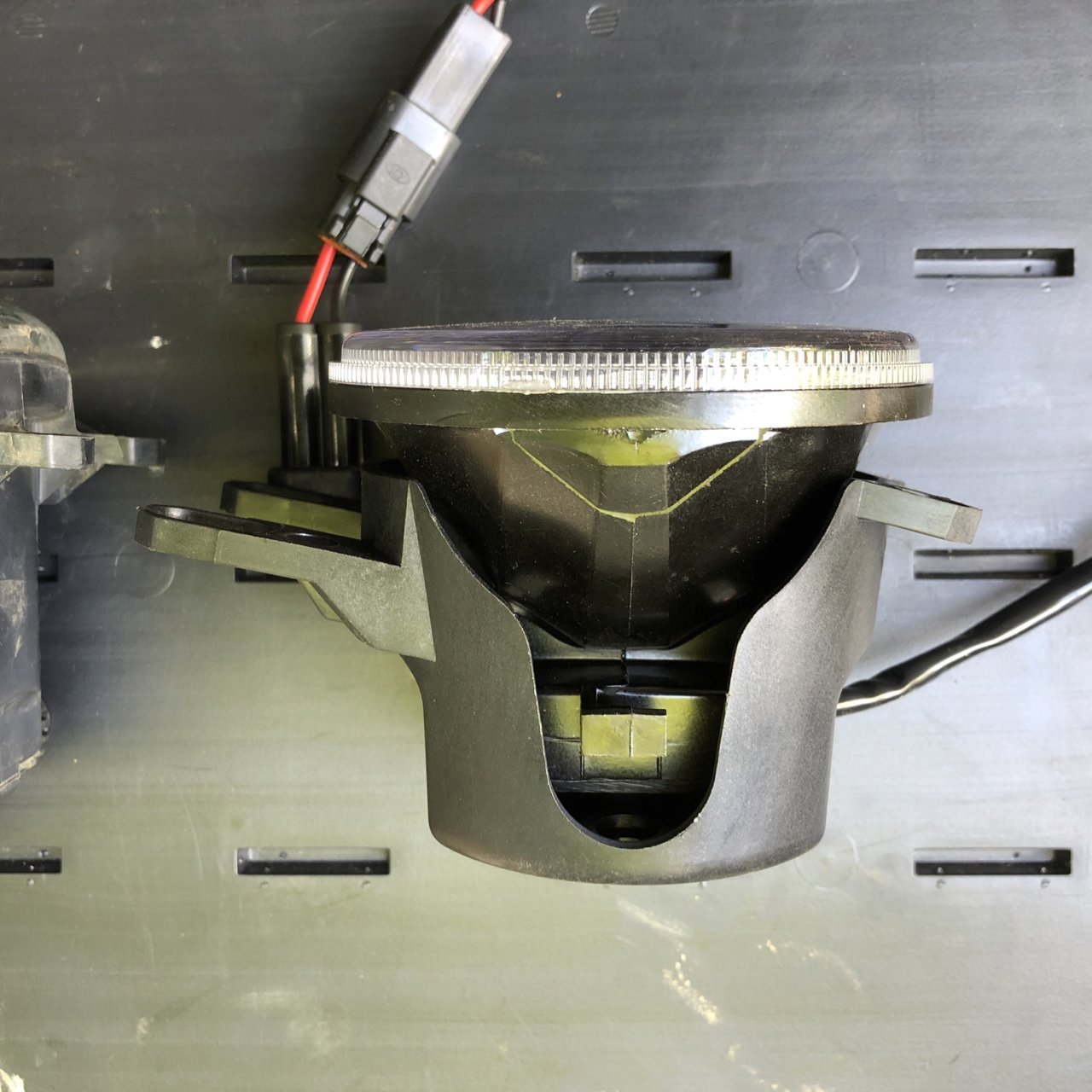

    Comparison between new and old. KCs on the drivers side. OEM on passenger.

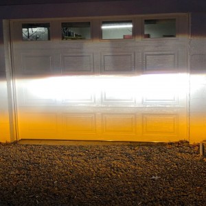

    Light beam after install and aiming.

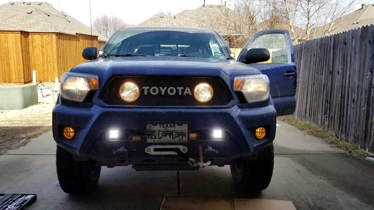

    Installed mine this morning along with a few other wiring/lighting projects.
