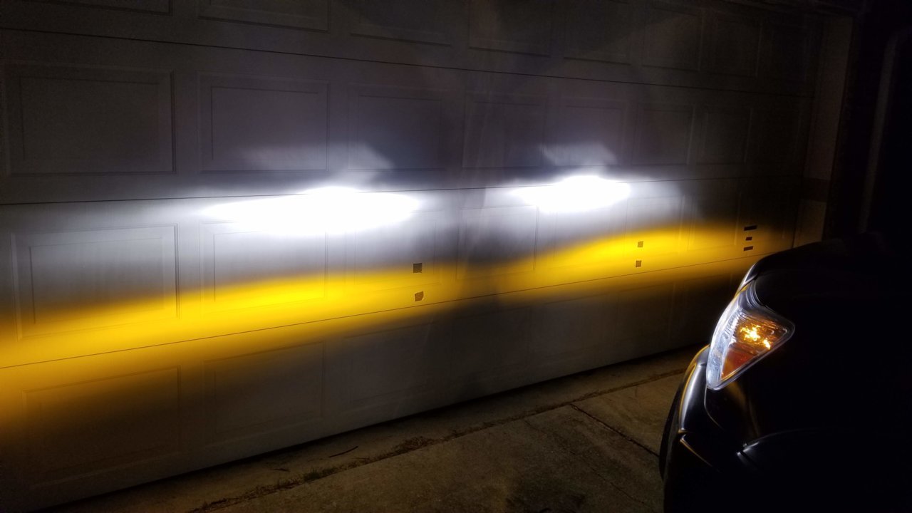

    A night shot of my amber G4 up against my garage. Looks like I need to adjust both inward some, especially the passenger side. Agreed?

    You really can't aim the KC's left or right and the pattern you have is very normal. Remember, fog pattern lights are designed to illuminate a short distance out in front and a good distance out to the sides.

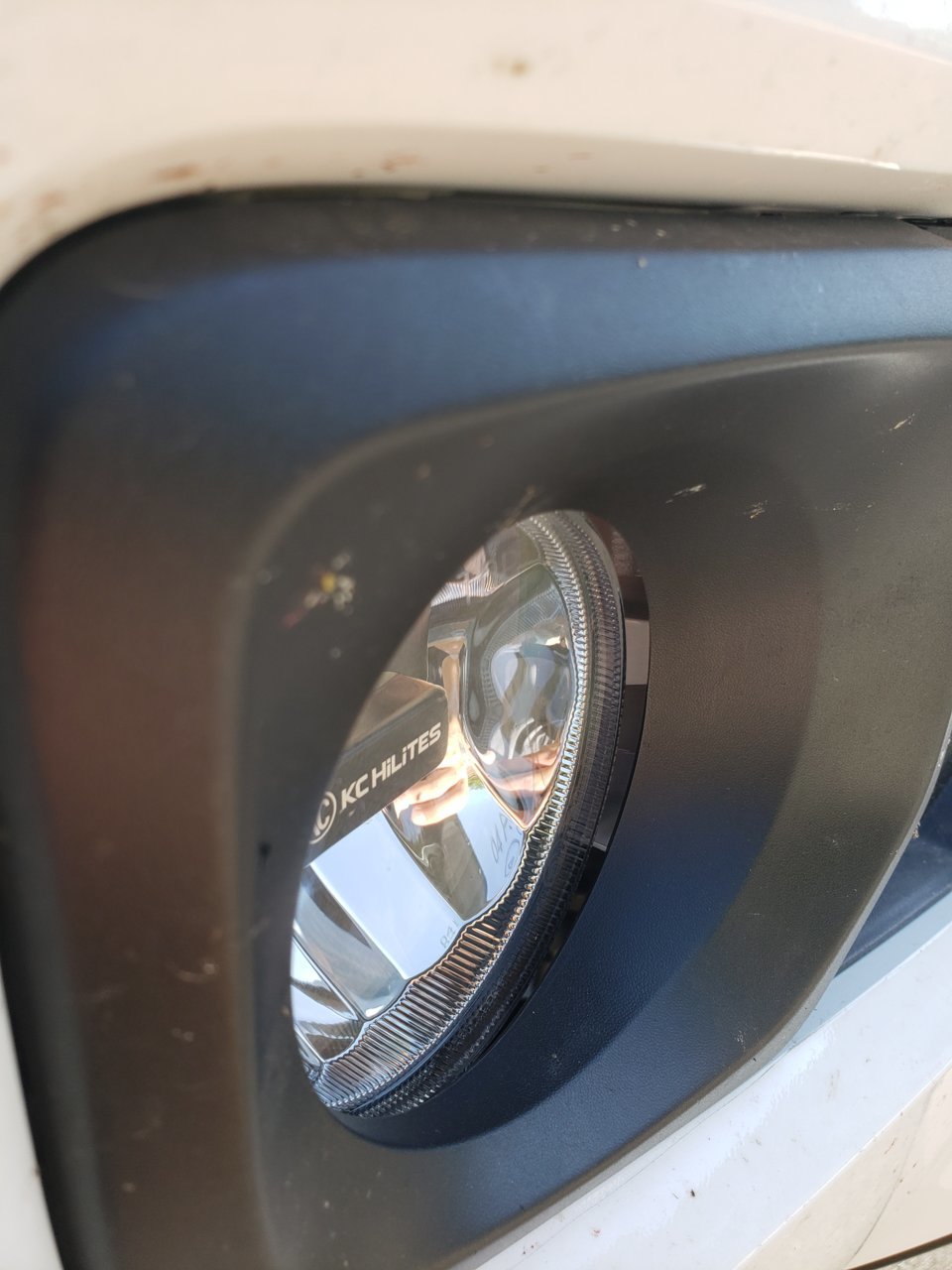

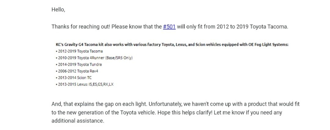

    Hey guys just installed these in amber on a 2020 TRD off road and there's a good sized gap on each. Looks like the original housings are slanted and the kc's are not. I reached out to kc and they said the 2020 fog lights are different. Is this true? I thought 2016-2020 fog lights were unchanged.

    Can you provide a picture? To my understanding the 2020 fogs are unchanged, they just discontinued the high output H11 TRD model fog and switched all trucks to the low output h16 model fog which has been offered since 2016.

    Here you go. Not a huge deal but I really thought these were going to fit perfect since the fog light housings are all the same besides the pro trim to my knowledge

    Now my truck is a 2015, but when I had them there was minor gapping, not to the same extent as yours. Does it feel like the fogs are interfering on anything on the mount to prevent them sitting closer? Edit, also funny question but are you sure you installed the fogs on the correct sides? The tab inserts have screw holes, I don’t recall if it was possible to install them backward.

    I don't believe so. It seems they can only fit one way and that's by securing the two tabs into the tacoma plastic housing and putting the screw in on the other side which is what I did. I thought I had installed them on the wrong side as well but I tried switching them and there was still a gap. It seems to me that unless there is a bracket or something, there is no way a flat fog light will fit in an angled housing. It just seems like nobody else in this thread mentioned anything so I felt I was doing something wrong. And then the lady from KC tells me this.

    Well it cannot sit flush because then it cannot be adjusted for aiming, so there needs to be some gap. I haven’t pulled apart a 2020, but I’d be surprised if Toyota changed the fog mount from 2019 when little else on the front changed. They did change the fog offering though so it is a possibility. It would be interesting to see if the H16 OEM fog part number is a carry over from the 2019 year, or if it is a new unique fog part number indicating the possibility the mount changed.

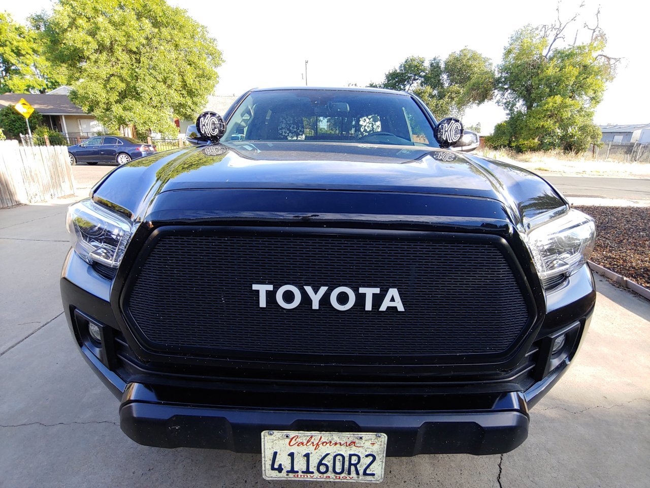

    I think I have the same grill. How much light does it block from your pods behind there and what mounting hardware did you use? Looks awesome.20200615_190204.jpg

    Looks like you have the wide/narrow slit style mesh? I think that blocks like 60%, at one point I found a website that listed the mesh ratios. I had mine custom done with an extra fine/small mesh to reduce how much light was blocked. It's still noticeable, which is why I've rebuilt it with a 100w bulb and heavier wiring.
