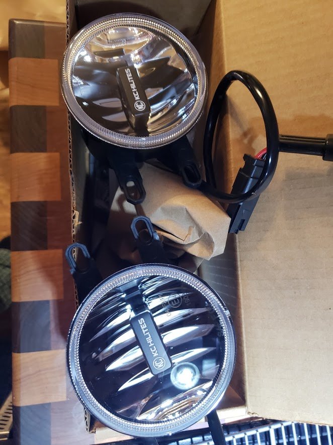

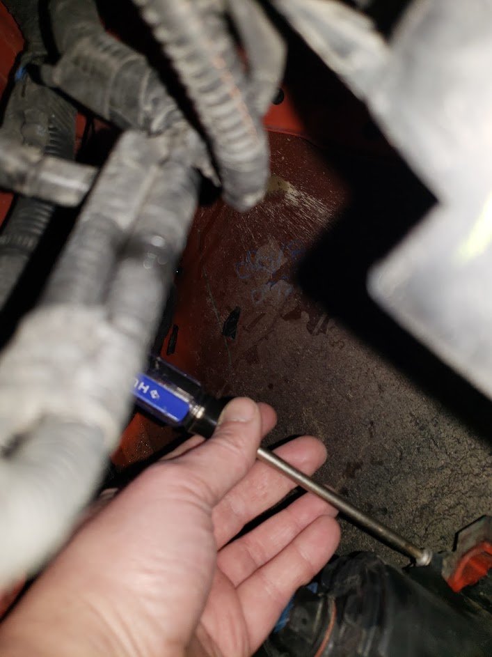

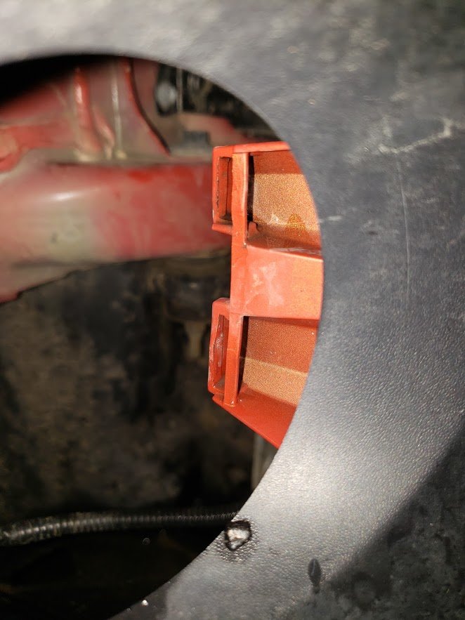

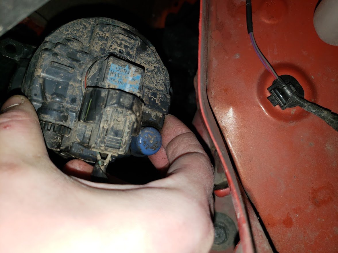

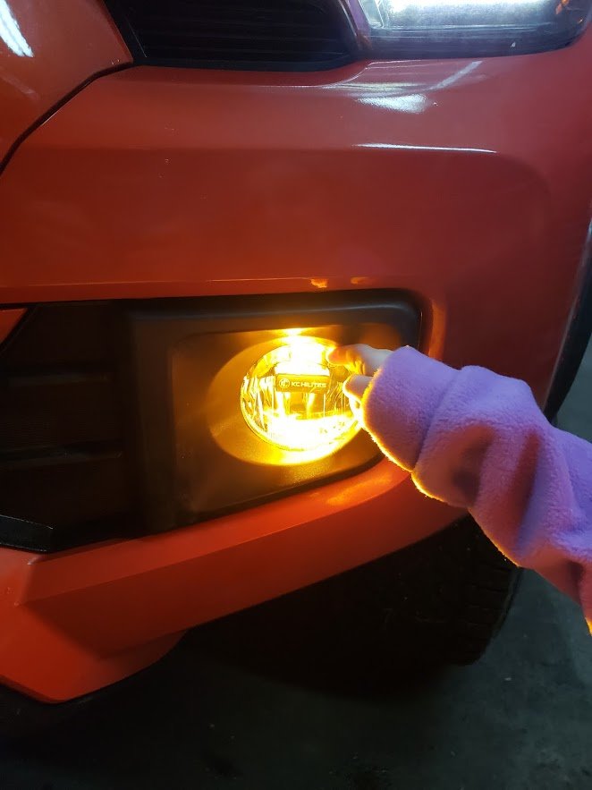

    They showed up today (after a UPS "out for delivery" tease on Saturday). Install was very easy, its literally one screw and pulling the wiring harness plug (the other side of the fog just sits in slots). It was easier to remove the screw first, then pull the harness plug. I'd also recommend a stubby screwdriver; I couldn't find mine, but a regular/shorter one still worked just fine. I went in from the hood... seems like a tight spot at first, but was plenty enough room to get the job done. Even got lucky and didn't need to adjust them, they're sitting just below my headlight cut off as is. Will post a night shot eventually... at the moment, it's 33f and pouring rain out, lol.
