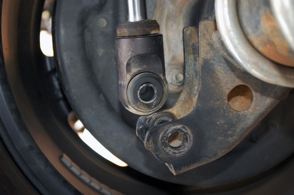

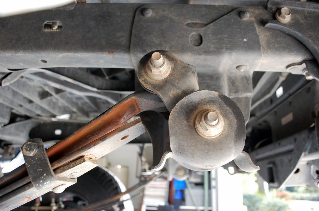

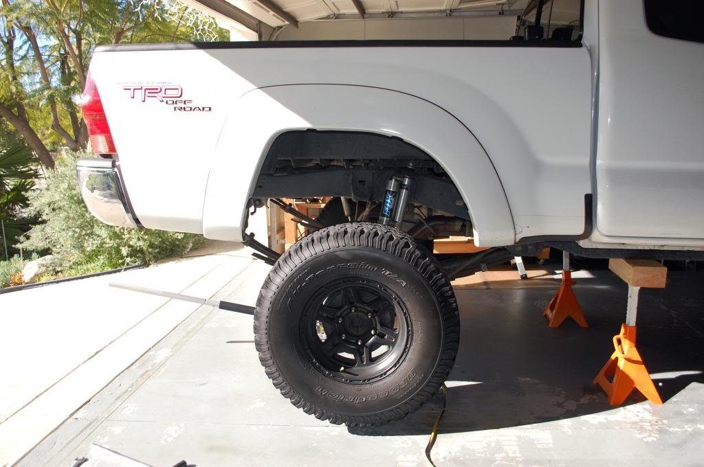

  18. Dec 11, 2012 at 2:23 PM
    #58
    Bobber Bill
    Bobber Bill Well-Known Member
    Oct 3, 2011
    #64554
    1,226
    Los Angeles, CA
    Half-Ass Prerunner Daily Driver
    400hp 6 gears
    I snapped some pics of the droop I'm getting with my AP 3" leafs.
    The leafs definitely are being limited by my shocks even though Downsouth Motorsports says they are the right shocks.
    All these pictures were taken at static droop with a full leaf pack.
    Here's the shackle position: Lots of room still
    I can easily get another 2-3 inches more droop than this picture just by pushing down on my axle.
    I didn't have the time to take leafs out to cycle uptravel, but just the droop alone could safely use another 2" of extra shock travel - probably 4" total.
    14" strapped with SOA AP leafs?
  19. Dec 11, 2012 at 2:44 PM
    #59
    anthony250f
    anthony250f Well-Known Member
    Feb 18, 2012
    #73066
    11,902
    Anthony
    San Diego, CA
    2008 dcsb trd offroad 4wd
    Damn will more travel than me haha
  20. Dec 11, 2012 at 2:54 PM
    #60
    Bobber Bill
    Oct 3, 2011
    #64554
    1,226
    Los Angeles, CA
    400hp 6 gears
    How is that possible? Don't you have SUA LT?
