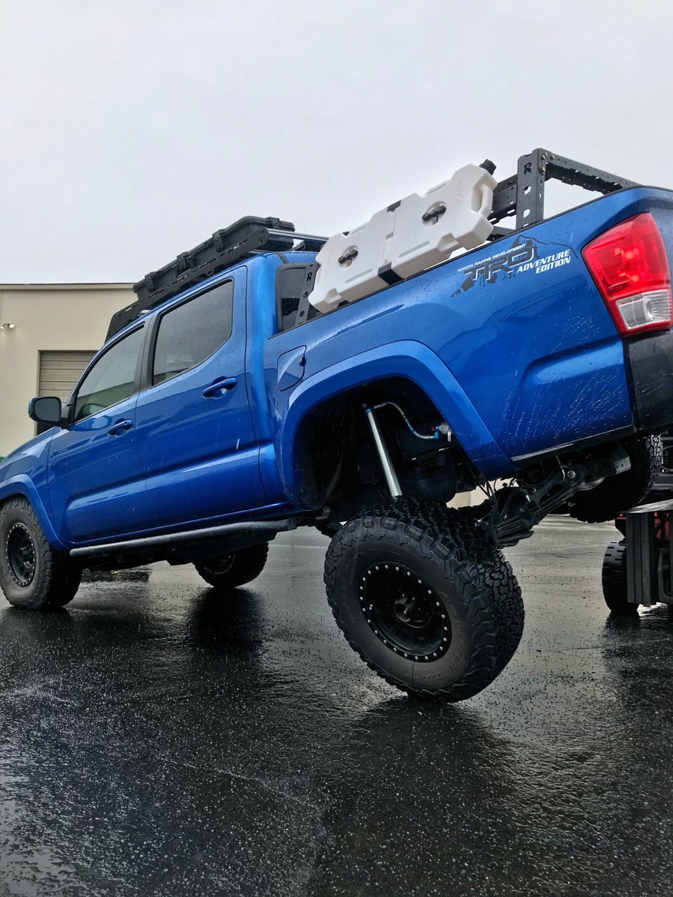

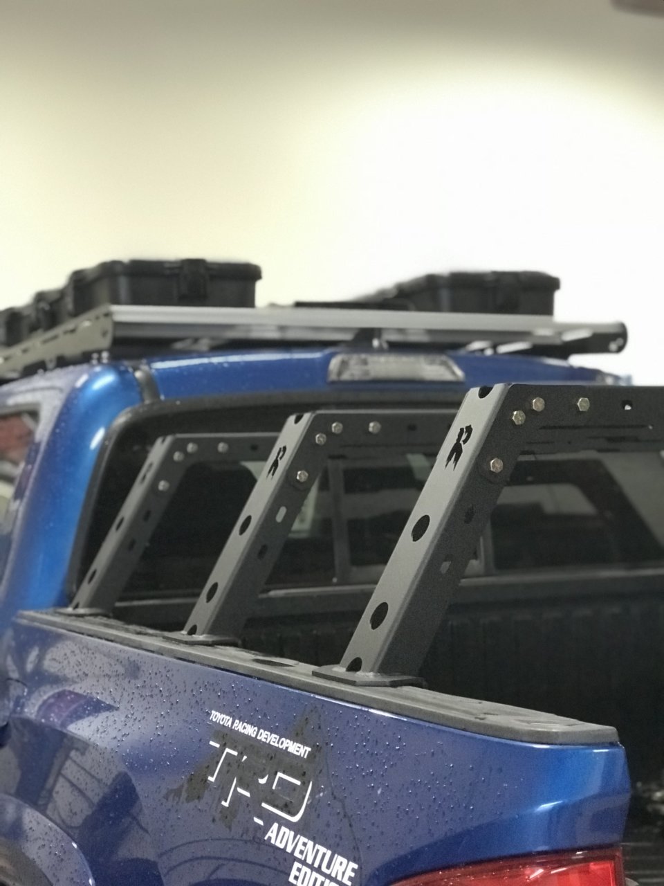

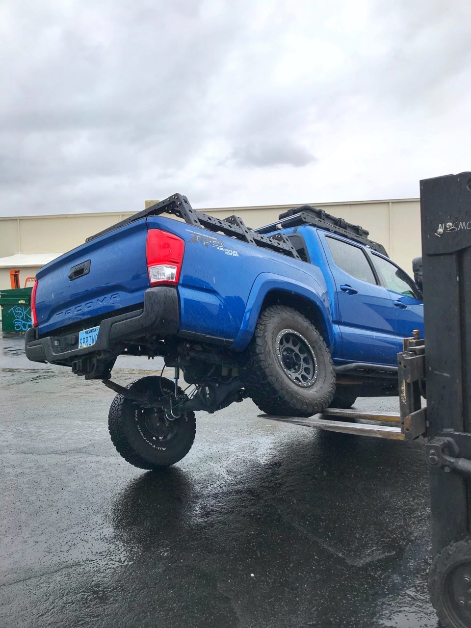

    @RelentlessFab bed rack installed and I love it. So pumped to not have the tent on the cab next trip. Also had a little forklift fun and figured out I need bigger bump stops or change my axle mount and to get my wheel spacers on. 25” off the ground so I can’t complain!

    Nice. Is that with the Dakars or did you replace them?

    Yep heavy duty Dakar’s!

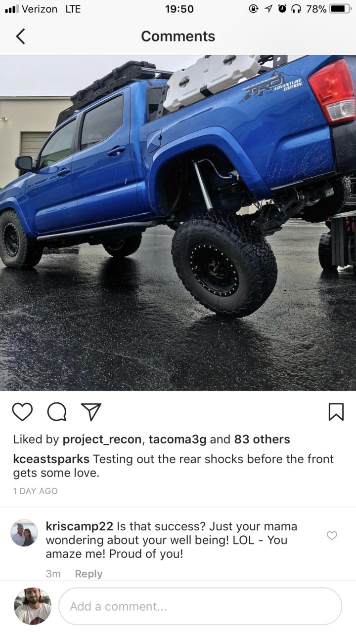

    Mom will never understand :rofl:

    My mom did the same with one of my last pics flexed out. She thought it was broke lol

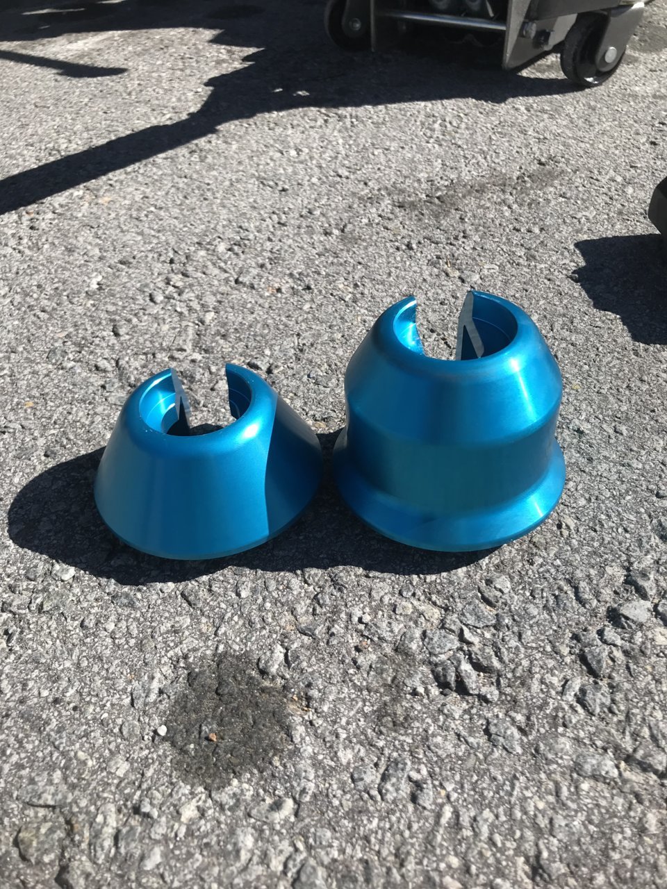

    Syke! Wrong lower perch :bananadead:

    I wonder why King has been sending out LT sets with wrong lower spring perches. This is the second one I've seen.
    I ordered mine recently, so hopefully I don't have this dilemma.

    Yeah I’m not really sure how that can happen. But it’s hopefully a simple fix, downtime just sucks.

    Got back into town last night and had a package from Downsouth with the correct spring seats/perches/whatever you want to call them. Also went to dump my old gear oil and noticed I forgot to replace the washer like an idiot in my mad rush to get the truck back onto the ground. Luckily I have plenty of gear oil and Brandon at Dolan parts hooked me up with some spares last time I was in so that’ll be an easy fix but a waste of $40 in gear oil :annoyed: I jacked the truck up this morning and packed off the preload all the way to the top of the coilover but the spring was still tight so I went and rented a little Autozone spring compressor. I was able to barely fit it in between the springs but I got it to compress enough to swap lower seats. There is a huge size difference. Left is the LT seat and right is the OEM/MT seat. Huge thanks to @RelentlessFab for pointing it out and taking pictures of @Project Recon ’s truck at 9 PM to confirm they were wrong. And for stopping by on Saturday to say what’s up and give some pointers :thumbsup:
