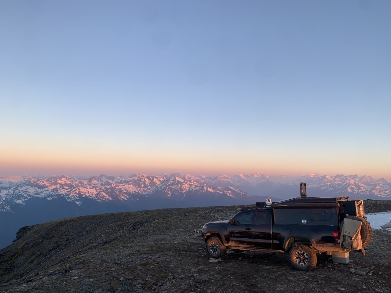

    Well after a couple thousand Kms since tuning our 2016 with 6MT I feel confident in giving my review.
    Bumpers front and back, full skids and sliders, canopy and sleeping platform. Sitting right at GVRW when loaded.
    Reason for tuning was the added weight has had obvious effects on drivability. Struggling to pull hills through the mountains, slow acceleration, etc etc.
    Tune has improved all aspects, if you’re on the fence, pull the trigger. You won’t regret it.
    Photo taken at 8600’ on the top of Canoe Mountain. An hour long ascent in 4low.
