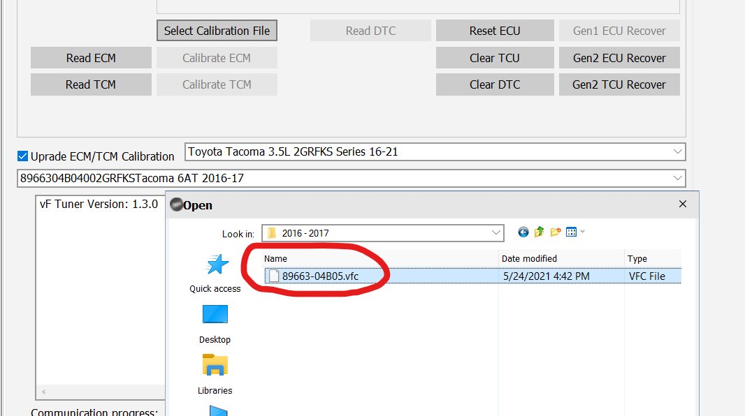

    Soooo, I've got a buddy still on 04B03, he has VFTuner and now can update to 1.3.0 with ECU update support. Figured lets get him on 04B04 - but check it out. The program directory has 04B05 instead, I didn't even know that existed yet personally.
    Any plans to update KDMax 6.0 for 04B05? If he flashes to that, I assume the current 04B04 tune file would not work at all or break something. Seems it doesn't read .CUW files that the ECU update thread has to put it on 04B04 for the current tune. Odd.
    Wasn't finding much info on 04B05. Or if VFTuner can update to 04B04 with the correct file perhaps?

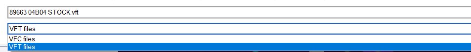

    You could just use techstream and update to 04b04.
    I haven't had anyone ask for 04b05.
    04b04 is what I run and it is solid! My truck runs great.
    If it were me, I would use the CUW for 04b04, then get the tune for that from me.
    Solution-The 04b04 is a vft file. You are looking at the vfc files. There should be a dropdown box to select vft files.

    Yep, I just checked. You just need to select vft instead of vfc. to get to the 04b04 file.
    Simple fix.
