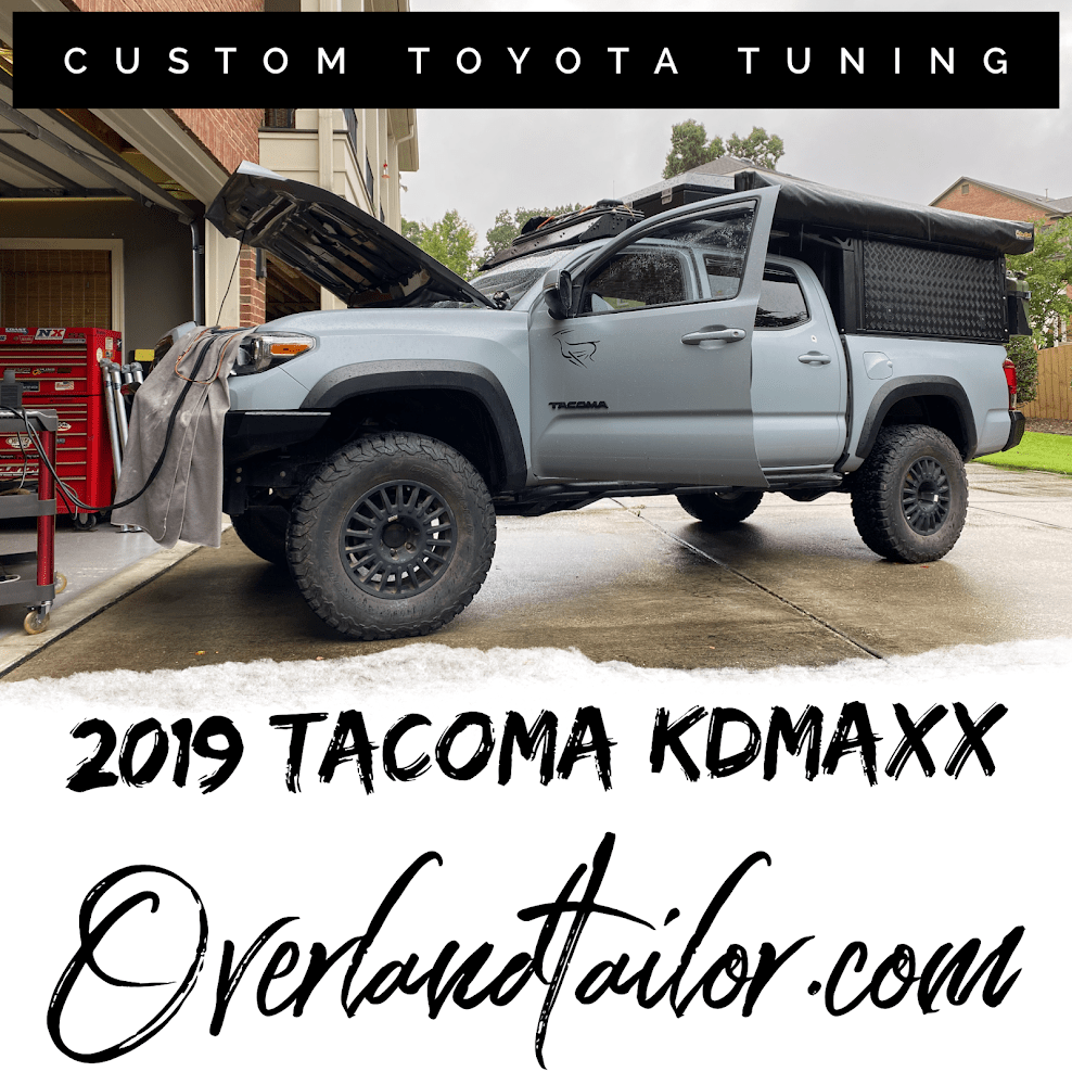

    This 2019 Tacoma was in for the KDMAXX Performance Tune.
    Beautiful Truck, but a heavy setup. The client complained of bad shifting and all around sluggishness.
    After the Updated TSB and Tune, the client was very pleased with the results.
    From Daily Driver to Heavy Overlander, Overland Tailor can transform your truck to fit your needs.
    Give us a call to see what we can do for your late model Tacoma and Tundra.

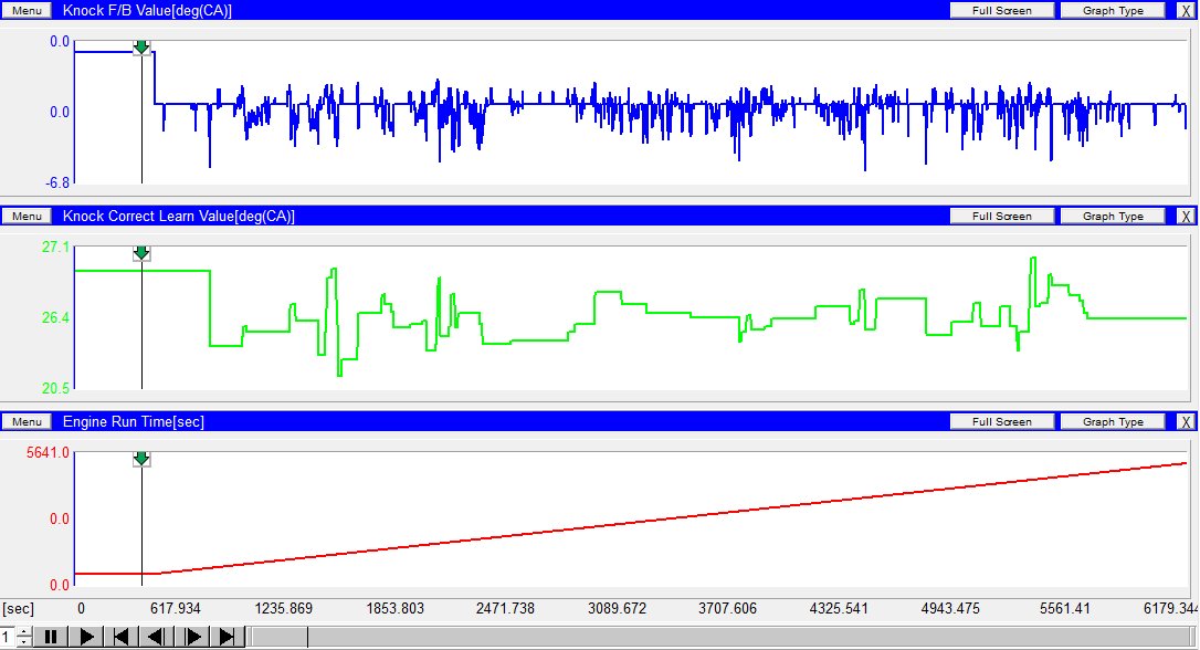

    I know that the regular fuel KDMax tune will learn up to 90 octane and advance timing accordingly. How does it do this and how long does it take? Is there something that can be done to accelerate this learning such as a couple of full throttle runs?
  12. Aug 23, 2021 at 8:09 AM
    #2632
    Vlady
    Vlady Well-Known Member
    Dec 20, 2017
    #238986
    4,710
    Issy, WA
    2017 White SR5 DCSB V6 4x4
    The octane learning is based on monitoring Knock feedback and "learning" stars within 5 minutes of your drive and never stops.
    The ignition is being retarded if KFB starts diving below -3.5. The "learning" can be seen in action if you drive in 6th between 1700-2000 RPMs, where KCLV can swing by 5 or more points in 3-5 minutes
    TRDSlow[QUOTED] and TWTaco like this.

    You may get a slight increase, but it really depends on your driving, the terrain and the configuration.
    In my case, I have kclv of max 23.4 on 87 tables with 92 octane and max 24.5 on premium tables on 92.
    This is a small data, but there is 1 point gain.
    Need to factor in the cost of premium gas and availability

    I've read that higher mileage engines might have a bit of carbon build up in the injectors that could impact the kclv learning. One recommendation I read was to run some sort of injector cleaner first.
    What I'm wondering is how much of an issue is this and is there a way to know without pulling things apart if we need to do this or even if this is the right thing to do? For example, is having a low kclv before the tune indicative of a potential problem? I'm at around 60k miles and have mostly used top tier gas but 85 as that's the norm in Colorado unless you buy premium.

    Not necessarily. I remember the stock kclv was between 14-17. But here is summer 2019 (July) Ovt post 1.5 "exclusive" testing version Premium gas (no octane learning bs that we got on 2.0) on 1.5 hours drive I-5 north from home to Anacortes ferry dock.
