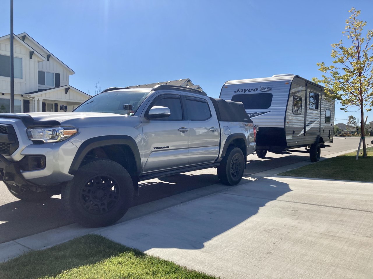

    after a long awaited weekend to take the trailer, I finally got to tow with the KD Max tune. I am using the second tip in option down from the max ( I think).
    It drove very well. On the way home I did have my TC oil hit 230 degrees in 3rd gear going up a large long grade (on OBD Fusion it is hitting “0” when temps climb). If someone could figure out how to make TC lock (switch to “1” in OBD fusion) when in 3rd with ECT after climbing for a bit it could really help keep temps down to around 210 or less I think. Someone help me gauge my theory.
    Not sure if this is possible for ECT and ECT+S only…that’s where it matters…it was a good time though.
