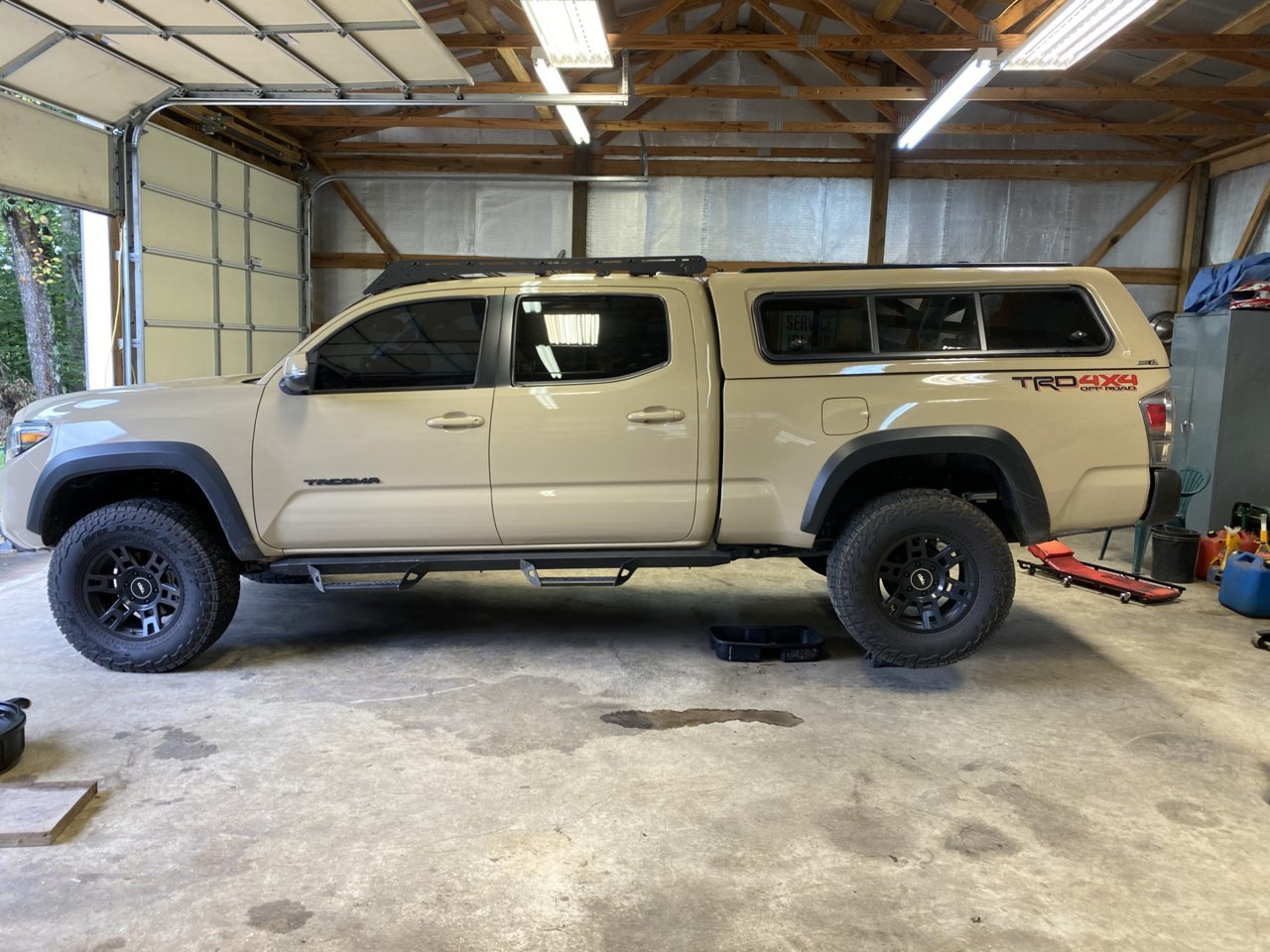

    Had @NickJacq23 tune my 2020 DCLB this pst weekend.
    After 4.88 gear swap and the KDMAX tune the truck drives and acts like what I had hoped. Highly recommend it. I opted for the 87 tune with light throttle and very satisfied. Nick was easy to deal with and worked around my schedule. Highly recommend Nick and the tune.
    I don’t get the best MPG average around 15-16 mpg but the area of Ky I live in does not promote fuel economy. 15mile commute to work is curvy slightly hilly so it’s always off and on throttle and up and down grades. Truck was getting the same mileage before gears and tune so I figured any boost in mileage was just a plus.
