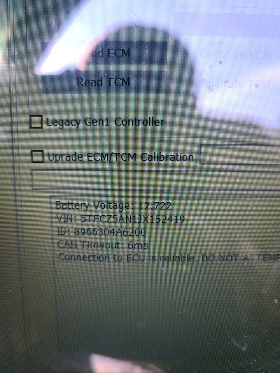

    We found a 04A62 today. It is a 2018 V6 3rd gen Tacoma. So that means that there is a new TSB update for 2018 trucks.
    This is the first truck we have seen with it, so I submitted the ECU and TCU files to OVtune/Vftuner to get it supported in the future updates.
    If you have a 2018 and want to keep your truck tuned, Do Not update to 04A62 yet. I will let you know when we get support for this ECU in Vftuner.
    As soon as it is added to VFtuner, I will make the KDMax tune for that ECU ID.
    (Just to let you know Tony @tonered)

    2016 through 2018 ATs are the only ones out in the cold. Everyone else has an update to a calibration similar to 04B33, including all of the MTs.
    04B05 is shipping with new ECUs, but a TSB or the CUW have not been released yet.

    There is a 04b05, BUT it is not a TSB update. It is only being put on replacement ECU's.
    So if you bought a new ECU for some reason for a 2016-2017 Auto transmission truck, you would get 04b05.
    So far, We have not seen 04b05 out in the wild while tuning trucks.
    I have 04b04 and I am running the KDMax tune on my truck (obviously) and I am happy with the way it is.
